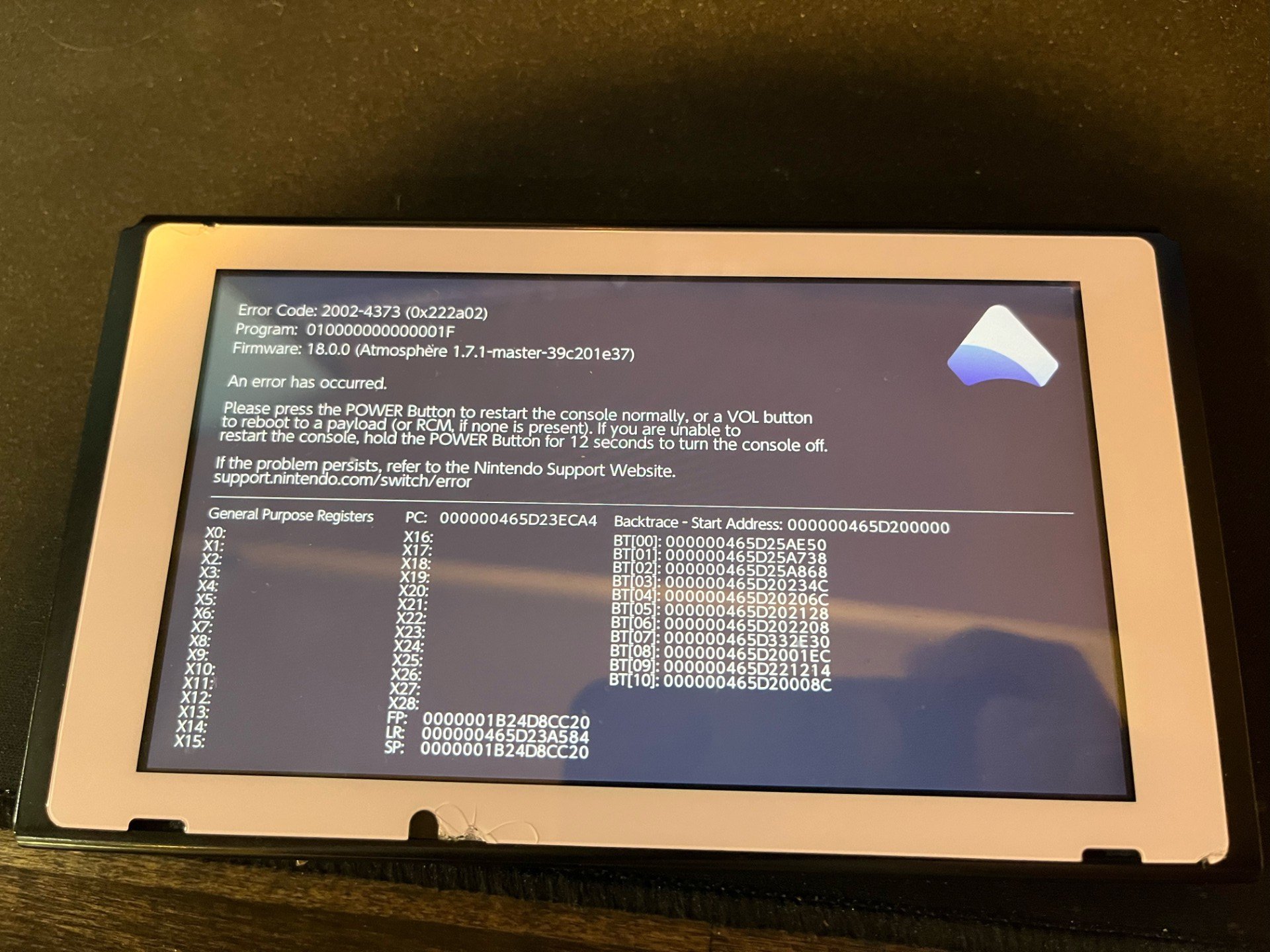

got this error randomly as I loaded a game installed using tinfoil on my mariko w switch. turning off the switch and running the payload gives the same error right after the switch logo appears. when loading into OFW it gets stuck on the switch logo. this error happened when I was running atmosphere 1.70 on firmware 18.0 and I updated atmosphere to 1.71 to try to fix it. from what I've seen on other threads this issue is a corrupted nand and the solution is to wipe it by going into the switch repair mode (by pressing both volume and power) it just stalls on the switch logo the same as if I try to boot into OFW

I changed blank_prodinfo_emummc=1 to =0 and got the same error
