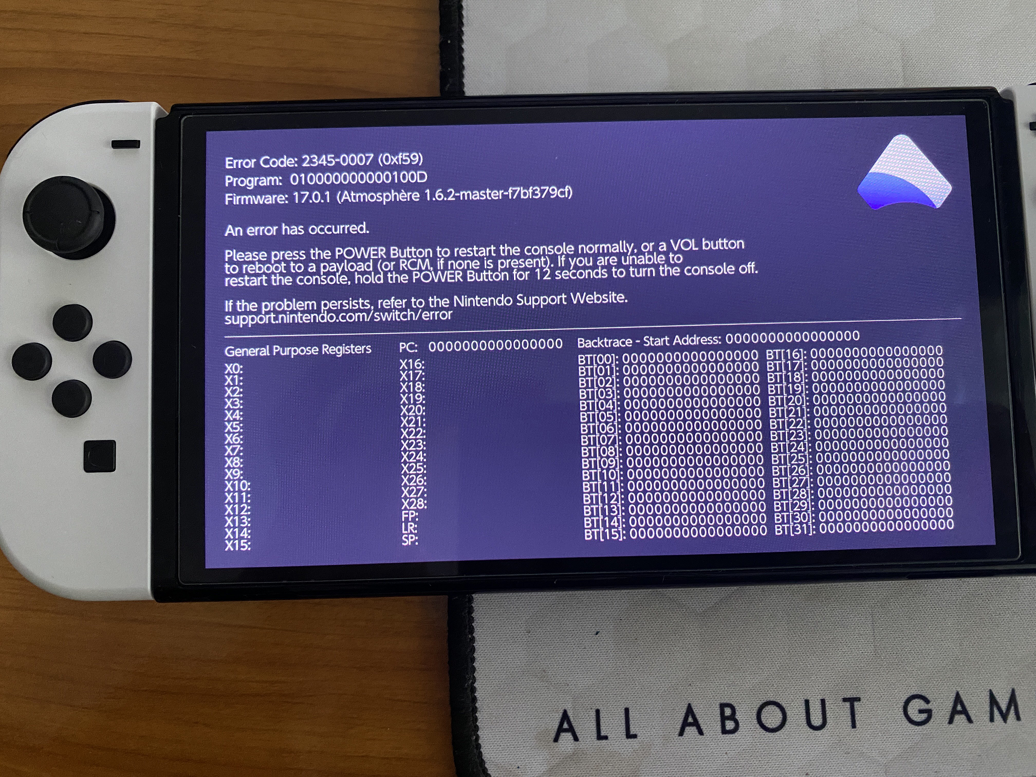

The main issue is that I'm trying to use EGL in order to fetch a proper context for the Switch window, but for some reason, whenever I call eglCreateWindowSurface inside my code, the app crashes, requiring a restart.
If I run it inside an emulator (yuzu), it crashes the emulator entirely; if I run it on proper, jailbroken hardware (it is the only way for me to develop and test homebrew games) I get a crash screen, which doesn't really provide useful information. I think the backtrace got corrupted or something.
This is how my crashes look like:
The snippet of code I'm using is the following:

0xF59 = LibnxError_AlreadyInitialized
Which means this function tries to initialize something you have unnecesarily initialized earlier. Without following backtrace you can have hard time to figure that out if you have no idea what can be an issue, so GDB may be necessary to fix this.
And use Application mode if you don't want to crash whole system each time.

I did some more digging through, and I think I found the culprit.
Somewhere in my platform code for the engine, I'm calling consoleInit(NULL); which guess what it did... it initialized the graphical renderer for the default window already!
So if you ever use consoleInit inside your app and you want to use EGL at the same time, it's not possible.
Now my engine works properly after removing the call to consoleInit! Thanks for the hint about what the error could be. It was quite helpful.
