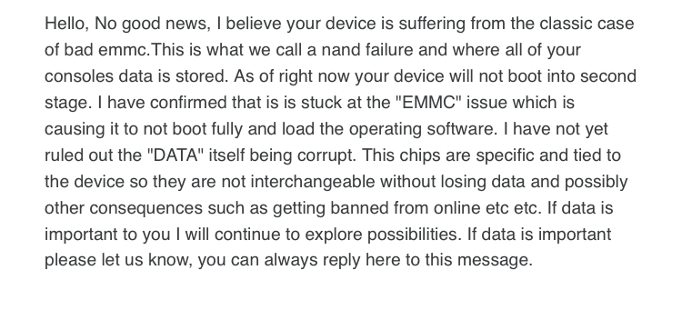

Took my modded switch, which won’t turn on, to a reputable repair shop. Here is the diagnosis given. Is this a common issue? And what likely caused it?

It’s not common but definitely not unheard of. There are several threads on what to do next to recover from a bad emmc.
Lots of things can cause an emmc to fail and it’s going to be really hard to guess remotely,
This is a major reason it’s recommended to backup you emmc when you hack your switch. If you have a backup you can get a new emmc for cheap and restore the backup. If you don’t have a backup you can create a hacked image but it will have mismatched numbers and thus it will be banned from connecting to Ninty.
Even if this end up being the case, not all is lost as you will still be able to do everything you always could under CFW.

Yes, but that was from 2020. If you haven't made more recent backups since then you'd lose everything in between.
Reactions: Prior22
Get a new eMMC module and install it into the switch, then use hekate to write those backups into the new chip.
Your shop might even offer this service to install one for you if they have stock.
You can choose to do it yourself, but you do need to wait for the chip to ship from China, and get the screwdrivers needed to open a switch. The process itself is not that hard; no soldering required.
