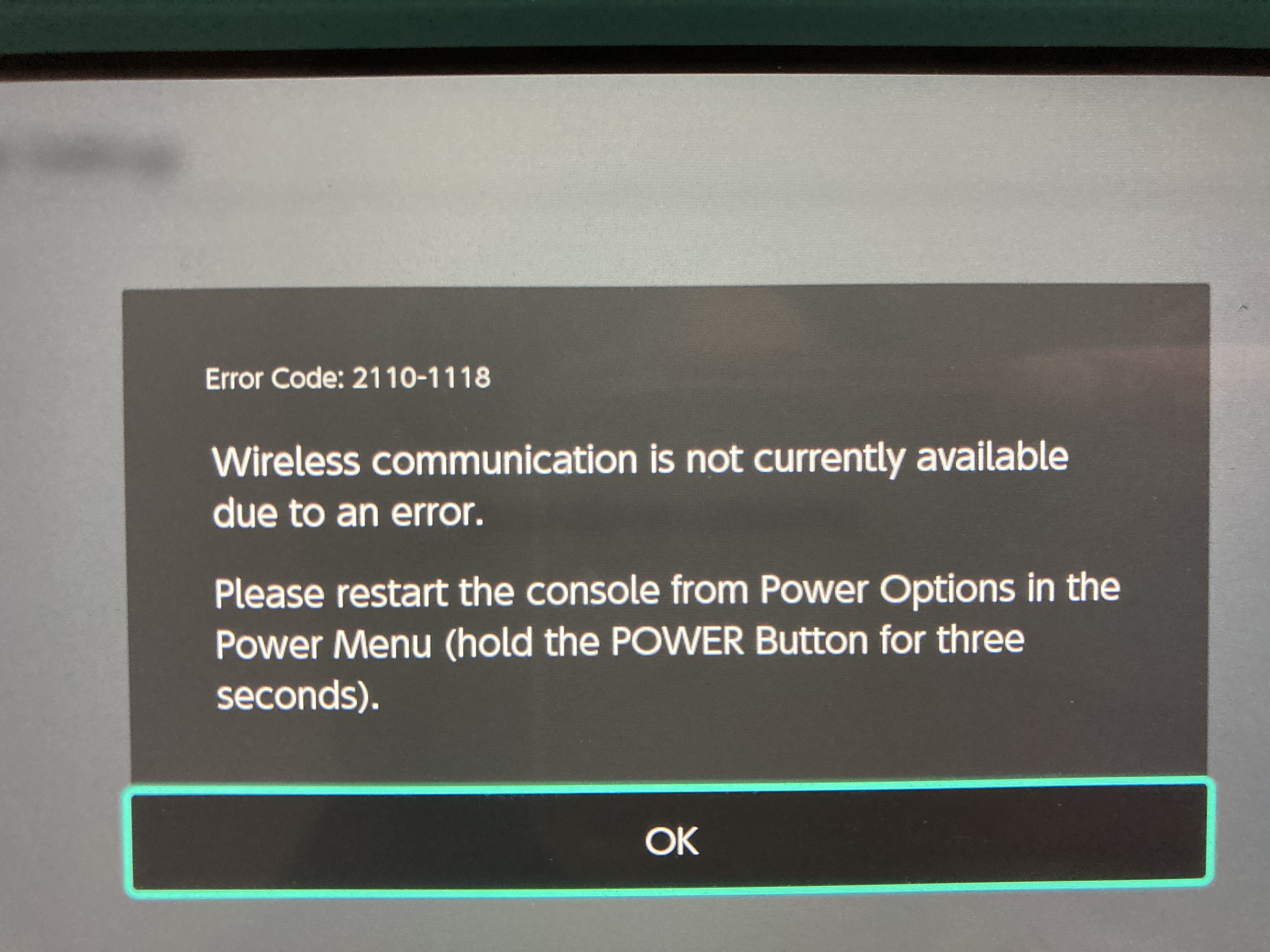

When I attempt to connect to a wifi network I get the following:
However I am able to connect to a Bluetooth joycon which I believe is handled by this chip too, so I’m starting to be suspicious of a wifi related component outside the cyw4356x chip.
