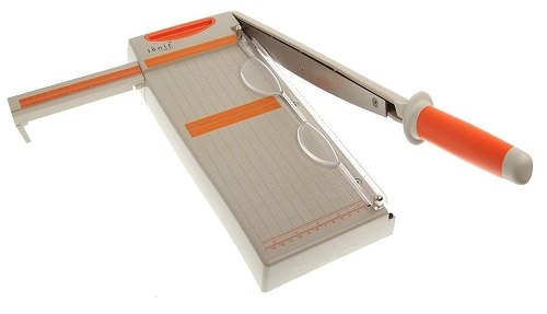

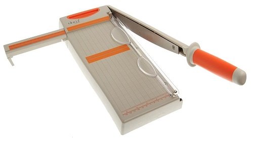

I personally recommend a device like this for cutting (worked best for me):
Not what I meant but thanks for the recommendation on the cutting tool. I meant the type of paper I should use and if I can use it with the printer I have. I have the PDF's made just sitting ready for printing.
