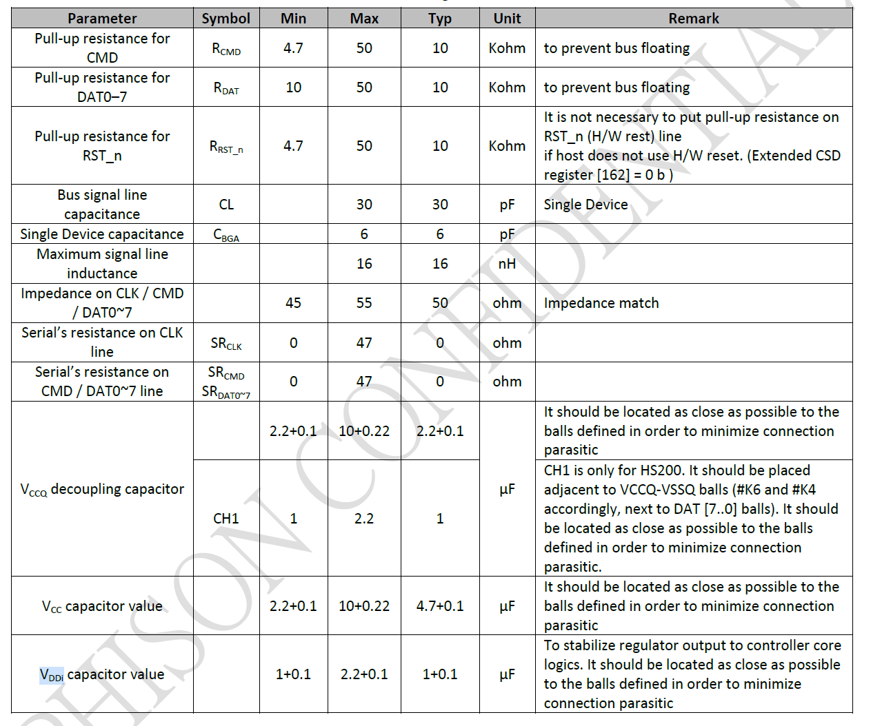

Hi a modder tried to mod my switch oled but its gone wrong.
He stripped a cap. Does anyone of you know which cap value I need for this one? See attached pic.

That's the filtering cap on Vddi line. Should be 1uf according to emmc datasheets:

Would this be a correct one? I'm not sure how to find the correct one, I'm still learning:
Type Multi-layer capacitor
Version Soldering surface
Design 0805 (2012)
Technology X7R
Build-up SMD
Electrical data
Capacitance 1µF
Voltage 16V
Measuring ranges
Tolerance 10 %
Dimensions
Length 2.0mm
Width 1.25mm
Other
Temperature range -55 ... +125 °C
Factory data
Manufacturer KEMET
Manufacturer part number C0805C105K4RAC7025
Packaging weight 0.001 kg
RoHS compliant
