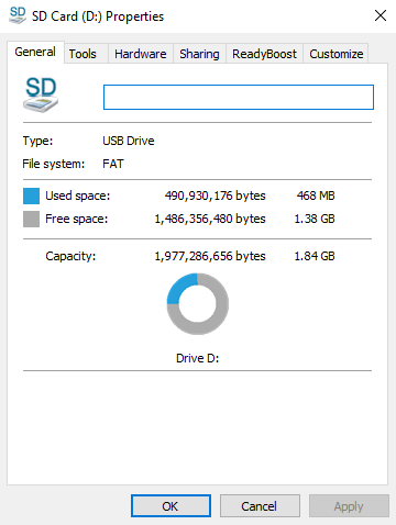

I have an official Wii 2gb SD card and it is in the fat format. Just another thing to acknowledge is that a Wii can only handle 2gb unless it is an SDHC then it can handle up to 32gb. Try some other cards if you have them. The Wii is very picky with SD cards.
The Wii can use SDXC with 64GB+ just fine when formatted to FAT32 (like many other devices). 32GB is only the official limit since SDXC come with exFAT by default.
