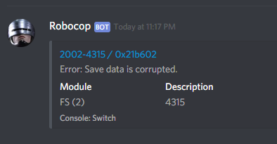

Now when I click on "boot CFW" on SX OS it displays the Nintendo logo, then "an error has occured, Error code : 2002-4315" and it shows me my serial number and my firmware version "4.0.1" and nothing else... How can I recover from this please?

I just got it, you downgraded with ChoidujourNX, I just remembered what it was, restore your 6.1 backup then redowngrade with choidujourNX but this time on the left check system initialisation :) :)

nah when downgrading its best to do the system initialisation unless you are restoring a backup from what I've found :)
