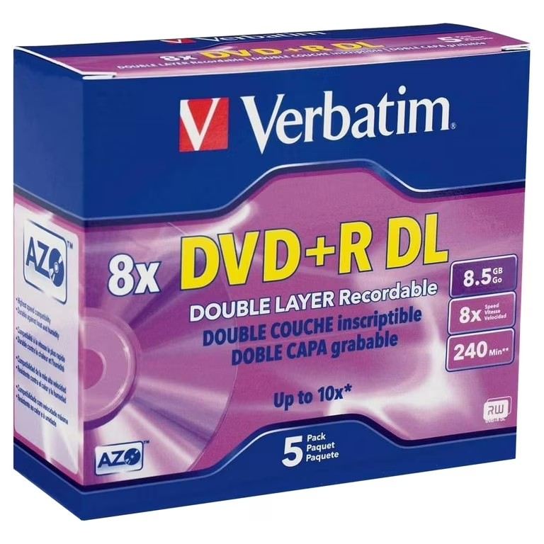

Hi all. I had a Lite-On iHAS 122-04 B that I used for a long time to burn my Xbox 360 games. But it is dead now and I decide to get a new Lite-On burner. After a research here, I got an iHAS-124 C that looks compatible with BurnerMAX. Is impossible to find now Verbatim DVD Dual Layer here now. I have used them for a long time burning Xbox 360 games, so as it is impossible to find, I decide to get RITEK-S04-66.
