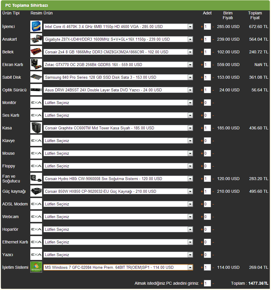

    Well I didn't spend any effort in making a build, but here it is:
    Note: I didn't pick any monitor, keyboard, mouse, etc. But I did add Windows. Just because. And there's plenty of budget to spare to upgrade the graphics card, add extra HDDs, add a sound card, etc.

    Can this one stand for 4 years ? c:
  16. Originality
    Originality Chibi-neko
    Joined:
    Apr 21, 2008
    Messages:
    5,708
    Country:
    The CPU will certainly stand for 4 years. The graphics card too. So will the cooler, PSU and case. Windows will probably not stand 4 years since I anticipate a W7 style OS revolution (like how W7 was to Vista, I expect either W8.1 or W9 will become standard over W8).
    The storage in that build will need adding to. It's only 128GB, enough for an OS, your programs and some games. Simply add a 3 or 4TB HDD on top and it will last the average user 5+ years (I tend to buy an extra 4TB every couple years).
    I can't speak for your keyboard, mouse, monitor, etc.
