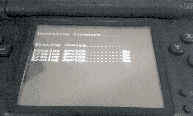

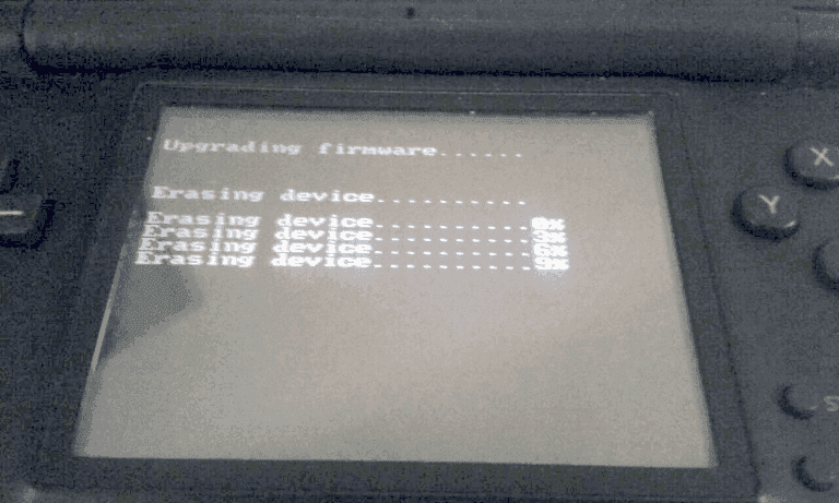

well I tried with my 2014 card anyway, opened the program, changed the card and strated it
"Erasing device ......... 0%"
....nice it froze again ...
So I went look for another tuto or something, looked at screen and... it added a line with:
"Erasing device ......... 3%"
wow it's something , lets wait!
and it's passes like 10 ours and it's like
"Erasing device ......... 9%"
ok, it gonna take forever... but less than a new card arrive here I guess :v

in the end it don't passed by 9% :/
I know, but these stuff aren't that cheap here yet for some reason, and used second hand is a bit dangerous .. I was too too lucky with this one and too unlucky when tried to update it :v I could just leave it on a DSlite I'm going to give back to a buddy .. now I'vv have to get 2! lol
