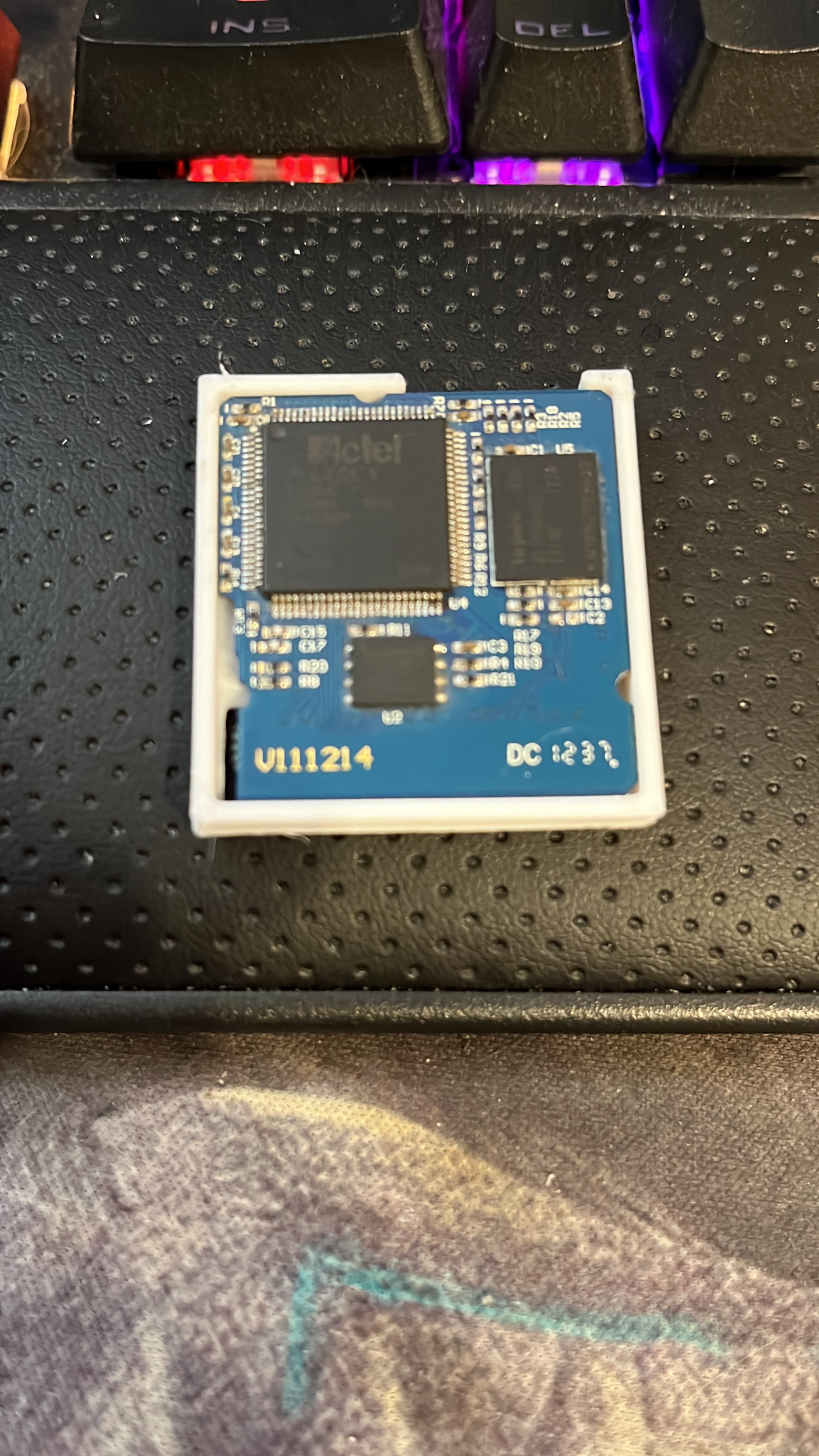

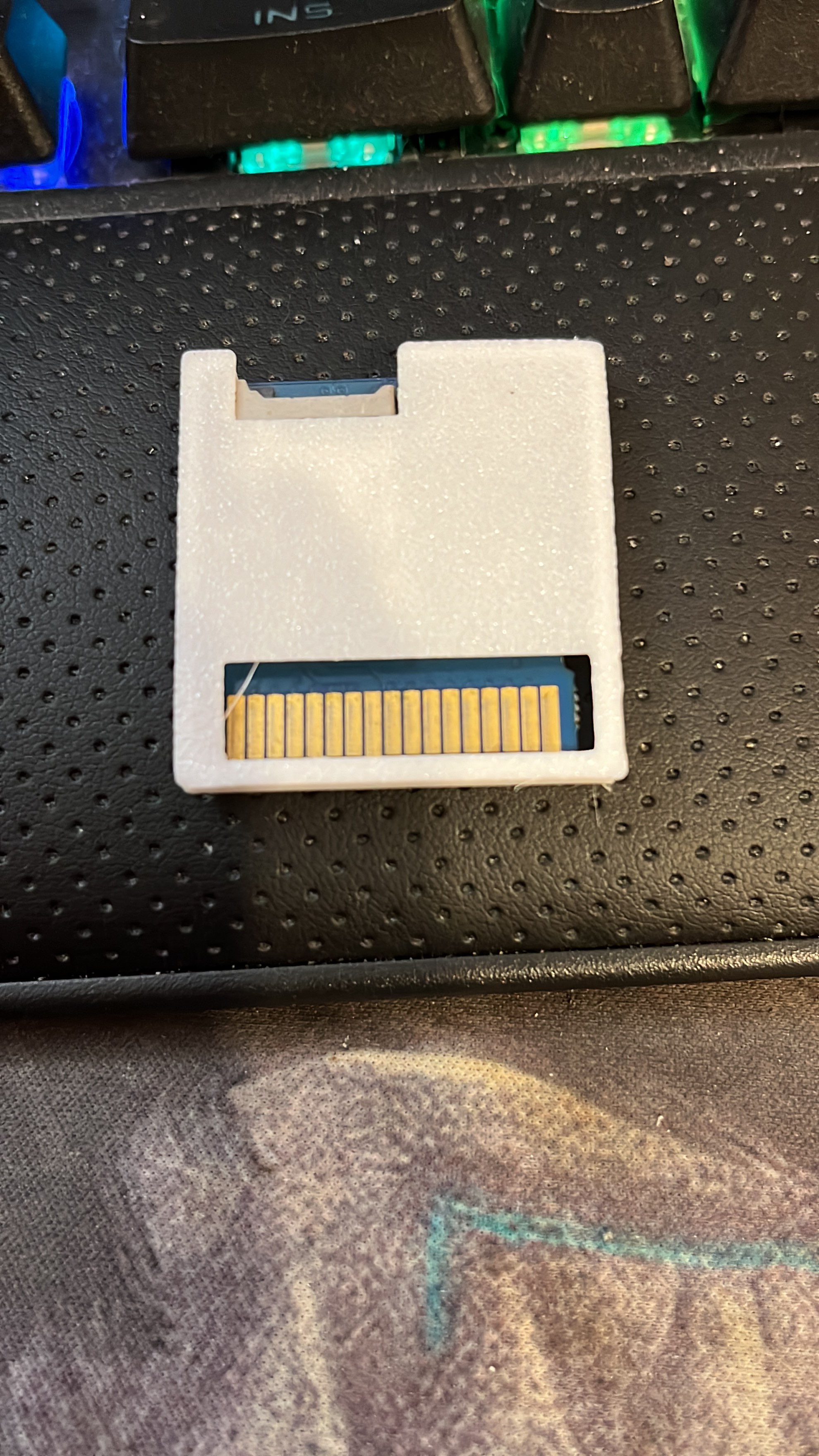

Im currently working on something like that for the supercard dsTwo. I plan on sharing the CAD files so maybe someone can modify it to work for this project as well
Its got a long way to go still though since I'm still learning to model objects, and and have done something this tiny with such tight constraints. It at least clicks into my system and reads currently however
View attachment 408310View attachment 408309
Could be improved regarding the contacts. But well done.

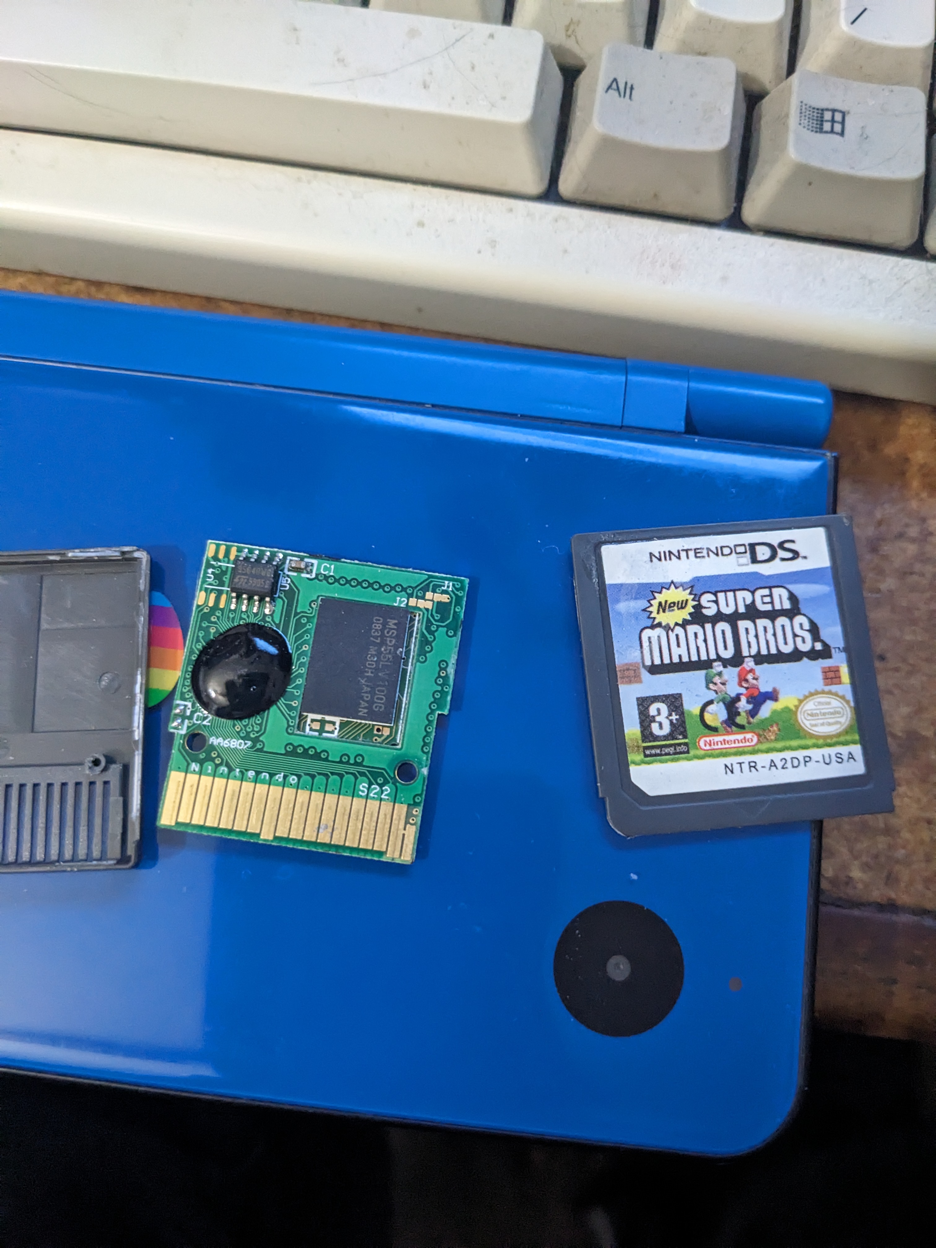

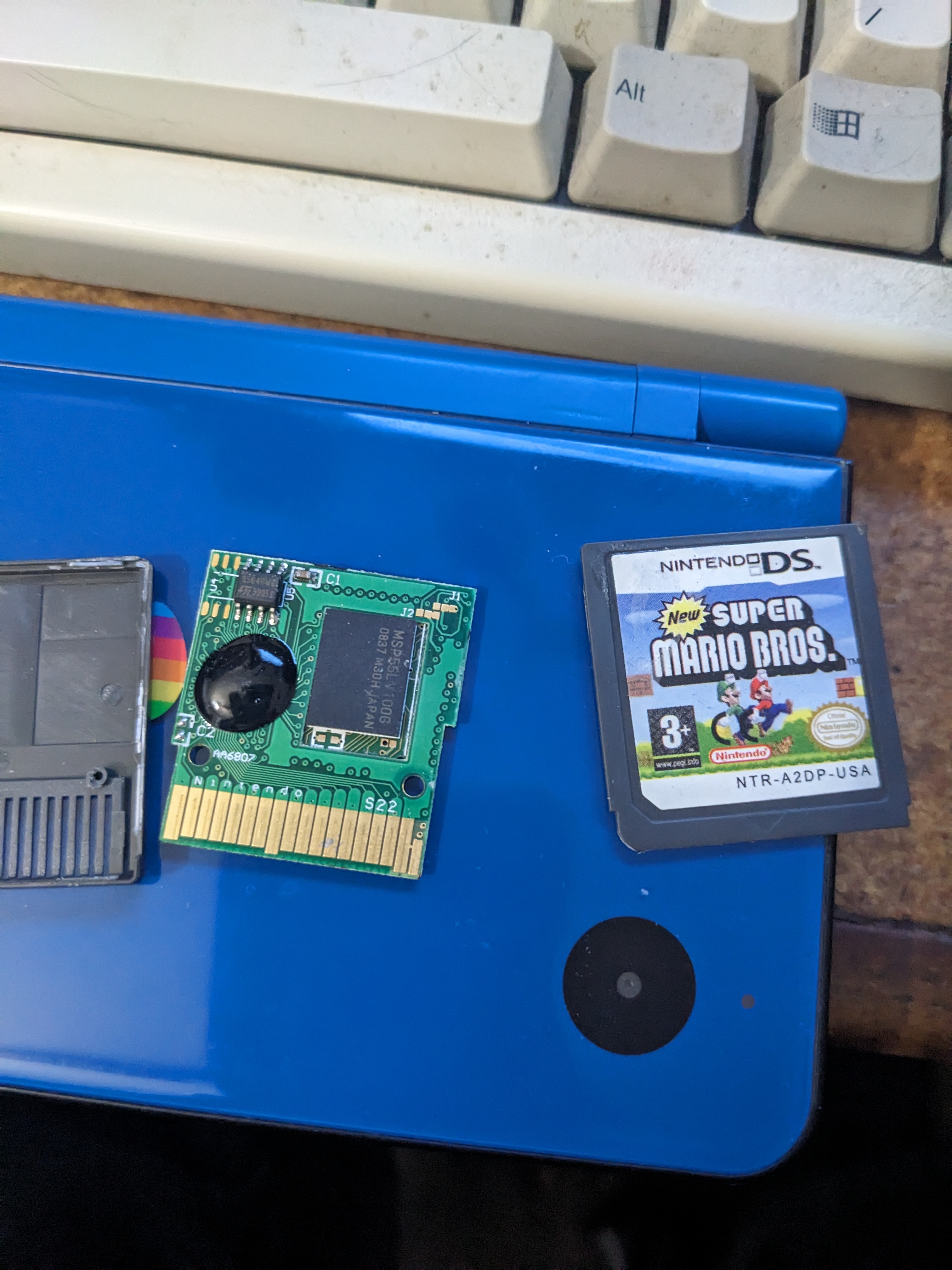

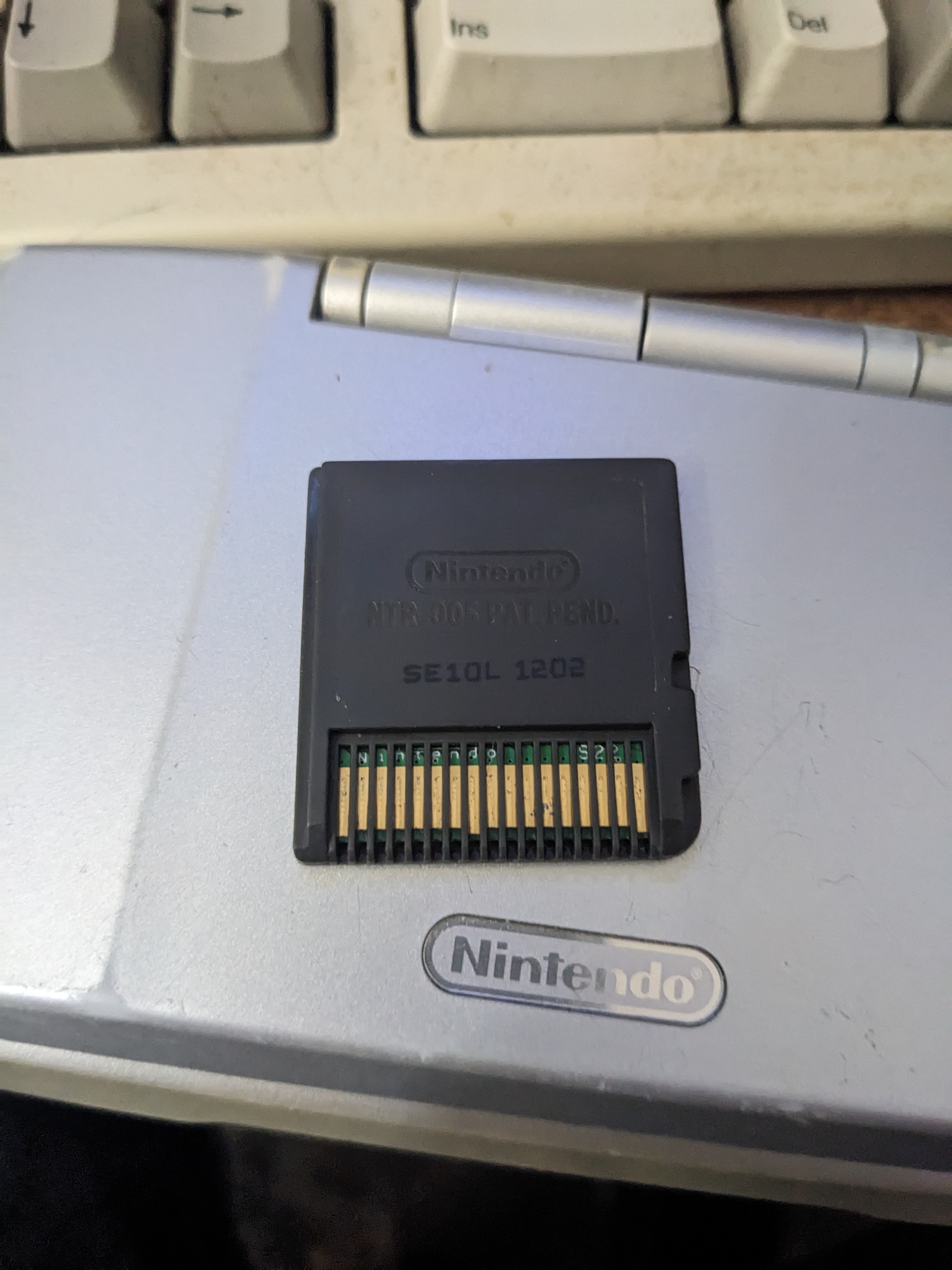

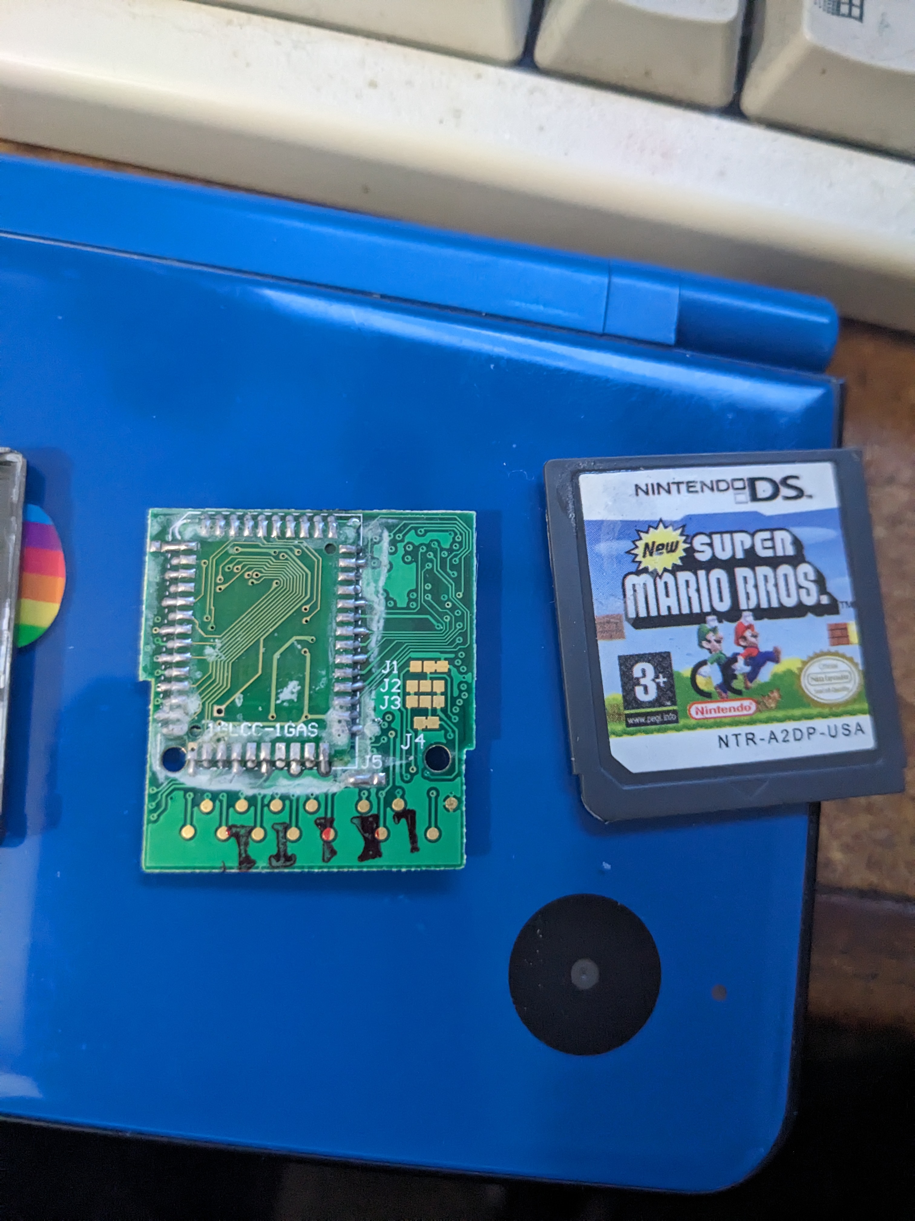

The New Super Mario Bros DS bootleg came in for me...and it's not an N-Card or is a ancient varient of it that isn't compatible with the newer N-Card stuff like udisk and what not. No idea what would have been used to flash these. I assume those USB dongles the really old N-Cards used?
Reactions: SylverReZ
Indeed the regionally confused label was a dead give away. I have another bootleg arriving with a similar error. Though I suspect it will be the same type of hardware as this one. The shell design was really close to official. And the markings on the backside were really close...if only they didn't blow it with the label. :P
I did a rom dump it was indeed the Europe rom the cart contained. So at least 90% of the label did correspond to the version of the game the label indicated it was. :P
This cart boots on my 2DS XL by the way. Assuming the rom is 1 to 1 to the Europe release it probably passes DS Cart white list checks too and will boot on non CFW'd consoles...Though I currently do not have any to test that on. :P
EDIT: Here's a photo of the backside. If it weren't for the label you'd have to look pretty closely to tell it was a fake.UnknownBootlegCart3.jpg
EDIT: Here's a photo of the backside. If it weren't for the label you'd have to look pretty closely to tell it was a fake.View attachment 409105

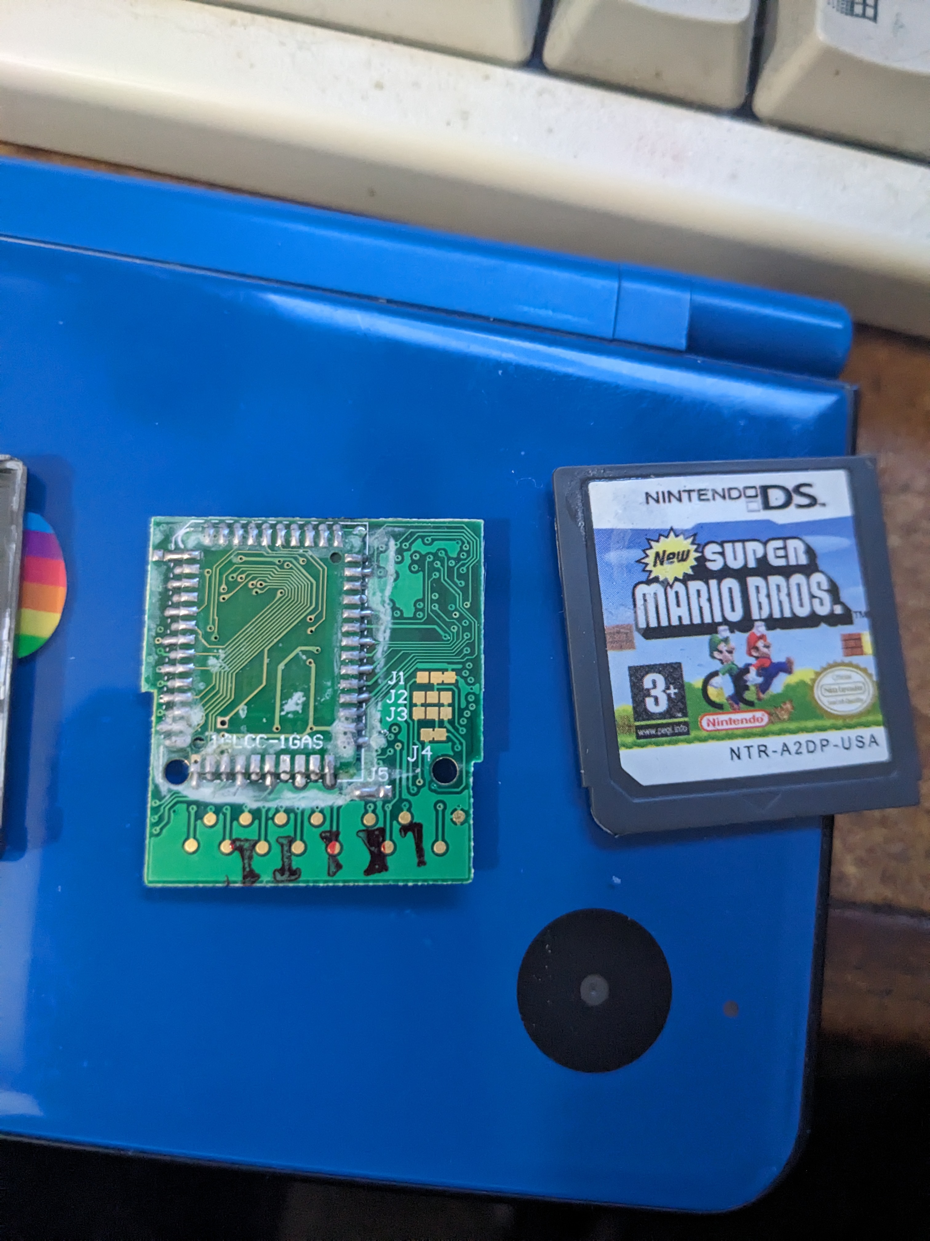

Yeah received that the other day. Turned out to be an N-Card clone. Used a 2G (128MB) nand with 128k sram. Battery still got a good charge to it surprisingly. Already have it reflashed to be a standard N-Card. :D
