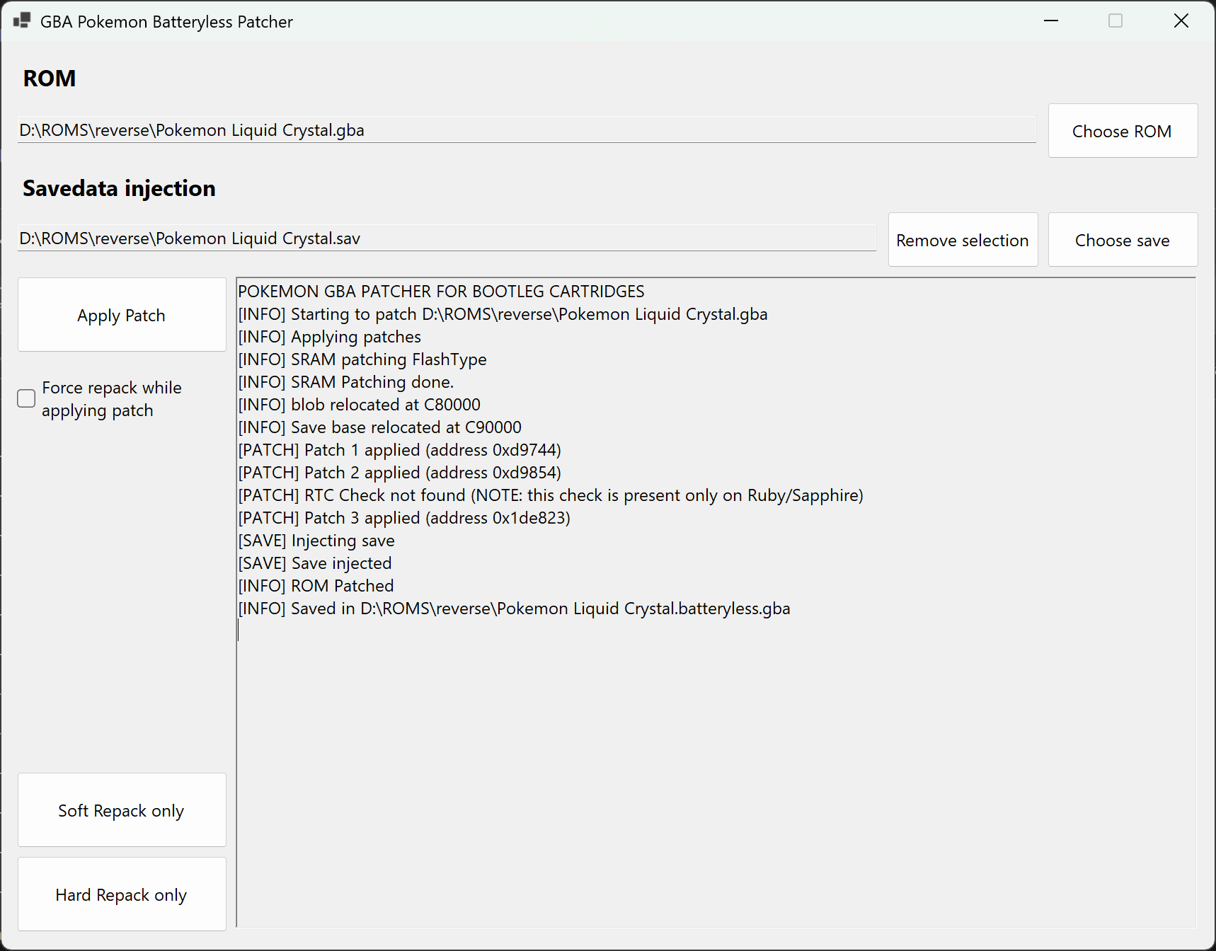

Batteryless Save Patcher & Repacker for GBA Pokémon games
Based on AliExpress Bootleg Patch
A week ago I said “let’s put a few of my favorites hackroms on bootleg cartridges”, but then I found out about.. well, everything about SRAM batteryless patches etc.
I patched the games with gbata, and tried to use the batteryless patches I found… some almost worked, other didn’t work at all.
But the bootleg cartridges I had? They worked perfectly. So I dumped them, compared them with the original ROMs, and figured out exactly how they were patched.
And here we are with the result
What this tool does:
This tool is a fully automated and relocatable batteryless save patcher for Pokémon GBA games, based on the patch reverse-engineered from the bootleg Pokémon cartridges sold on AliExpress, it:
1 (OPTIONAL, ONLY IF NEEDED BECAUSE OF FREE SPACE OR FORCED) Repacks the ROM by moving all the LZ blocks and repoints them, in order to make free space at the end of the ROM to have enough to put the blob and the save area. WARNING!!! on heavily modified ROMs, relocating could break something, since LZ blocks detection isn't 100% reliable (even though in my experience it actually fixed a ROM which had broken images by relocating them to correct offsets)
2 Applies SRAM patches, no need to use external tools like GBATA
3 Applies the same patches found on the Aliexpress cartridges
4 Copies the patch blob found on the Aliexpress cartridges
5 Repoints all the references to that relocated blob
6 Edits that blob to relocate the save area to wherever there is free space on the ROM
7 (OPTIONAL) Inject save data if selected
Tested Working On (as of now):
🟢 Pokémon Ruby / Sapphire based ROMS (Tried with both USA and localized versions)
🟢 Pokémon FireRed / LeafGreen based ROMS (Tried with both USA and localized versions)
Issues:
🟡 Some heavily modified HACK Roms have problems with repacking.
It has something to do with some data (scripts, code etc) placed far in the game data and incorrectly being identified as LZ blocks.
Avoid repacking if possible.
🟡 LZ blocks detection (and the detection of the pointers to those blocks) isn't 100% reliable and could break games.
Avoid repacking if possible, even though in my experience it actually fixed a ROM which had broken images by relocating them to correct offsets, but that isn't always the case.
Download & Source:
https://github.com/DanOl98/pkmn_gba_batteryless_patcher
Let me know about your results, and if you find some bugs or if something doesn’t work
Keep in mind that as of now the patched ROMS haven’t been texted extensively (but I’ve tested first save, multiple save overwrites etc)

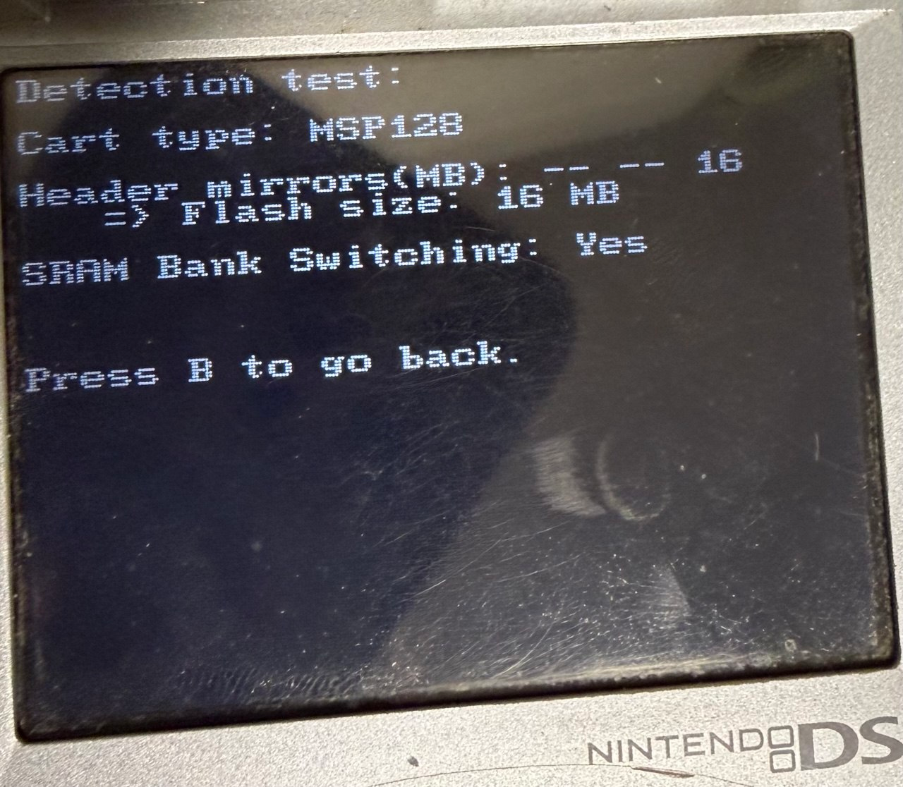

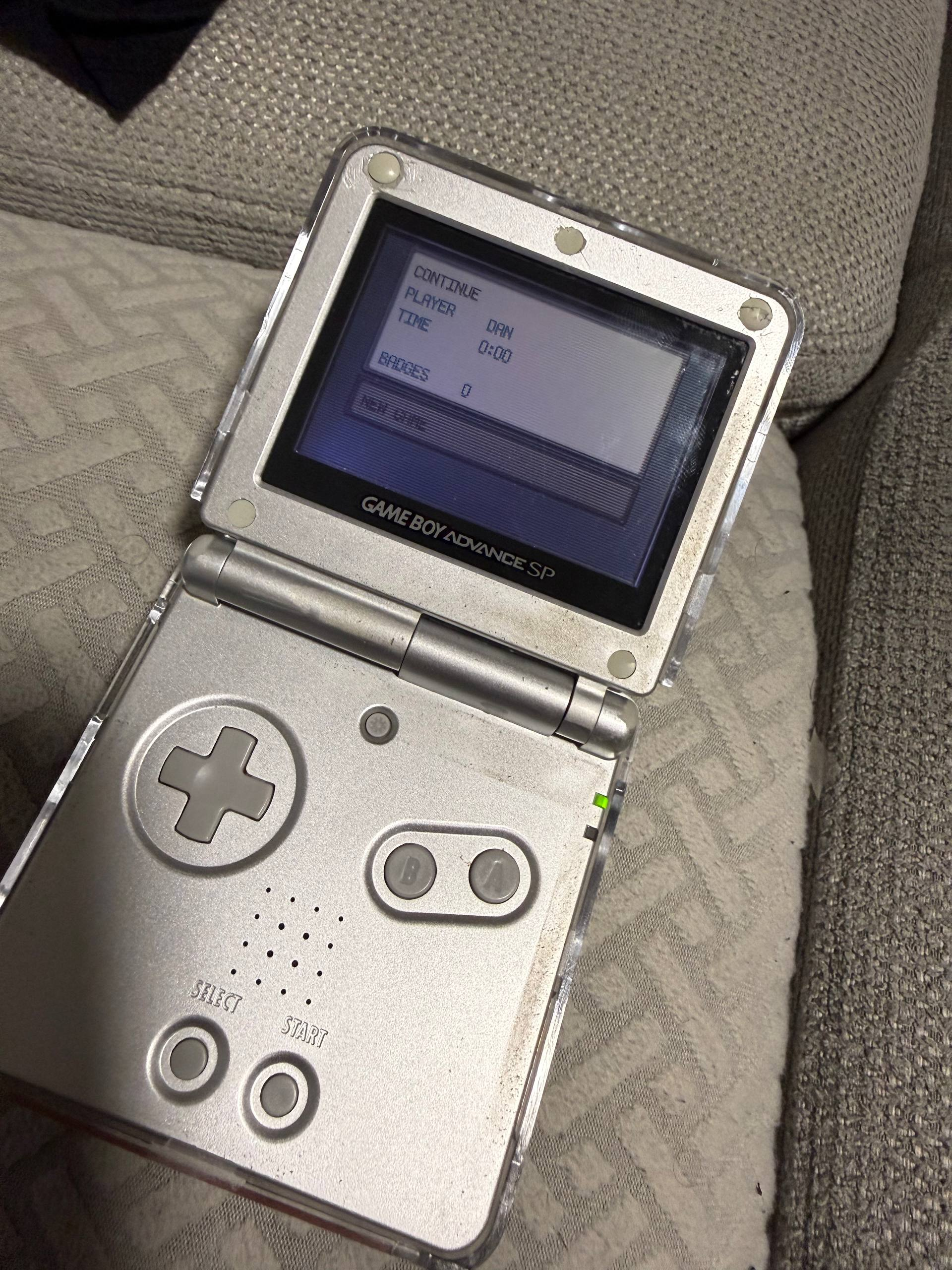

View attachment 543140 View attachment 543142
Apparently mine doesn’t have SRAM bank switching, could that be why? My cartridge is a MSP128 and I’m pretty sure I had a clean Fire Red since I got it from Vimms.
I just tried to make a new save and now everytime I open the game it gives me “The save is corrupted, The previous save file will be loaded”
Is there any way you can send me the link to the Aliexpress listing you bought for fire red? I think this cart is just crappy lol. I'm guessing based on what I've looked up that I definitely need SRAM bank switching to do this.
I would love if someone made a bootleg cartridge of Pokemon Lazarus! Awesome work hopefully this encourages people to put there rom hacks on cartridges.
Honestly, I thought that all the (or at least the recent ones) low-cost batteryless bootleg pokémon cartridges used SRAM bank switching.
Unfortunately, I don't have enough experience in how these cartridges work and how many different types exist, since I only ported the pre-made patch for these cartridges, maybe soneone else could shine a light on this though
