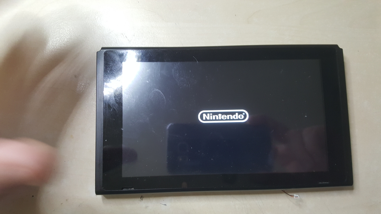

I have 2 Nintendo Switch with the same problem. After USB-C replacement, i got these problems.
When I press the power only the Nintendo logo appears, then the screen goes black.
I've checked pin 5 and 6 of the M92T36. Both are 3.3V.
All other caps around M92T36, PI3USB and BQ24193 are OK.
Does anyone know how to repair?
