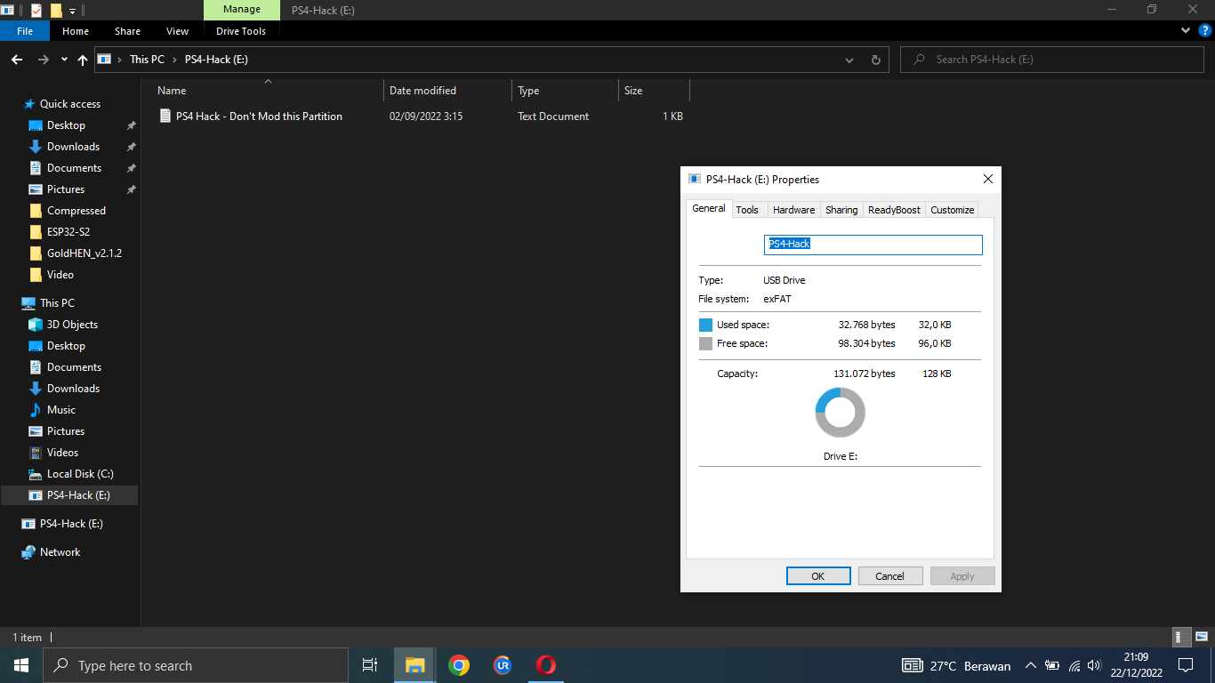

Here you go people, I have created a better image file for your usb drives to replace exfathax.img.
This is better for the following reasons:
With exfathax.img there is an error dispalyed on the ps4 because the exfat file system doesn't exist and the ps4 can see that there is an error in the usb file system. I have created a new image which fixes this error and has a very tiny exfat partition only a few bytes, but stil shows up on pc without the need to format error. This also stops the usb error message showing up on the ps4. This should make booting into the hack easier.
To use - just use win32diskimager to write to the image to your usb drive. You can also create a partition on the existsing space on your usb drive and use that on the ps4 for installing pkg files.
I tried to post this on poobs4 github but there's no way to post on that page, so I'll release here and someone can pass it on.

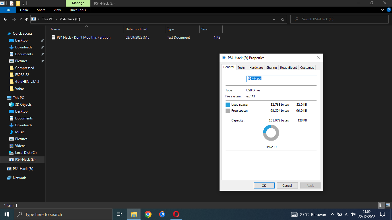

I just flash my flashdisk with this imagehack , is this right ?
You flash your usb drive with it, the remaining space on the drive can be partitioned and formatted with any file system you want and you can use that in windows or any other OS for other stuff. You should then have 2 partitions - 1 with the USB hack which is very small, the other for whatever you want such as storing games or whatever.
