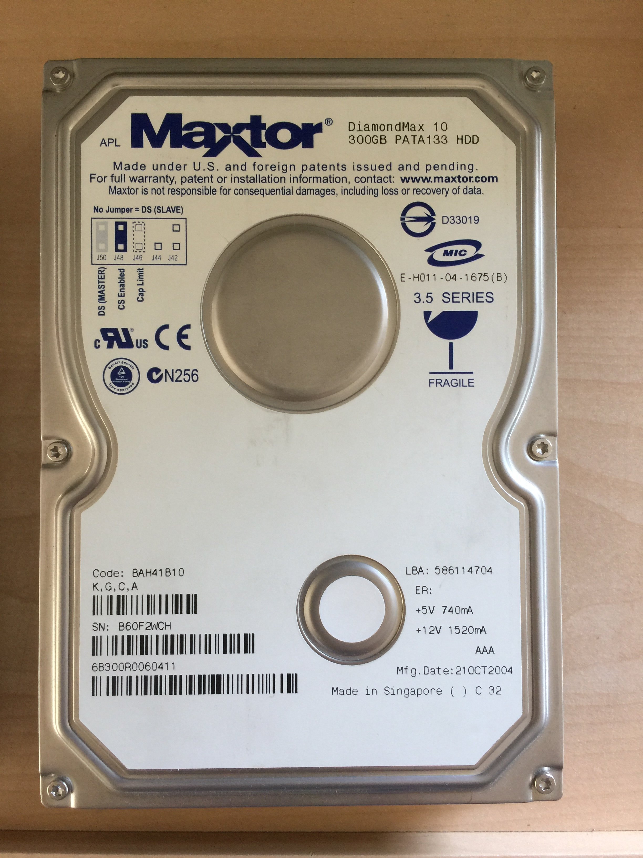

This is the one I’ve been using for ever.
