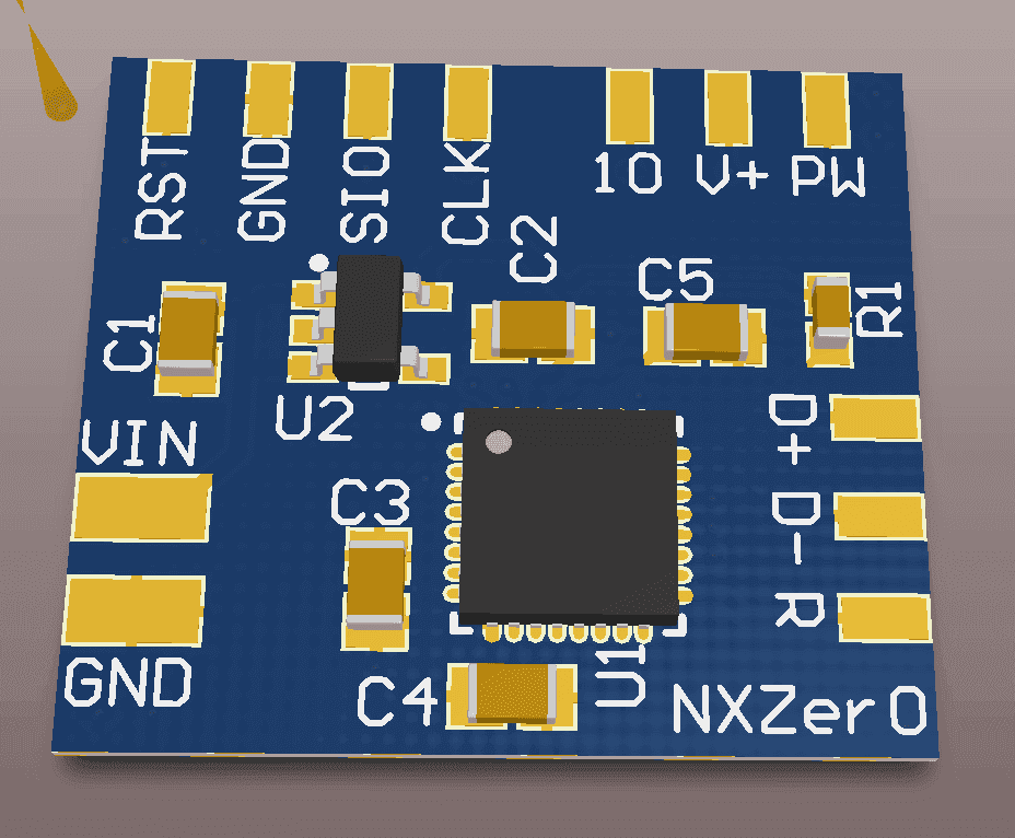

Hi guys. I'm developing an internally mounted modchip for the switch.
My goal is to launch directly into RCM without having to corrupt your NAND or push buttons/use jigs. I will make it completely self contained and open source when i finish writing the software. I'm no team rebugged, but i like doing hardware and wanted to make a completely hands off and self contained modchip, since those are features i have yet to see. The design is aimed at people with some soldering experience.
I will use this thread to post updates and ask/answer questions.
Have a great day.
-Goseph

Which chip are you intending to use?
ATSAMD21E, since some nicely functional fusee gelee code exists for it. It's also very cheap and has a lot of great features like usb-host built in. Another plus is that I have already worked with atmel chips a couple times, so writing code should be a bit faster. Haven't done much ARM though, that should be interesting.
