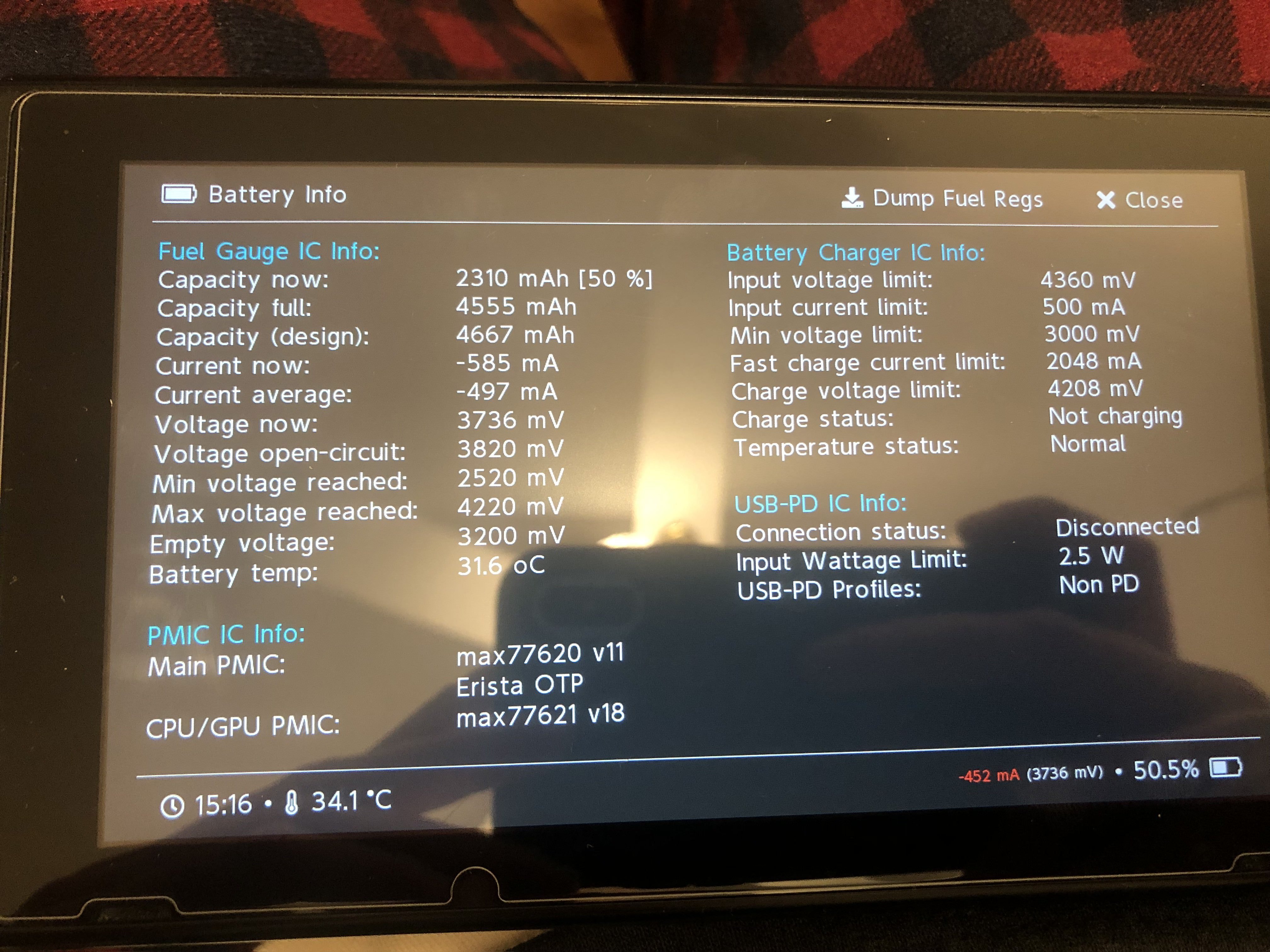

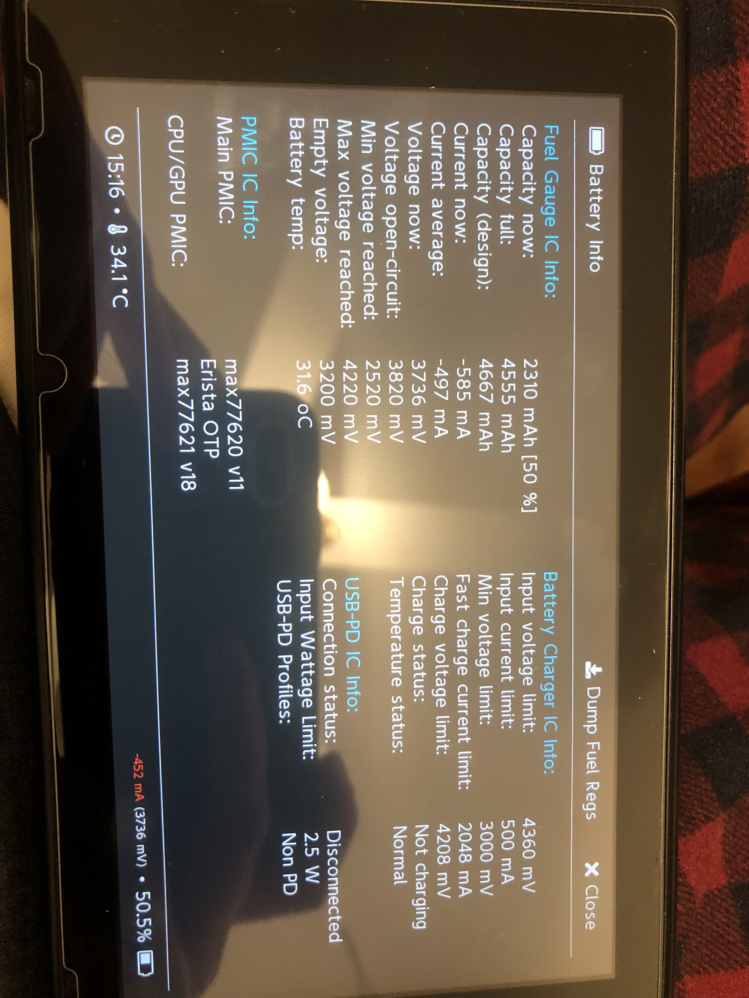

Show Hekate battery info

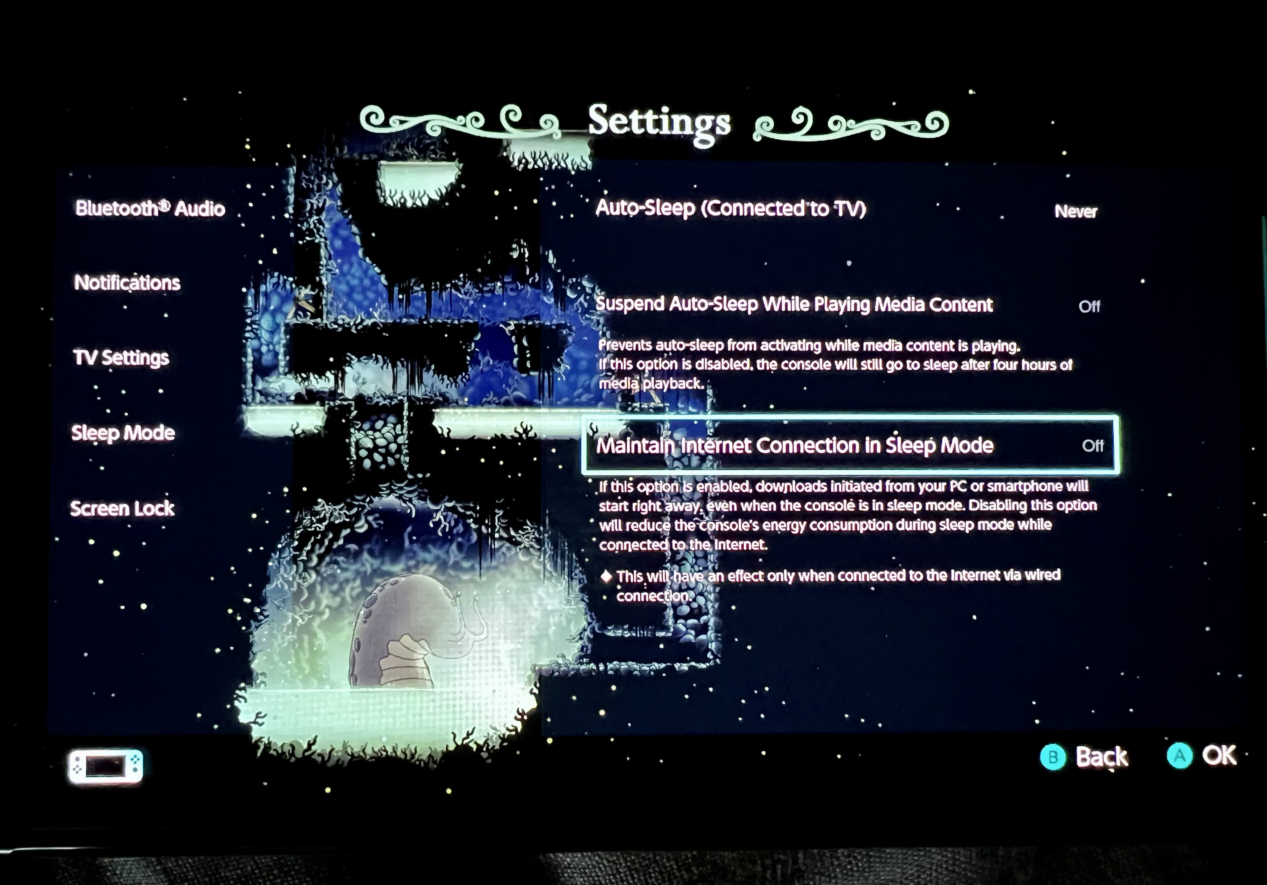

Perhaps turning wifi off or turning airplane mode on before going to sleep will prevent it from waking up to search for updates? Could help improve sleep battery life. Worth a try, anyway.

Theres a setting somehwere in the settings to turn backround downloading and stuff such as to download game updates when in sleep mode, turn that off. i dont have my switch on me, but you just turn that off and it will save the headache. mine used to die constantly now its fine

Well that's exactly the true state of my Switch, last time I have done a full cycle was like 2 years ago and never used the battery since then, in fact the console have mostly been handheld connected to the charger and never used once (which I know is also not good since for storage I should have let it at around 50% charge turn it off and remove it from the charger and put it in the carrying bag which I even have anti-humidity packs inside LoL)...
Hekate still shows battery capacity above its maximum designed capacity though it would need a few full cycles for calibration purposes.
