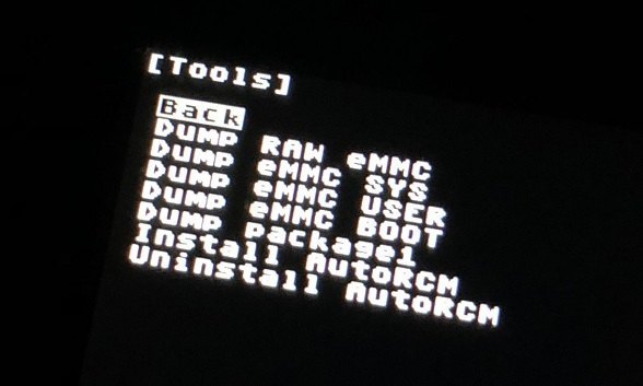

AutoRCM works by "bricking" the console. It makes the Switch unable to boot the OS, so it boots RCM (Tegra Recovery Mode) instead. Installing AutoRCM is beneficial because it will always launch RCM on boot, but it also means you will be unable to boot into the Switch OS without first loading an RCM payload through the USB-C port.

This tool modifies a single byte in the partition headers of your NAND, breaking their signature. The console won't boot what doesn't look valid.
