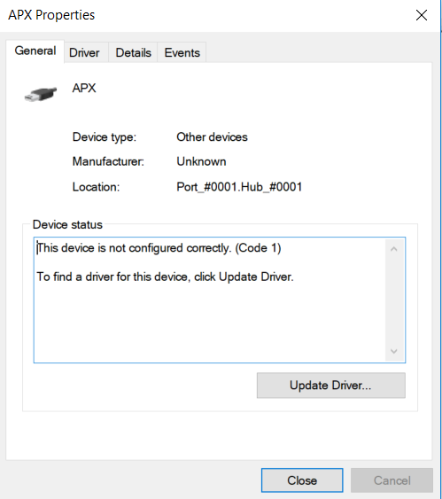

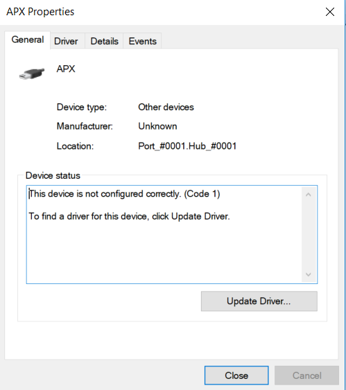

Device Manager reads:
This device is not configured correctly. (Code 1)
To find a driver for this device, click Update Driver.

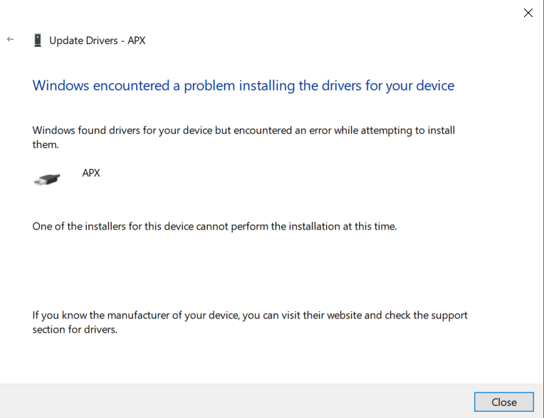

Trying to update the driver automatically online, or any driver with a manual installation, ends with:

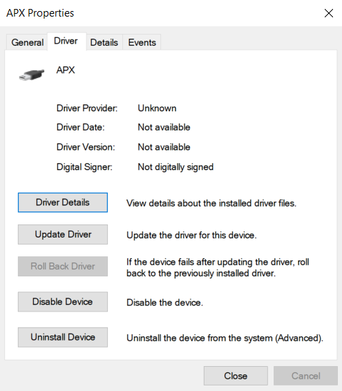

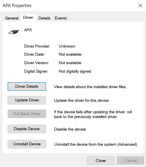

What do the driver properties look like?
Lacius
May 11, 2008
18,100
18,356
View attachment 172073 View attachment 172074
Under Details > Problem Status, I see:
The driver configuration is incomplete for use with this device.
C0000493
  1. Uninstall the device from the driver properties.
  2. Unplug the Switch from the computer.
  3. Reboot the computer.
  4. Plug the Switch into the computer.
  5. Open Zadig as an administrator.
  6. Attempt to install the driver.
What happens?
