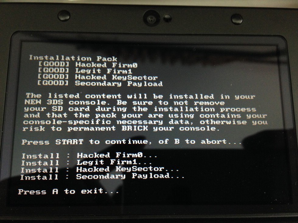

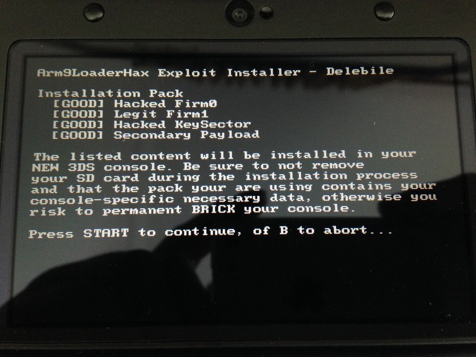

updated successfully
Nice job, thank you @delebile
I update my original fork a moment ago.
It now have many new things, check it out if you want.
Thank you delebile. I checked github for a change log but didn't find anything and the commits don't reveal much either, cam you point me where we can see summary of changes? Kind regards.
EDIT: Does anyone else know whats new specifically?
this one?
Software Update
When some essential parts of the software will be released, you'll be able to update your setup with the installer by using .pack files that i will provide in future releases.
Reactions: democracy
