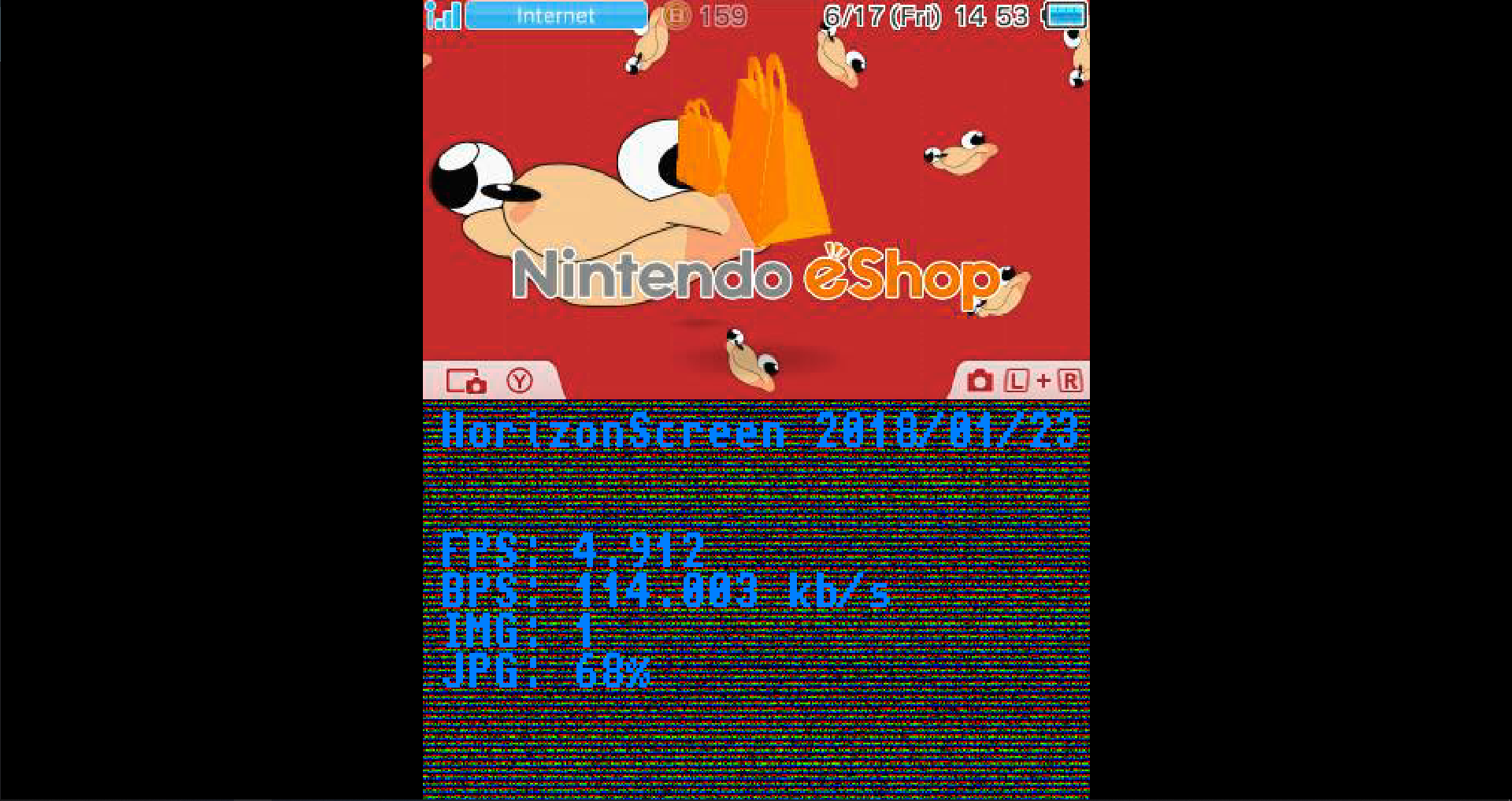

I just tried HzMOD and it worked! only thing is that im having around 3-4fps, now, i know what you're thinking, but is there any way to make the fps go higher?
if not, thats fine.
oh and also im guessing you cant see the bottom screen

Sadly no. The problem is that there are several hardware problems which limit the bandwidth at which data can be moved outside of the 3DS (without external hardware, that is), so an encoder *has* to be used on the 3DS side to reduce the data size, which has to steal CPU cycles and RAM from either the game, and/or the rest of the system on an old3DS.

That's simply just how weak and slow the old3DS is.
Funnily enough this is actually a memory bandwidth problem, which can be confirmed by underclocking the new3DS while keeping L2 enabled.
Bottom screen is disabled, as having bottom screen streaming code existing is pushing the old3DS just enough to constantly run out of instruction cache, meaning even worse performance just for having the *option* of bottom screen streaming, even if you don't enable it.
