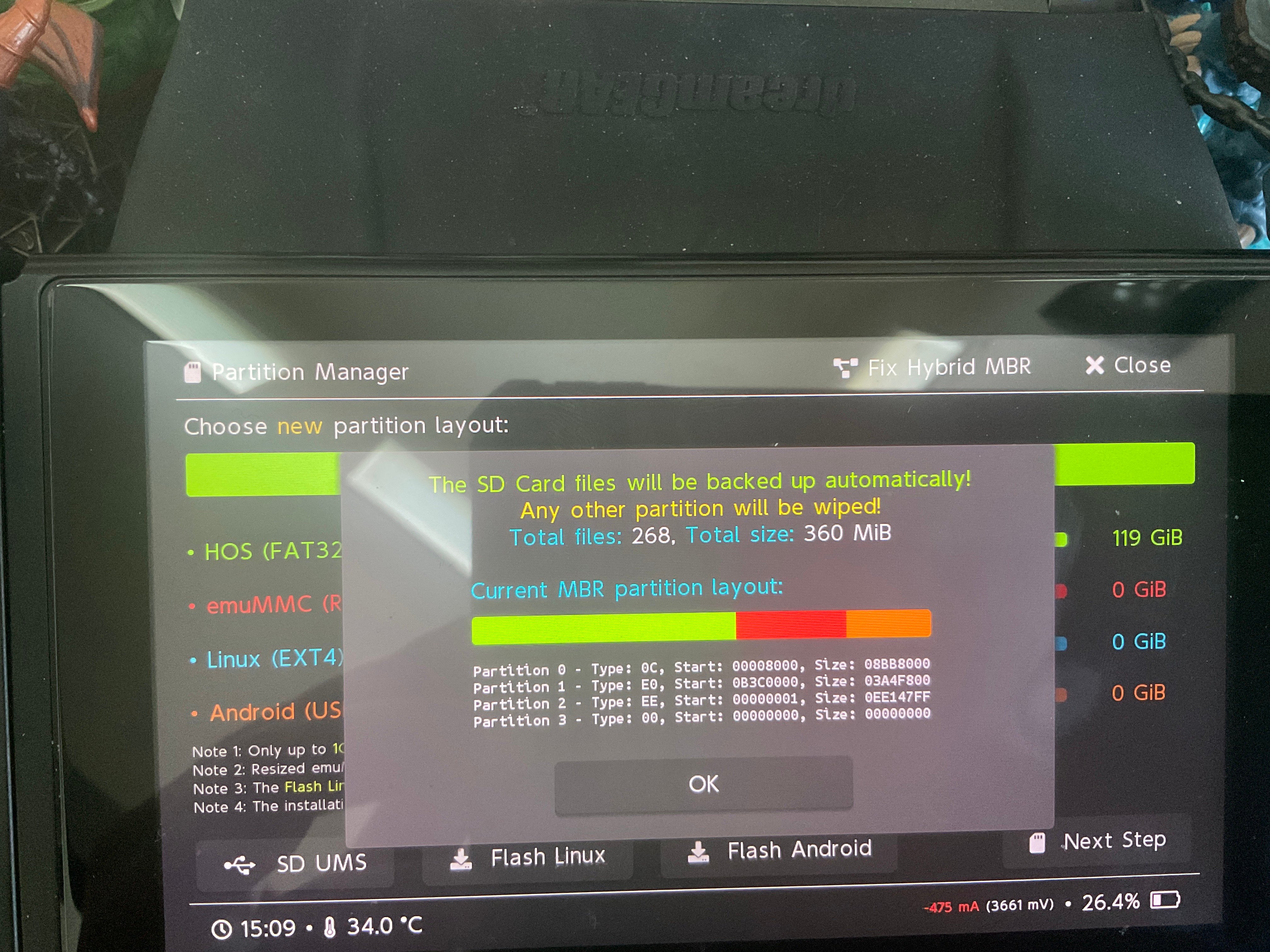

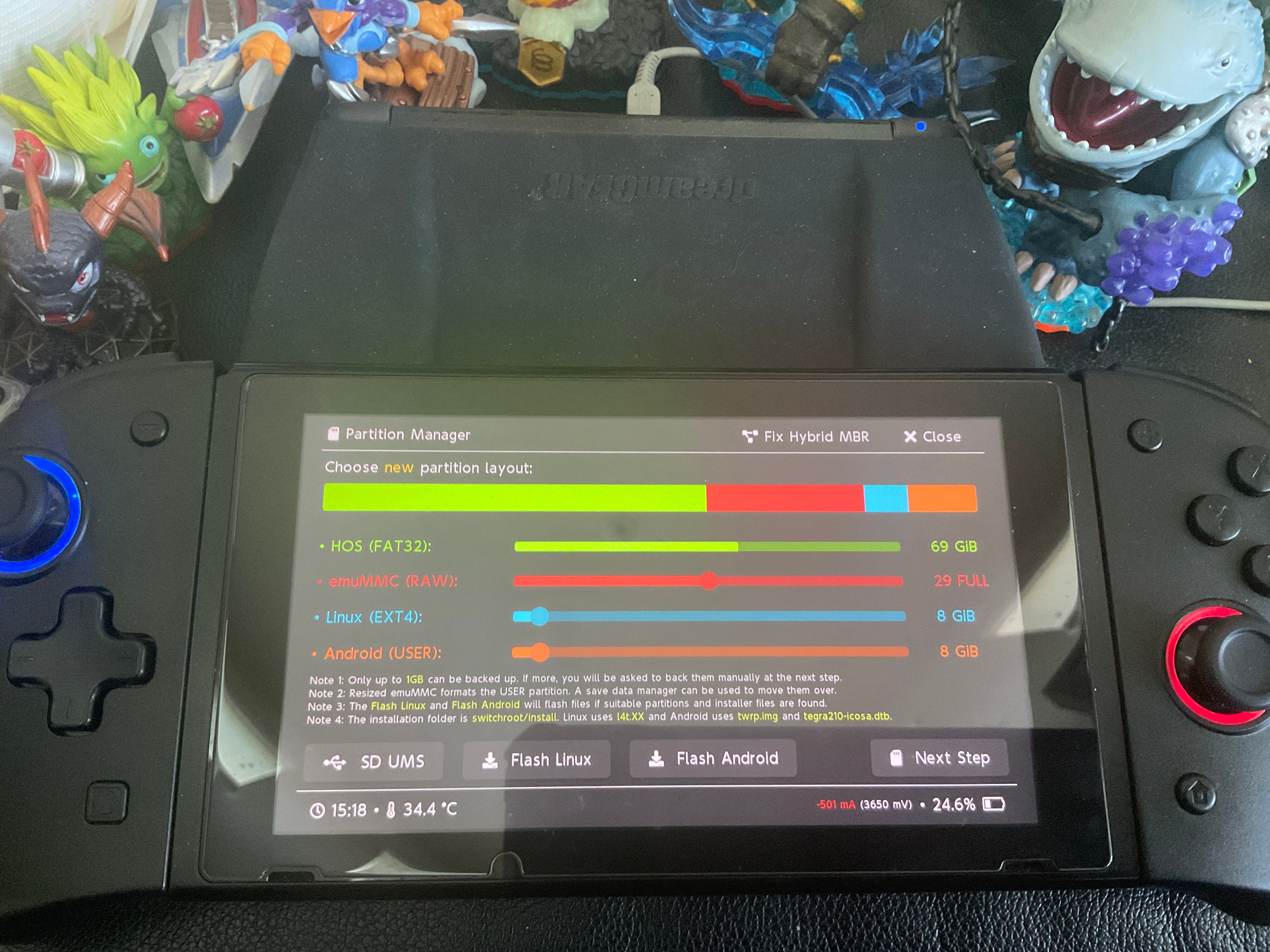

It won't show up in blue in Hekate. It will be part of the Orange (unformatted.) If you don't have a blank partition then L4T won't install. In other words the image files need a place to go and they will NOT overwrite your Android partitions. If the "Image L4T" button is enabled and pressable...it means you have the image files in the right place and an appropriate blank partition of the right size available, so go ahead and press it.

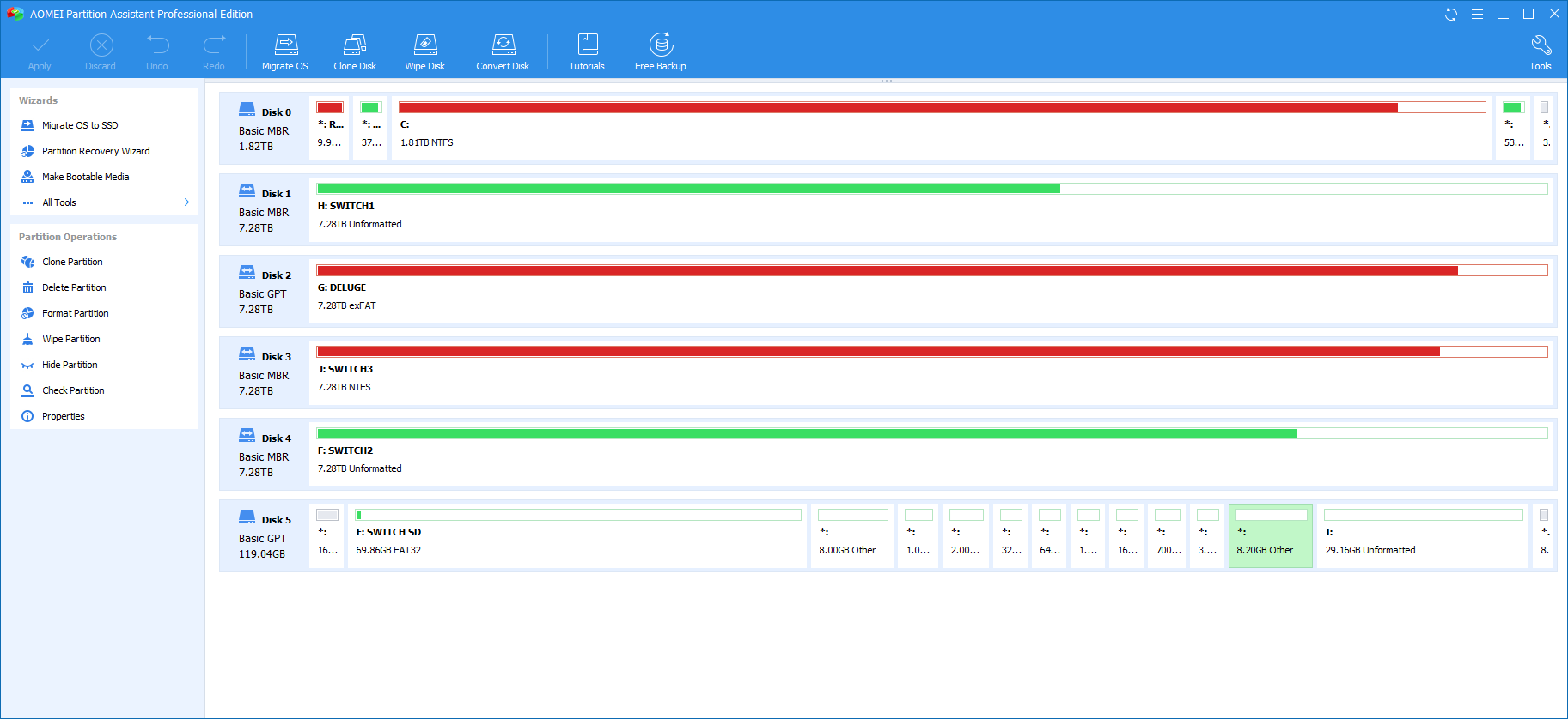

just remembered…the pics I shared earlier had all 4 partitions defined.
1) my partitions being set up
2) what those partitions looked like after it was done formatting.
3) What those partitions (with no blue in the second pic) looked like to another tool. See disk 5 with 2 x 8G partitions.
I believe you’re all set to give it a go.

is your Android partition 10G or did you make it 20G? Windows shows them both as 1 un formatted partition because it doesn’t know how to read it.
What you saw was just an example, not the reality.
Android is 16GB
emuMMC 29GB
I forgot at start to set an L4T Partition

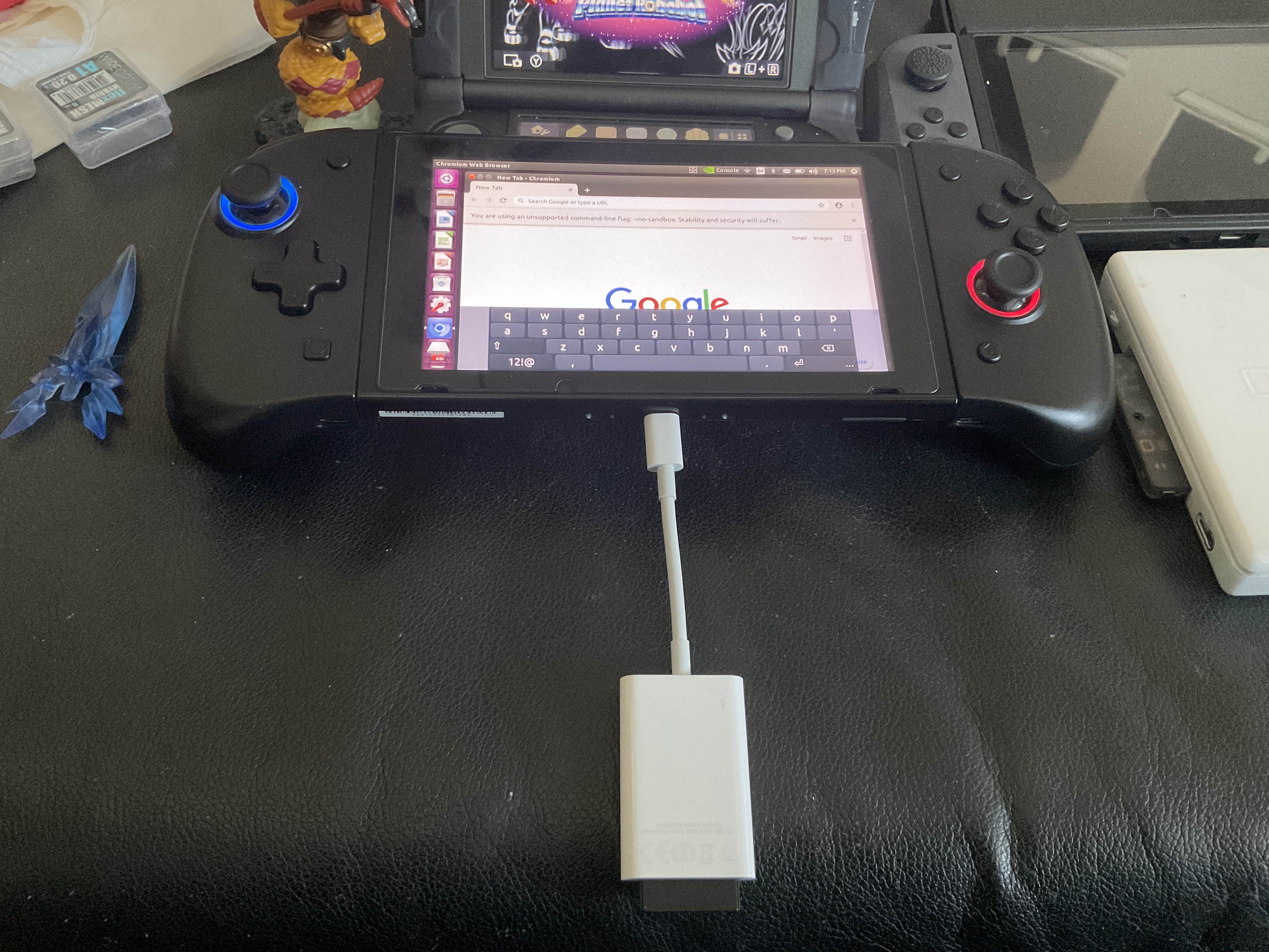

You can boot Linux also from a usb stick if you want. No need to reformat your SD card.

This is interesting. Do you just plug the USB into your Switch and reboot?
wow…I guess so! Neat! Going to try it.

it's pretty easy.
the boot files only have to be on the SD card.
the USB stick/HDD/SSD must of course be written with the l4t image. The whole thing is very well described in the Switchroot tutorial. or the instructions in German from me at psxtools. this is quite old but still works. If you have any questions, you can also ask here. Whit SSD in the usb3 port Ubuntu runs really fast.
To write the Ubuntu image to the drive etcher also works very well.

I have it running. Your instructions were perfect. Very cool! Thank you!
