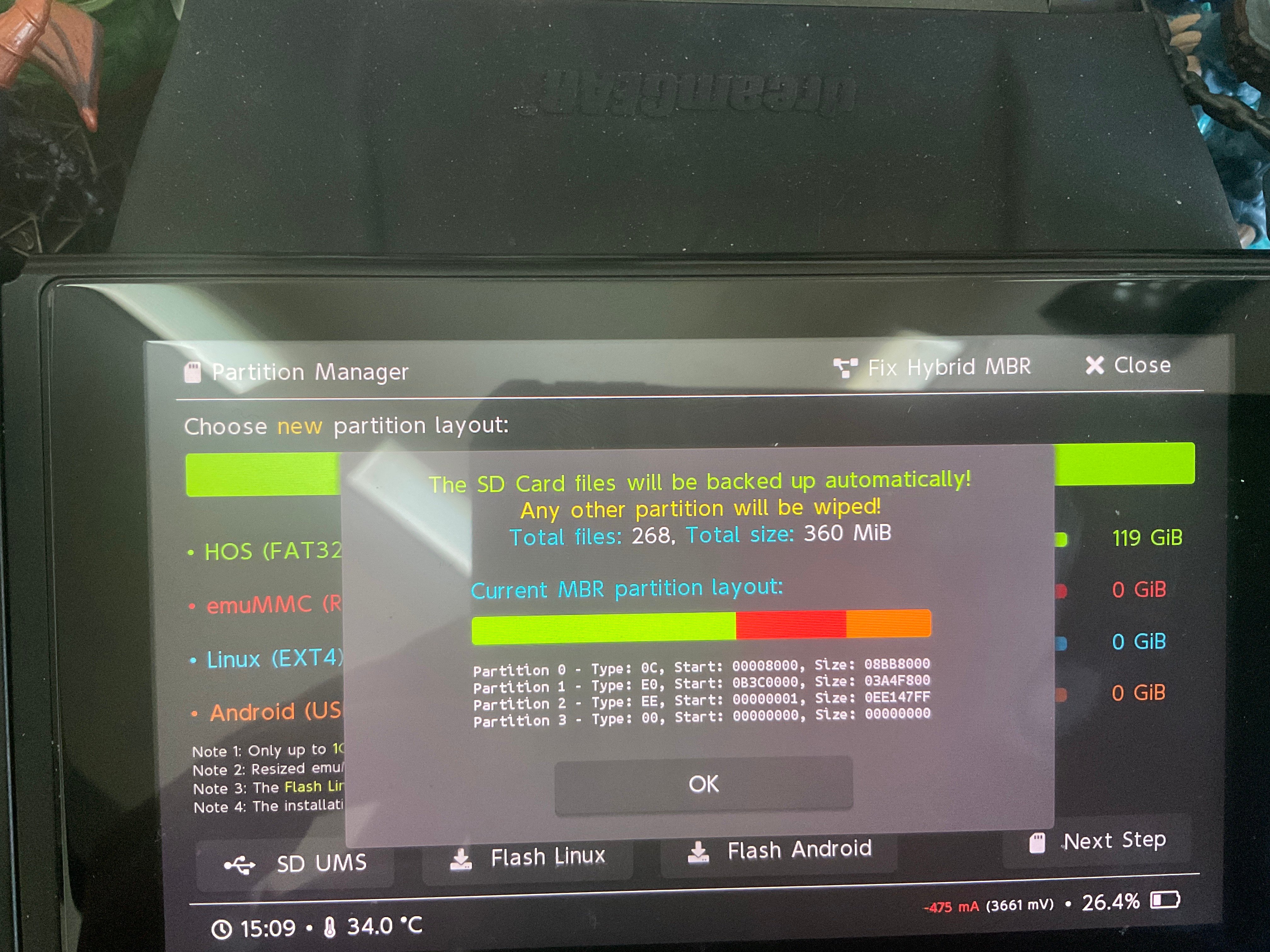

That one bit thing is not good. You might have a damaged SDCard reader.
Let’s hope not. Try reseating the card and going back into Hekate.
nope i dont think my SD Card Reader in the Switch is damaged, maybe its cause of giving a Letter to the Partition and that made Hekate crazy.
Reseating? What does that mean?
Typically you will see that notice if there is a miscommunication with the SdCard. If one of the electrical traces in the sd reader is physically broken it will do this, but it can also happen if one of the small connectors that touches the sd card isn’t quite touching and making a good connection. You can sometimes fix this by pulling the SDCard out and putting it back in so it will take a better “seat” in the sd card reader.

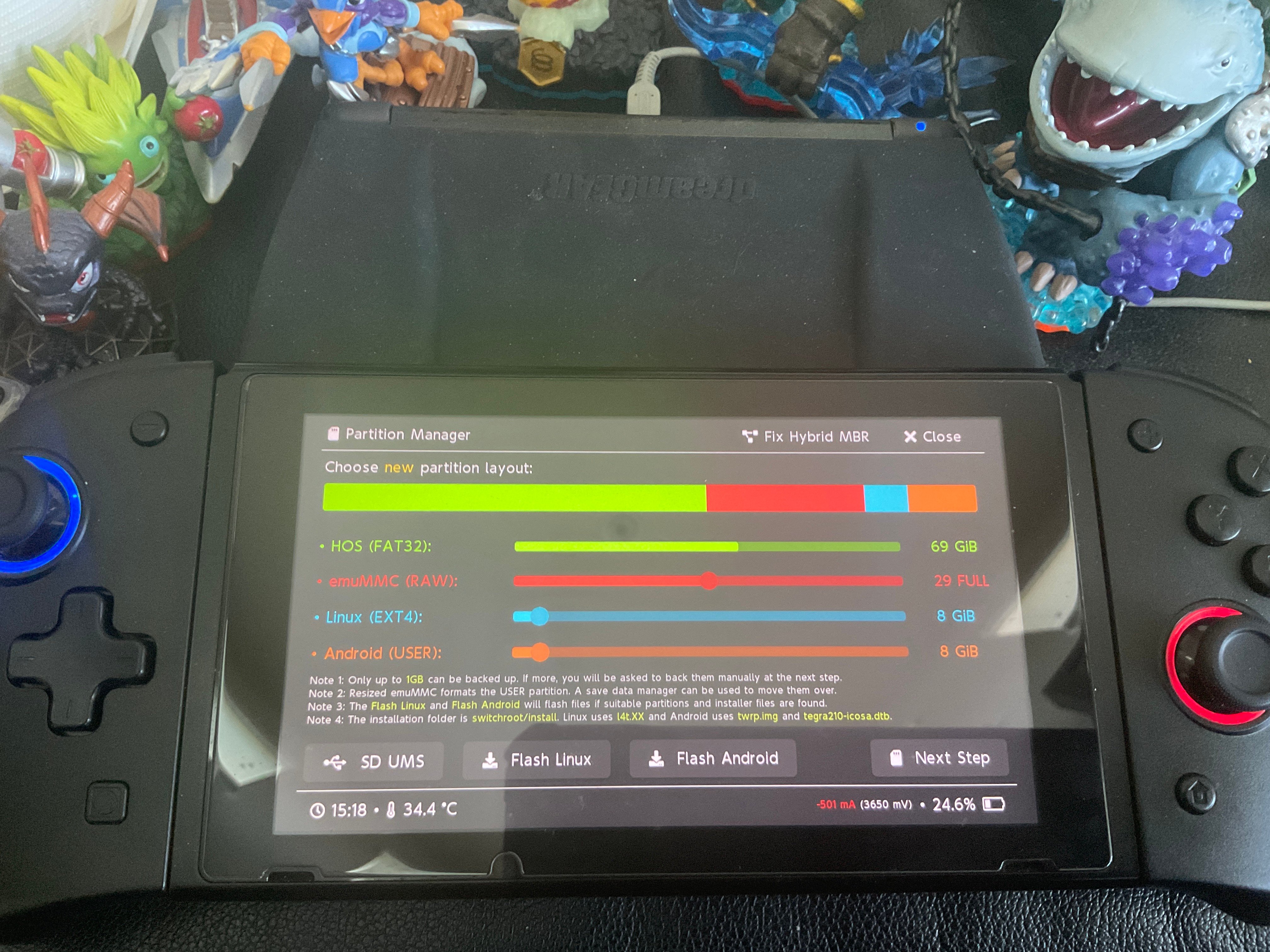

Oh damn, i checked my sd card with hekate and saw there isnt any blue partition, aaawww ... I got everything now ready and dont want to wipe everything again, so i will give it a try another time, but thank you thank you for opening my eyes! Next i can do it on my own, and maybe this helps other people by doing this 🥰🤙

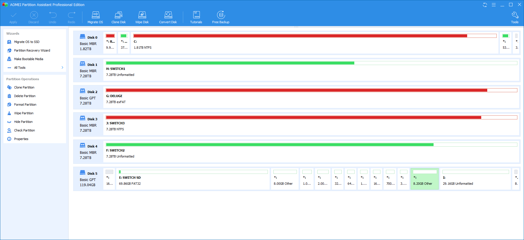

It won't show up in blue in Hekate. It will be part of the Orange (unformatted.) If you don't have a blank partition then L4T won't install. In other words the image files need a place to go and they will NOT overwrite your Android partitions. If the "Image L4T" button is enabled and pressable...it means you have the image files in the right place and an appropriate blank partition of the right size available, so go ahead and press it.
just remembered…the pics I shared earlier had all 4 partitions defined.
1) my partitions being set up
2) what those partitions looked like after it was done formatting.
3) What those partitions (with no blue in the second pic) looked like to another tool. See disk 5 with 2 x 8G partitions.
I believe you’re all set to give it a go.
