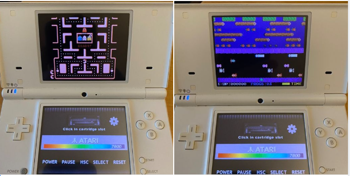

So I'm not ready for a new build (probably this weekend) but I've got some cool stuff coming.
I can now support the 2X bankswitched RAM scheme. This doubles the 16K of extra RAM available for games to use. Unfortunately, it's only used by one test/demo so far... but hopefully more games will support that in the future.
But the big change coming is a new way of handling the High Score Cart.
Hopefully you've been using the highscore.rom which is an add-on peripheral to support high score saving automatically by games that take advantage of it. There are already 50+ games that use it... including some of the classics. The problem is that the original standard only allowed for 69 entries which are chewed up rather quickly if you're playing a lot of the HSC supported games.
Last night I added an 8x density on the HSC by using virtual cart slots backed to a single 16K SRAM file. Each 2K SRAM slot is based on the first letter of the cart filename. The first time you run a game with HSC support and enter an owner-name it will replicate that (along with the magic numbers) across all 8 virtual cart slots. Similarly if you later change the cart owner's name, that gets replicated across all 8 virtual cart slots. The user is blissfully unaware - they think they have one save cart but under the hood it's magically spread out across 8 virtual high score carts.
In this way, the effective number of game entry slots is 552 though based on the game filename it's not quite evenly distributed. But it's good enough - and virtually ensures that we won't run out. The user should never even notice that this virtual cart swapping is going on under the hood.
