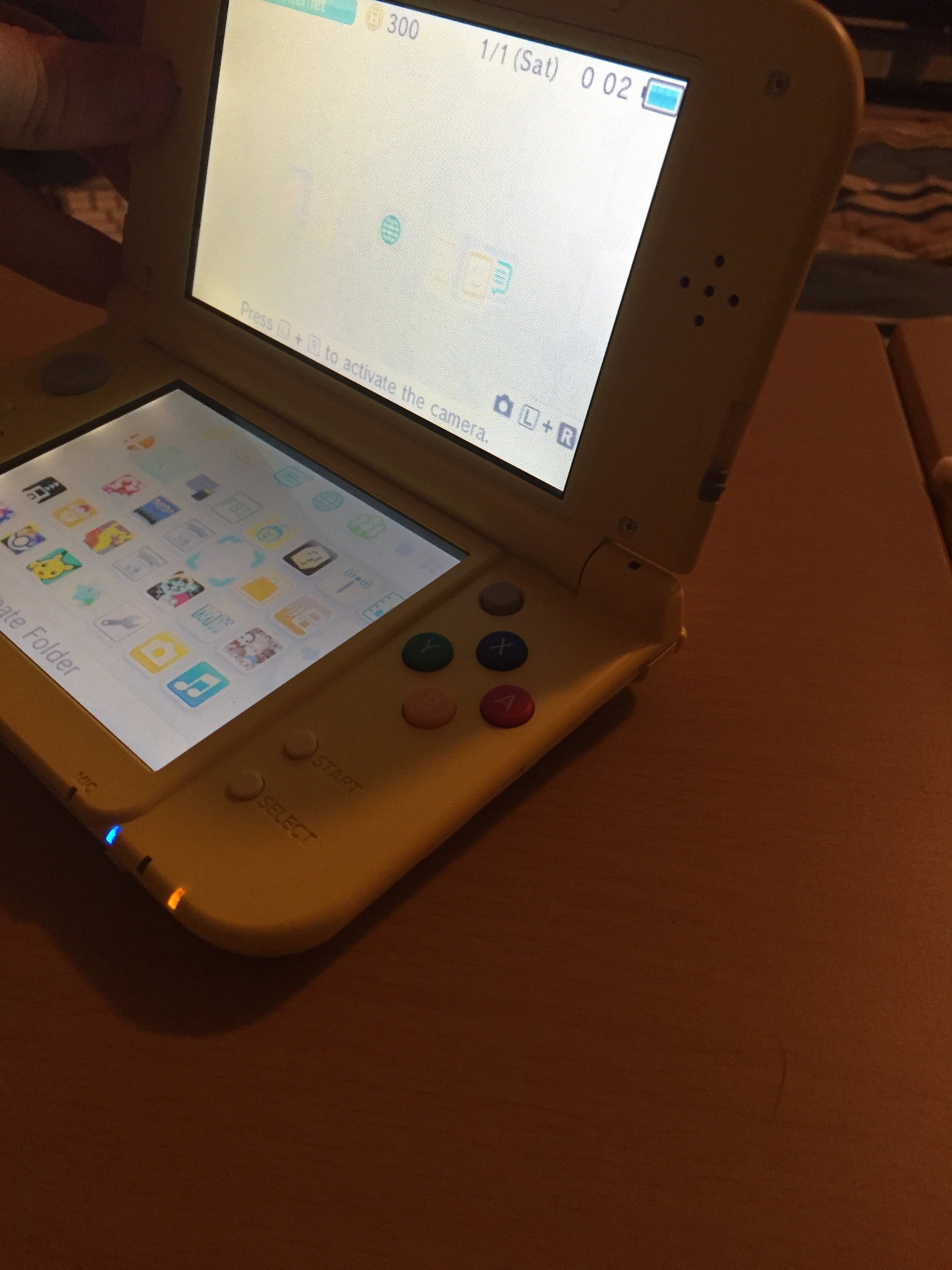

Update: i got the screen working, but now this is happening. some of the buttons are always being pushed without me touching them
