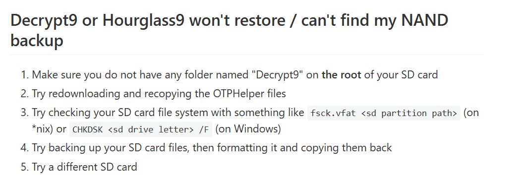

  4. Confirm and restore from NANDmin.bin NO USABLE FILE FOUND, I have the file in the files9 folder as per instruction.
Should the nand be in a different directory?
Is the .sha file in as well?
Yes, both files in /files9 directory.
NANDmin.bin
NANDmin.bin.sha
The countdown timer to reply to a post is a bit annoying.
Should I get my SysNAND backups again, or place them in another directory, or something else?
That's weird :huh:
This is all the files in the /files9 directory after my progress so far.
