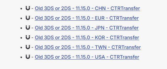

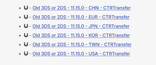

Thanks, I'll try CTRTransfer, since TWLFix didn't seem to do anything.
Quick question, if his 3DS is originally Japanese but he changed the region/language, do I download the Japanese CTRTransfer or the North American?
Might be a silly question but I've never messed with the region of a 3DS so I'm not sure how this works.
The Region Changing works with a CTRTransfer
So if you want to keep the North American region, you should use the USA CTRTransfer image
You can check what console he has by checking the bottom of the console. The product code should start with the console model and the region.
For example, a European original model 3DS will say 'CTR-001(EUR)'. https://www.3dbrew.org/wiki/Serials#Console_Serial_Numbers
Be careful when region changing the console as you can lose access to e-Shop and online features, or in worse cases, you can potentially BRICK the console.
Reactions: ChubSwagLad
