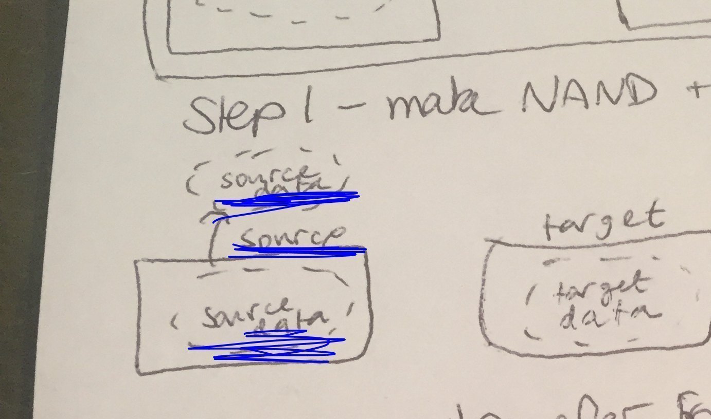

You seem to have trouble understanding so I drew you a diagram

See my diagram. I'm surprised you of all people didn't understand :-(
how can they make a nand backup of a console that is yet to be hacked??? the target???
SOURCE
TARGET is not yet hacked, thus it cannot have a nand backup
At no stage does the target need a NAND backup
SOURCE
Sorry. Somehow I'm missing something. I still don't get it. :( I'll check everything I knew so far.

That's ok the diagram is a little messy. I'll make it better and pm it to you
