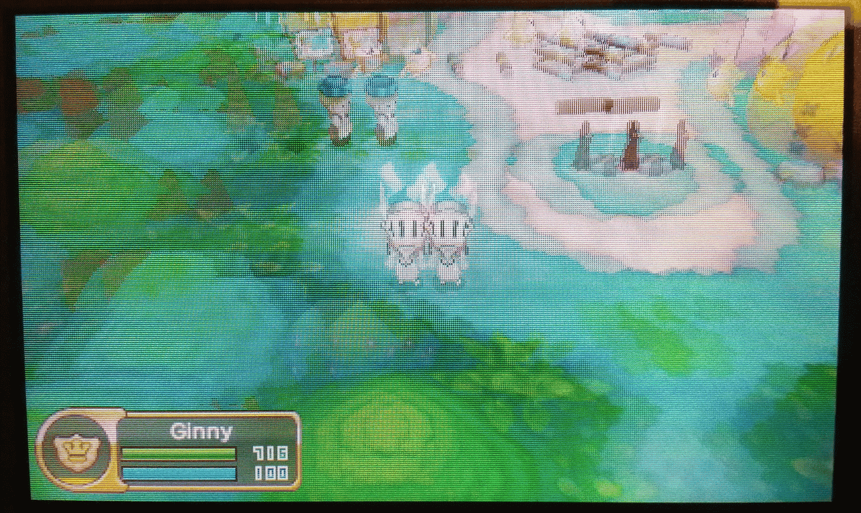

    Sorry for potato quality but here is what it looks like. Basically, no 3D at all, nothing directional, both eyes see two images.

    like using a 3d tv while you cant find the glasses for it

    It's just that you do not get a 3d effect but you get two pictures that are offset by a bit. Basically that's how 3d works anyway but it doesn't get rendered into one image until you close and open the lid again

    Lol, that's Fantasy Life. I chose that one for the photo because all objects are quite far from the camera (so you can see the effect very well), colors are well contrasted (it's not all dark) and, well, I have that game -.-
