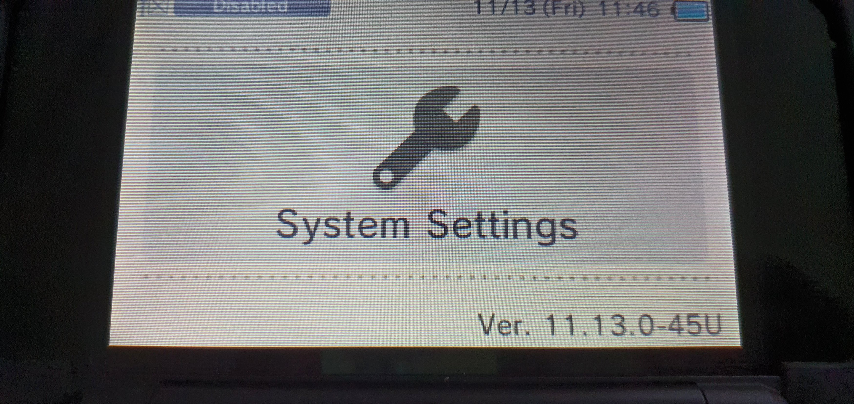

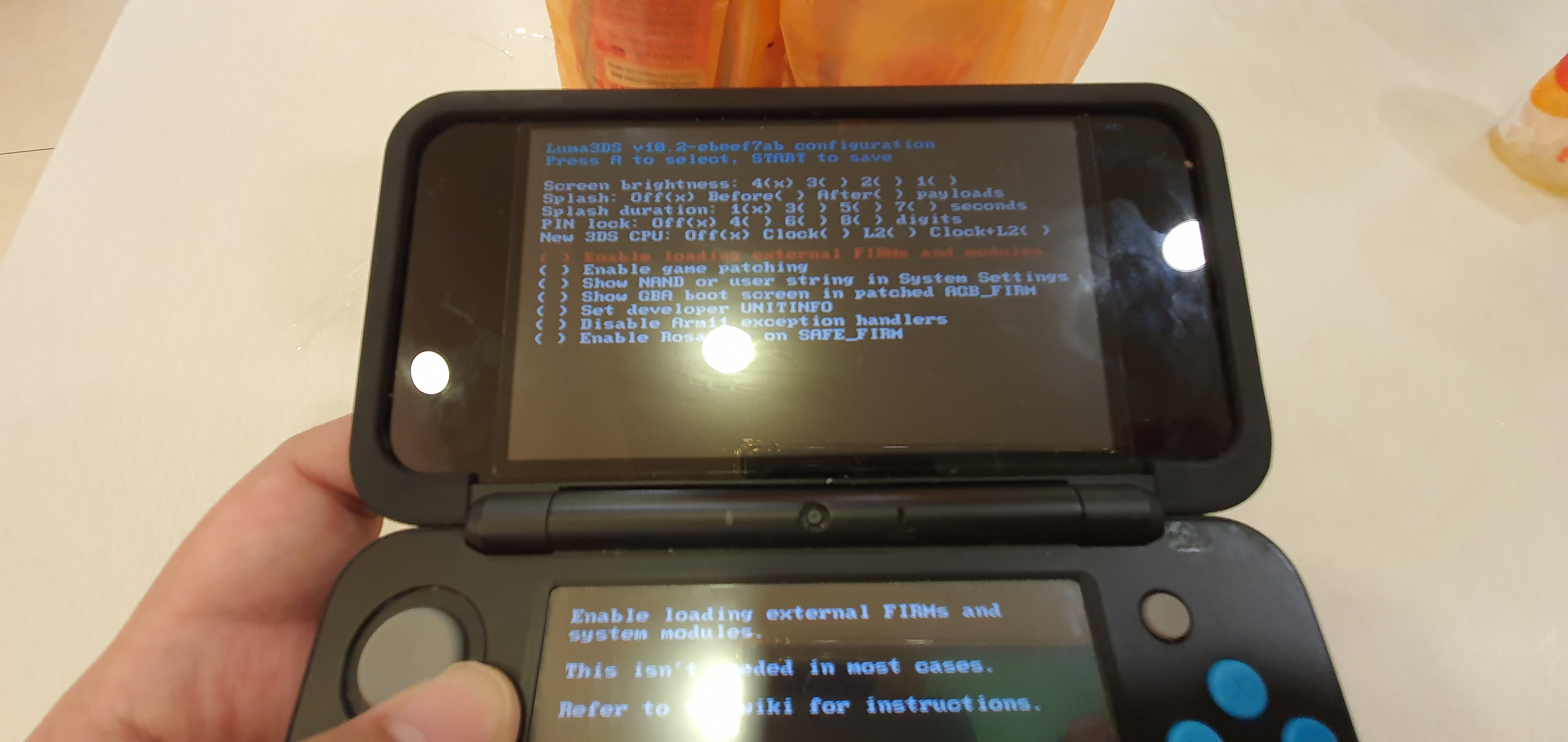

Noted. Here are the screens:
It says something about Luma? Is this the latest permanent CFW? Anything I should know or be wary of?
Oh, right, the NNID is of the previous owner, is it okay to perform a factory reset or something and sign in to mine?
Thanks.
Take out the SD card and make sure you can still boot.
If you can't boot, then you just need to copy Luma to the NAND (or update whatever version is already in the NAND). This is important so that the unit can still be used if something happens to the SD card slot. (It's very unlikely that something could happen, but possible.)

Thanks man, means I will unlink via System Settings officially. Also, as per kwyjor's post about removing the SD Card and booting up without it, I tried and the 2DS XL wouldn't load. Is that normal?
-snip-
That means the n2DSXL requires updating some CFW files on the SD card and/or CTRNAND.
Download Luma3DS v10.2, Homebrew Launcher v2.1.1, and GodMode9 v1.9.1; add these to your SD card. If there are newer releases of those files than the versions listed here, go with the latest available stable build. Any that are marked as pre-release may be used if no hiccups arise from normal usage.
  • sdmc:/boot.firm
  • sdmc:/boot.3dsx
  • sdmc:/luma/payloads/GodMode9.firm
  • sdmc:/gm9/scripts/GM9Megascript.gm9
Run this script function to update the CTRNAND Luma3DS and CTRNAND GodMode9.
For good measures, update the FIRM0/FIRM1 partitions to boot9strap v1.3 (ie, the backbone of the 3DS CFW magic).

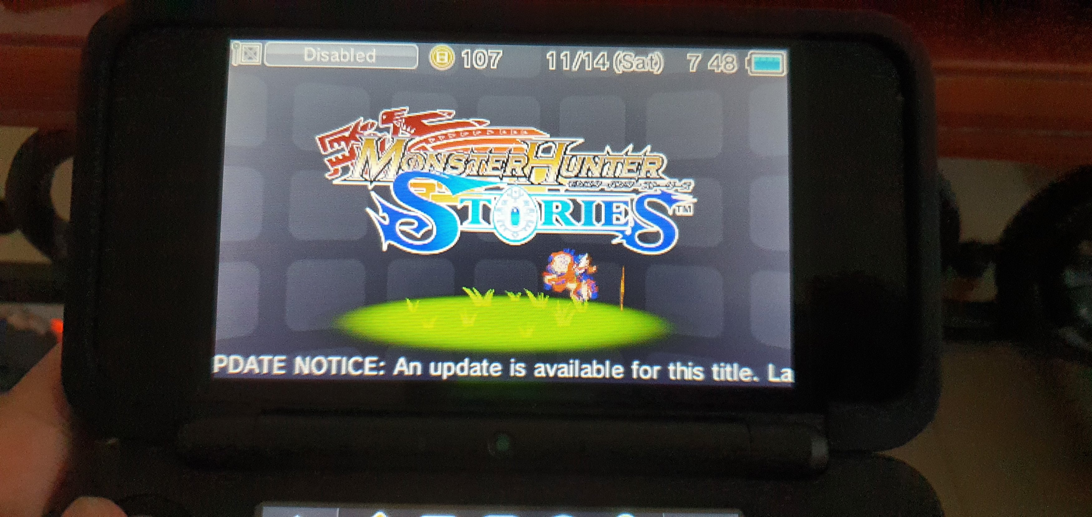

Managed to update CFW so the 2DS will work even if the SD card is taken out.
Only thing I have reservations to proceed is the updating of the BS to 1.3 as I purchased this from someone else I do not know if they have installed 1.3, any ways to check the version?
Also, just to inquire to be doubly sure:
I shouldn't update, right via conventional means, right?
Thanks in advance.
Only thing I have reservations to proceed is the updating of the BS to 1.3 as I purchased this from someone else I do not know if they have installed 1.3, any ways to check the version?[/USER]
There's no harm reflashing the FIRM0/1 partitions to boot9strap v1.3 even if it is already at B9S v1.3. As long as it's done through SafeB9SInstaller v0.0.7, that app will hash check the boot9strap.firm against its *.sha file to ensure it's safe to do so.
Or if you like, there is a way to check what version B9S is already installed.
It's fine to download the accompanying update title (0004000e) for a game (00040000) from HOME Menu or Nintendo eShop. If you're worried about installing updates for pirated game CIAs, Nintendo doesn't seem to care about the 3DS anymore. You won't get banned.
Keep in mind games can't be updated if your native 3DS firmware does not have matching region. Ex: Can't download the update title for Monster Hunter Stories (JPN) if your 3DS firmware is (EUR). Only way to update would be to download the update CIA from a website and install it with FBI.
