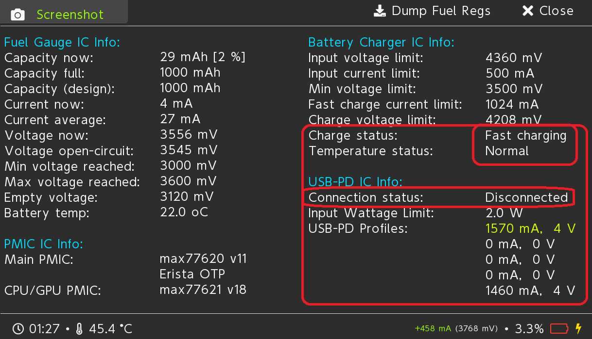

hey guys,
im getting a 2101-0001 error message. After replacing m92t (multiple times
), bq24 and pi3usb it wont disappear. I can boot into hekate, but as soon as i try to start something this message pop up.
- no shorts around chips
- 0.46 amp consume, doesnt switch to fast charging
- android with wifi and bluetooth is working on this switch btw
i replaced the cpu once, but atmosphere had problems to see the SYSTEM partition. got a "NXBOOT SYSTEM Partition must be corrupted" message. It pops up if the loader isnt able to get the Contents folder of SYSTEM partition. But with nxNandManager im ablet to mount this partition and see the contents folder
Later i placed the old cpu back and got the 21001-0001 error again.
Now im lost to get this console working again and hoping for some ideas
