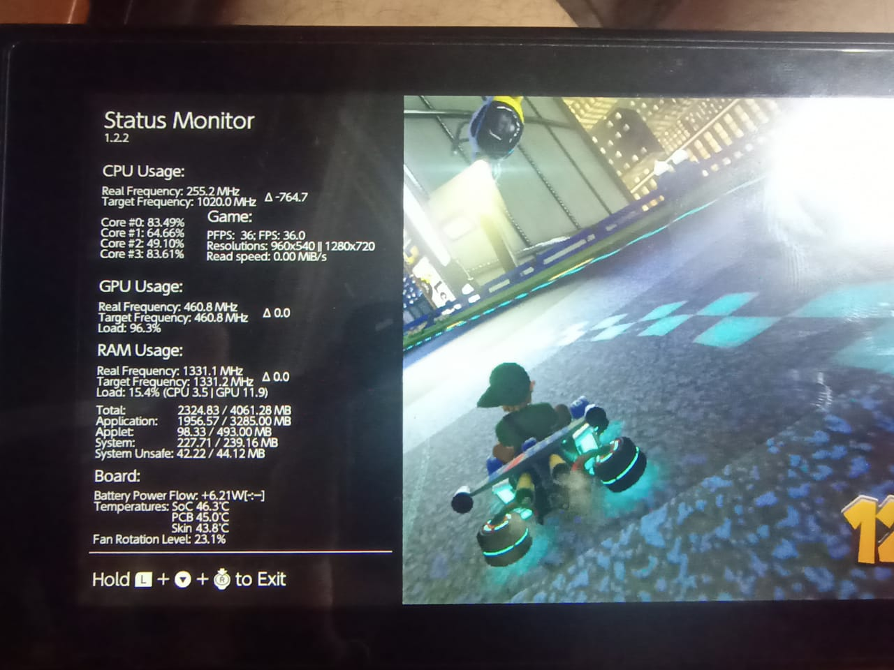

This also happens in stock (before and after hack) and make every game unplayable.
Here is Tears of the Kingdom with this problem, gpu is at 99% and game runs at 10-15fps
The "Real Frequency" on your CPU is low. In fact, based on both screenshots, it's effectively at 25% of the target. Got any homebrew or processes intended to adjust the clocks? Have you tried a clean Atmosphere and then adding things one by one to see what could be affecting it?

Doing some tests, the reason for all the lag must indeed be the CPU frequency, which always seems to be proportionally below the target (if I lower the overclock to 1224 MHz, the actual frequency drops to 303 MHz for some reason)

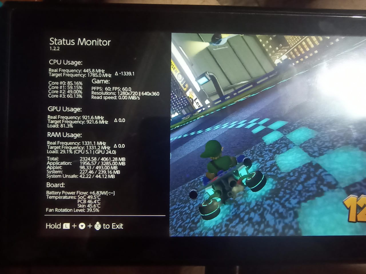

There is Status Monitor when I connect it to the official charger (Full overclock)
And without any overclock
The behavior is very similar in dock, but with worse performance (due to resolution, i think)

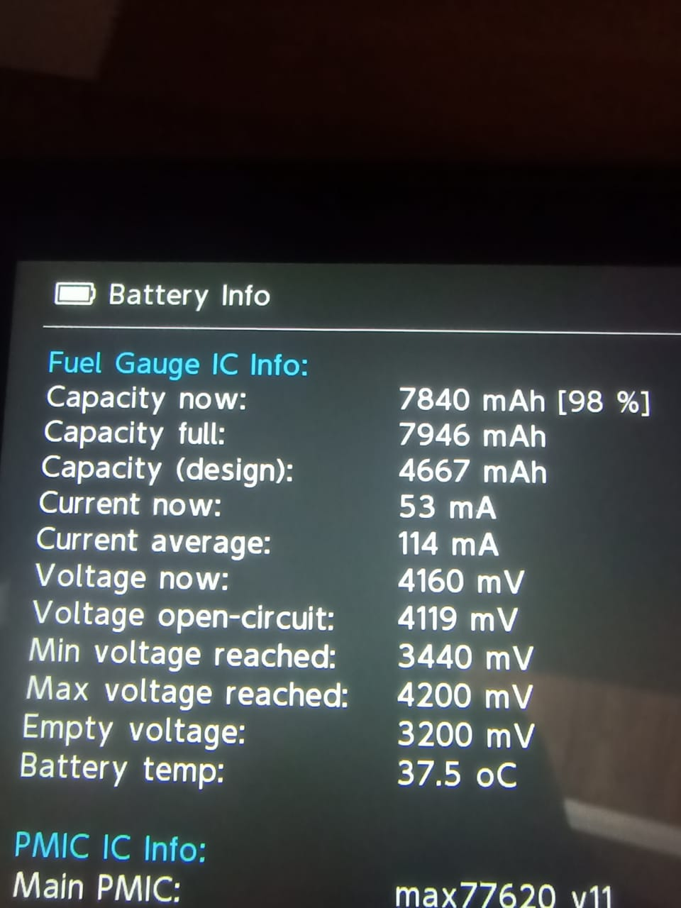

Looking at Hekate Battery Info, i see that battery capacity shows... 7946 mAH? Is this normal?
Wow, is that even possible? I should ask my friend about this. So, can a battery replacement solve this?
It may be that while installing this battery damage has been done. So i am really sceptical this alone will help.
Yeah, that makes sense. Then, I'll take the console to a technician to diagnose the problem and see, if it's a hardware issue. I opened the console but didn't see anything I could fix myself.
