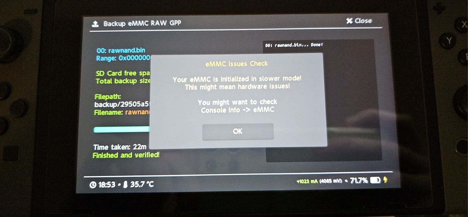

I tried launching the payload, I pasted everything from the "justinsertthisstuff" Package to the root and launched. First it showed me an error ans now the hekate menu. Should I try to launch it?
It says warning: Nyx is missing
I've never heard of that and combined that with the fact that its already giving you issues, I would recommend avoiding using it. Delete anything you downloaded from it as well as anything you put on your SD card and start fresh by following this guide.
