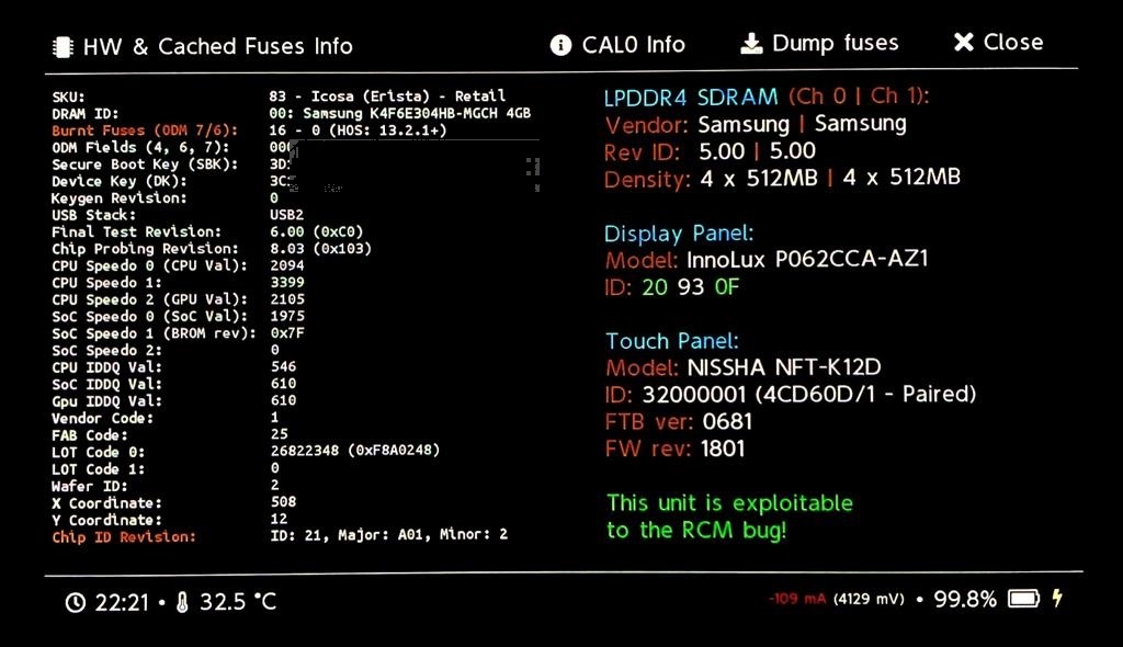

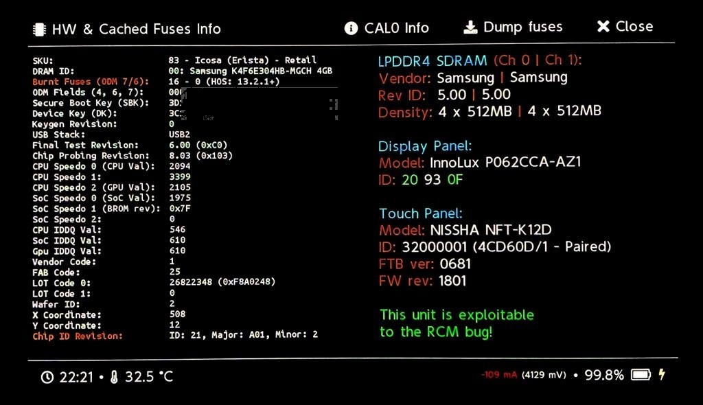

also idk if this would help but this is my console info:
This is perplexing. I think we need to go nuclear and just get you in a good state.
Please move/rename /atmosphere to /atmosphere.bk and /bootloader to /bootloader.bk and then:
Do this: https://rentry.org/EristaEmuNAND
Followed by this: https://rentry.org/ExosphereDNSMITM
Copy your /bootloader.bk/hekate_ipl.ini to /bootloader/hekate_ipl.ini and reboot/select [CFW (emuMMC)]

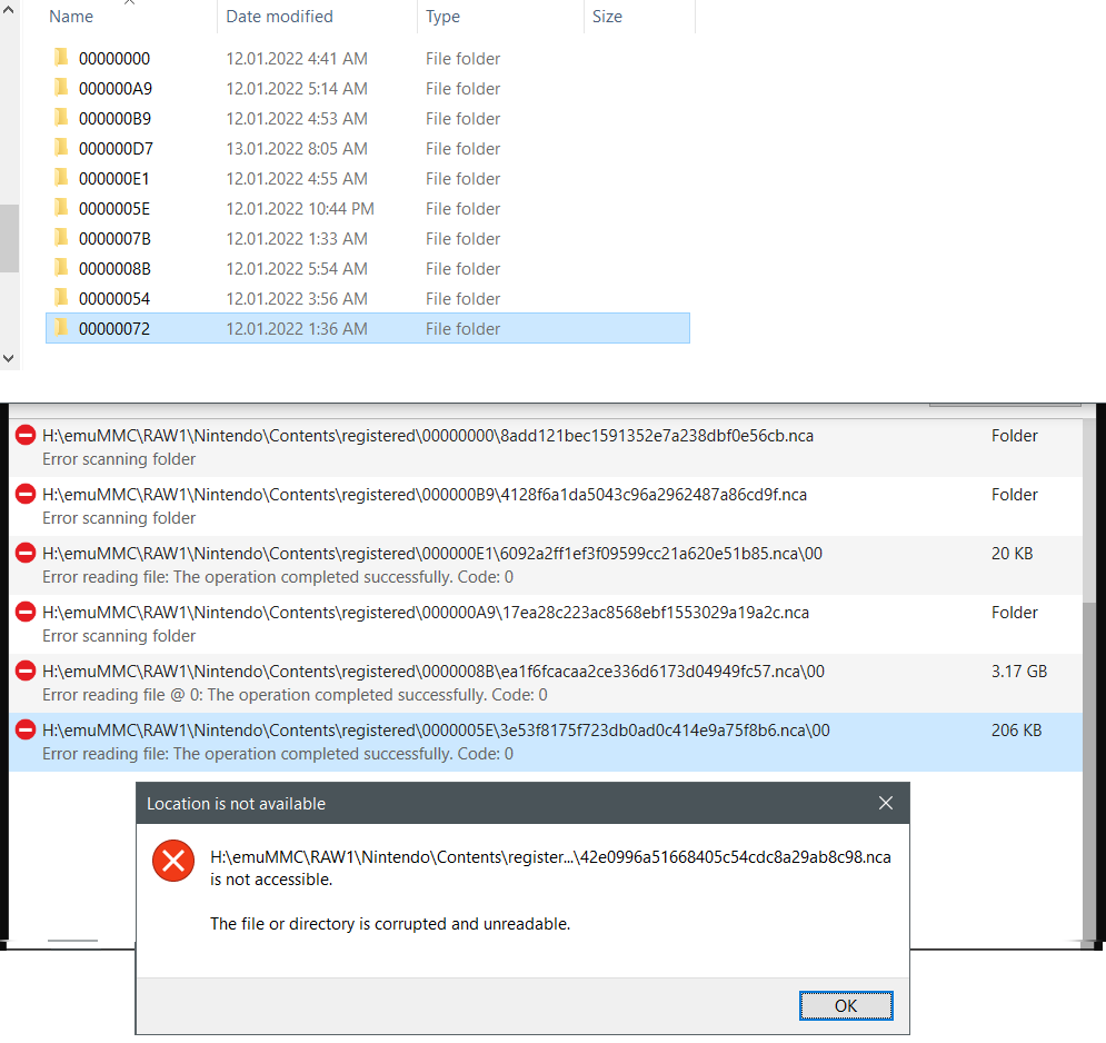

ok thnx a lot, I'm backing up now 294GB from SD will take 3~4 hours. also during copy I've realized there was a weird folder structure issue in the following location.
however, I tried booting after moving just the 0000004F folder but nothing changed.
I'll post the result after getting a new SD structure.
Yeah, that’s not a great sign. We might be going deeper after all. We’ll cross that bridge when we get there…

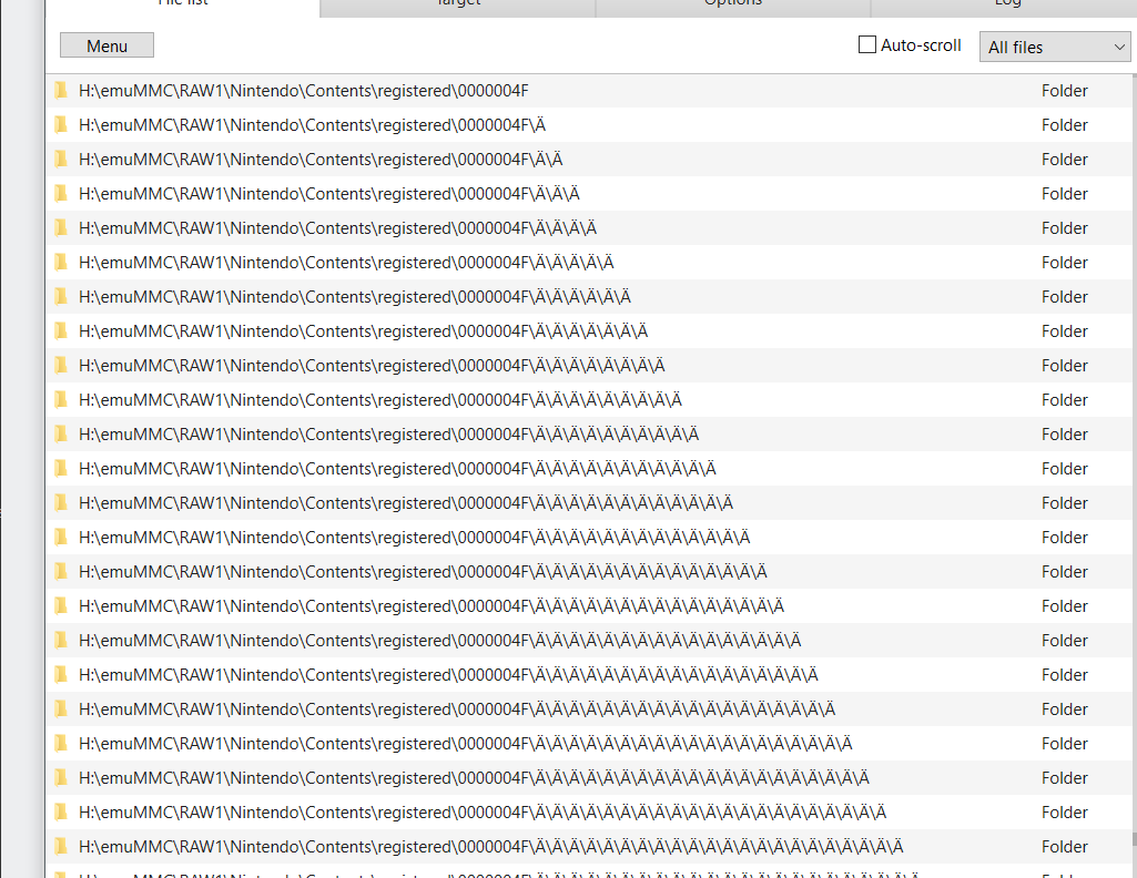

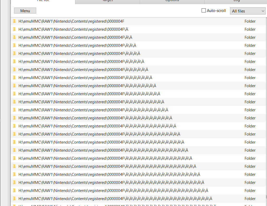

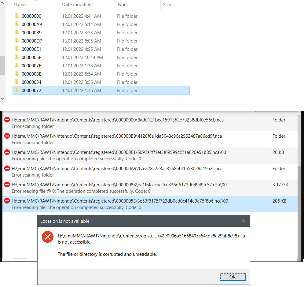

seems like a corruption issue :-(
some folders aren't even accessible.
so after realizing this, I ran a file recovery on the SD card on the relevant 11 folders in 'H:\emuMMC\RAW1\Nintendo\Contents\registered' with "active @ file recovery" and I was able to recover all folders except the folder called 0000004F.
Now the problem is that the SD card only has the emuMMC folder with 11 problematic folders and I can't even delete them.
So I tried DiskGenius v5.4.3.1342 Pro to delete the folders. It said the partition was damaged and it needed fixing before deleting anything. I tried recovery again with DiskGenious in hopes of recovering the 0000004F folder, it didn't work and it got stuck at some point (just like switch)

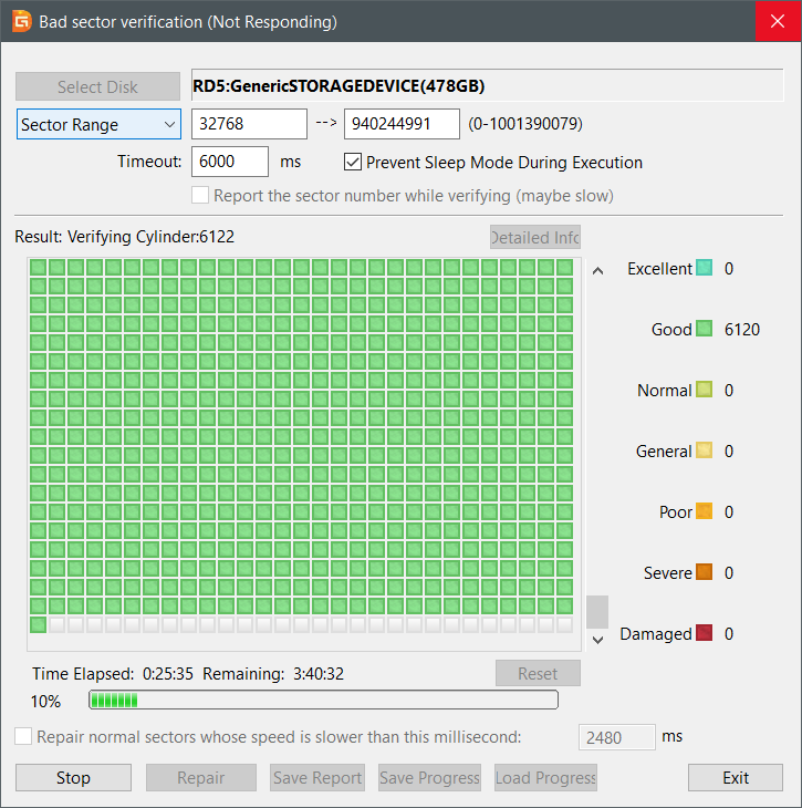

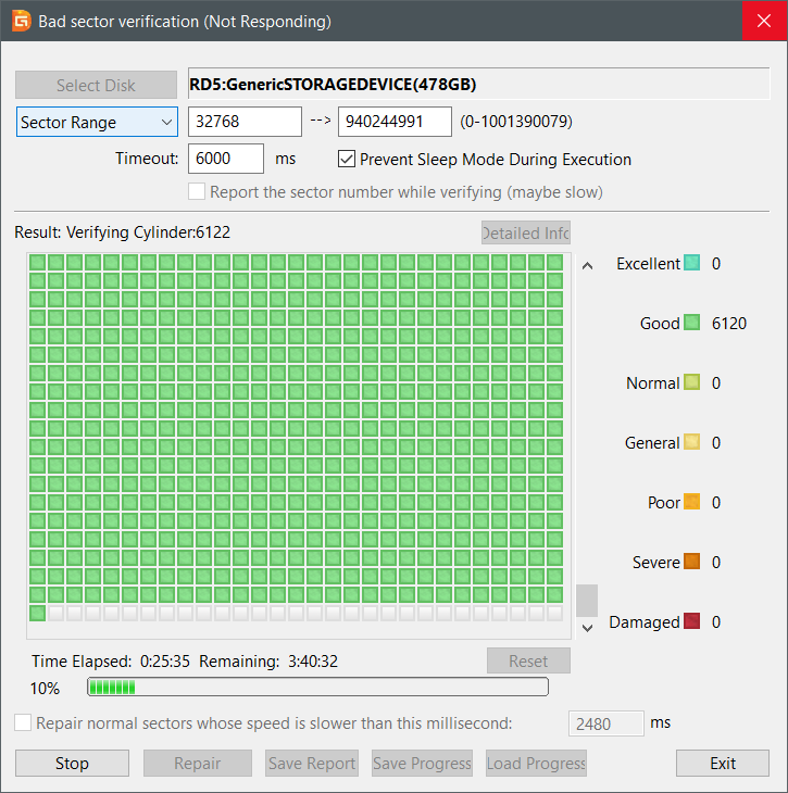

So I decieded to Fat32 format it with DiskGenius. That worked. Then I initated a check / verification on every sectors on the SD card with DiskGenius. Unfortunately that gets stuck after 25 minutes too. I will try to fix the SD card somehow or the SD card is badly damaged :-(
I wonder if this happened during tinfoil download when system went to sleep and had to do a shutdown to fix it?
Yeah, this Is the worst case unfortunately but I’m sure you’re already familiar with where we are at this point.
You might want to try h2testw (it’s a destructive test btw)
We can try to format to FAT32/32k blocks with rufus or the tool of your choice but we might be looking at a new card. (let’s hope not.)
It could very well have happened during a sleep when it was writing to disk but we’ll likely never know for sure.
