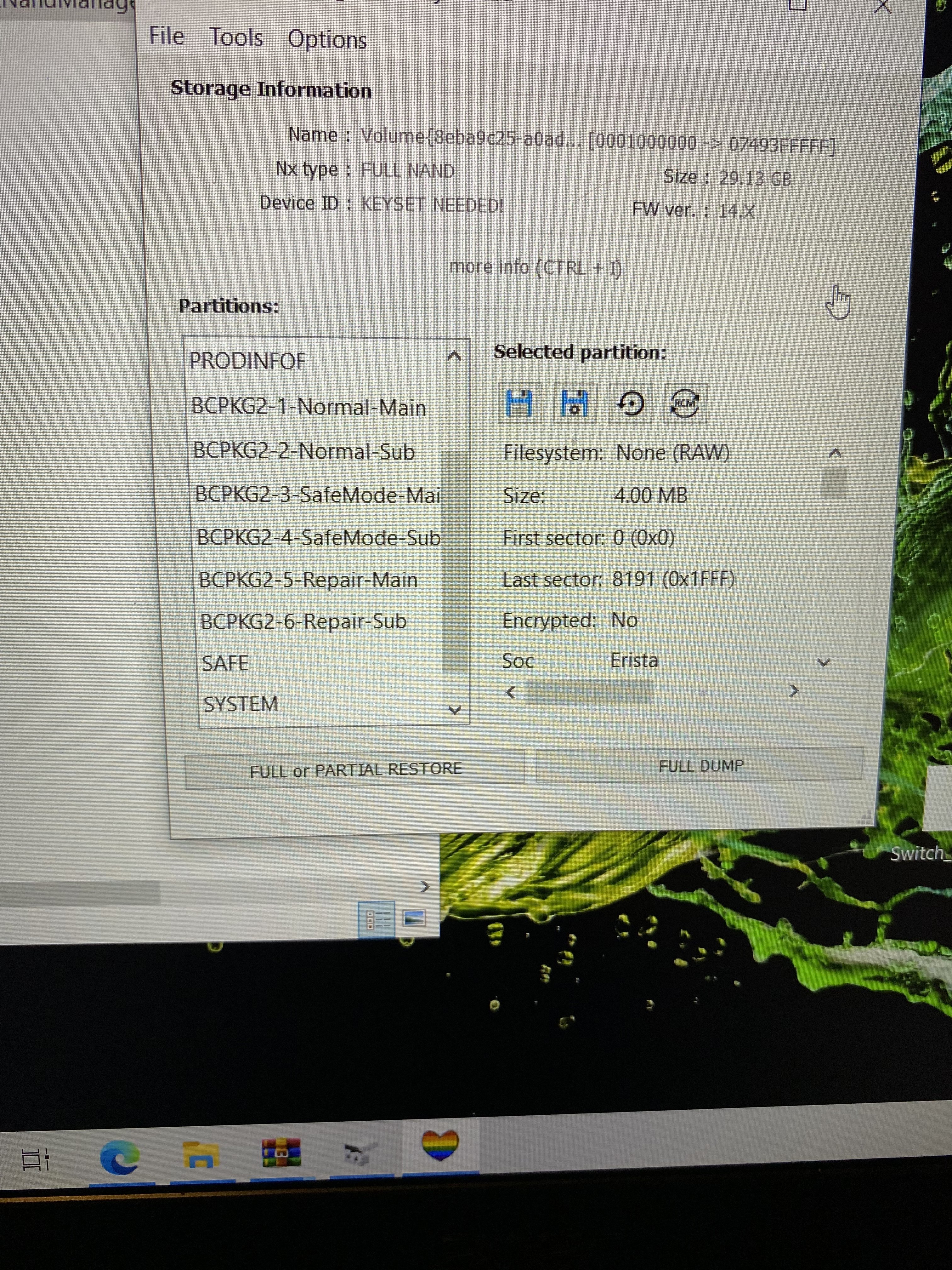

What am trying to do with nx nand manager
We are simply confirming wether or not there is an emunand on your SDCard. I’m glad we did this because what you‘re showing what looks like a perfectly good emunand.

Should I pick sd card or nand ?
I use atmosphere and emunand
