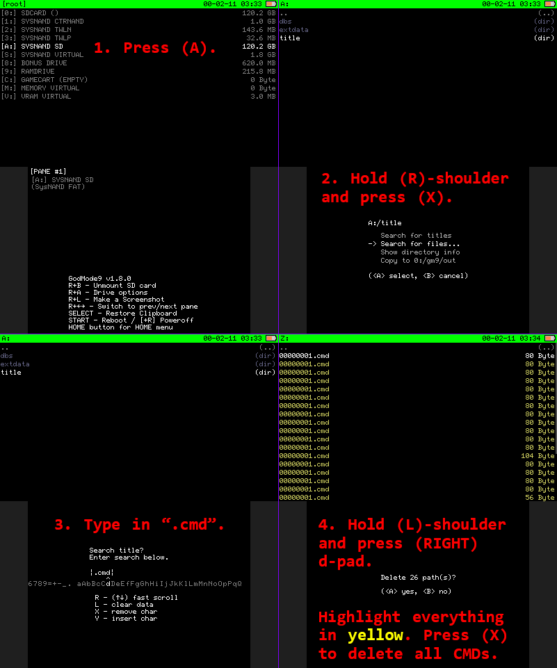

Hold the L-shoulder button and highlight select everything in yellow to do mass CIA building.

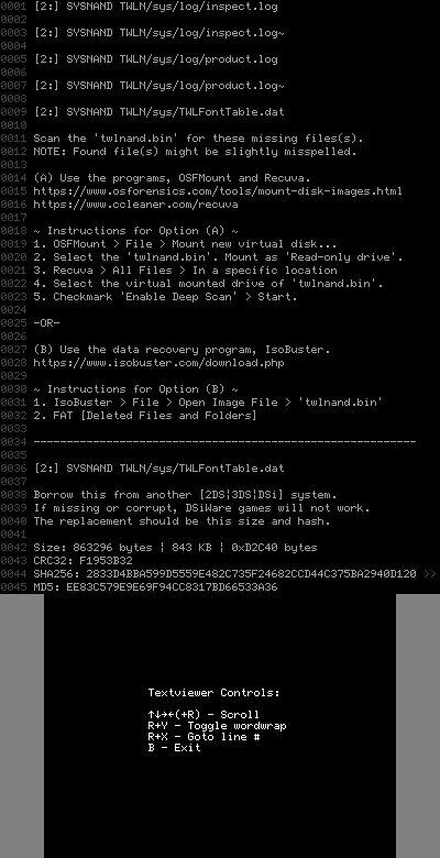

  27. Rebuilds the S:/twln.bin partition; reformat the [2:] SYSAND TWLN(AND) drive.
    • Console unique TWL nand files such as inspect.log(~), product.log(~), sysmenu.log, TWLFontTable.dat, opera.ini, and 0000 are retained.

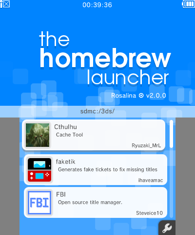

  12. Open the Nintendo 3DS Camera to access Homebrew Launcher. If region changing the 3DS firmware and there are no system titles shown in HOME Menu, press the { (L)-shoulder + (R)-shoulder } button combo to launch the camera applet → Nintendo 3DS Camera Homebrew Launcher.

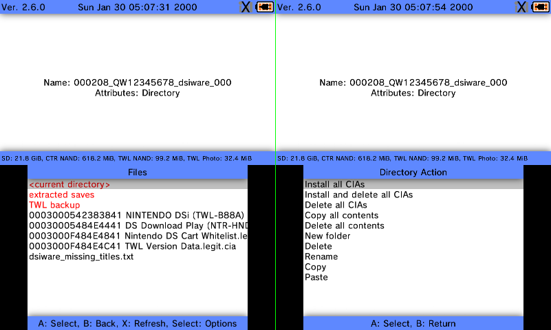

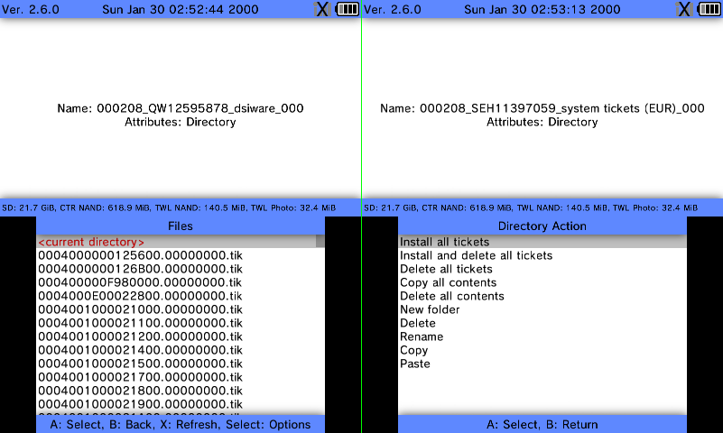

  13. Install the system tickets and DSiWare CIAs with FBI. Restore missing tickets for nonlegit titles with faketik. If you have a lot of games, mass unwrap them all with Cthulhu.
      • The tickets and CIAs folders are named in the following formats found at sdmc:/gm9/out/
        • <date>_<serial>_dsiware_000
        • <date>_<serial>_system tickets_(<region>)_000

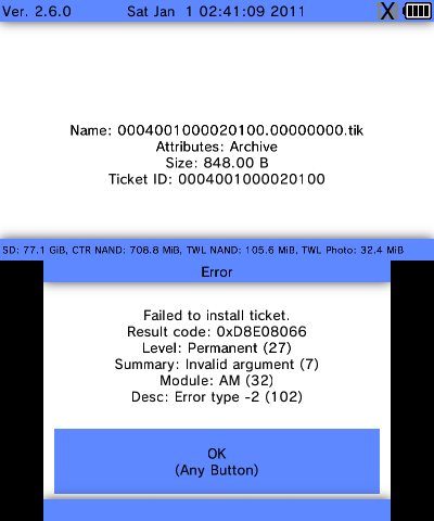

      • :!: See the FBI errors 0xD8E08066, 0xD8E0806C, and 0xD8E0806A section found below if the tickets or CIAs fail to install.
    • restore_nonlegit_titles_tickets-png.210822

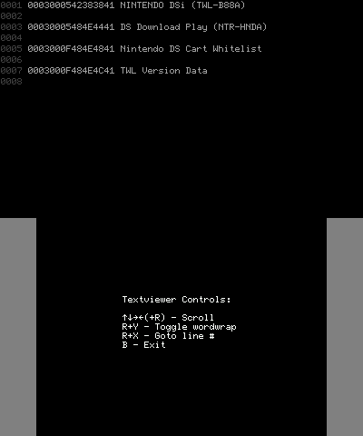

      • 00048005484E4441
        • DS Download Play
        • Version: 1024 (1.0.0)
        • Product Code: dlplay
      • 0004800542383841
        • Nintendo DSi™
        • Version: 2048 (2.0.0)
        • Product Code: DS INTERNET
      • 0004800F484E4841
        • Nintendo DS Cart Whitelist
        • Version: 11264 (11.0.0)
        • Product Code: <blank>
      • 0004800F484E4C41
        • TWL Version Data
        • Version: 0 (0.0.0)

Conditional: This last step depends if the [2:] SYSNAND TWLN was found to be missing console unique files.
17. Image mount the twlnand.bin and run a data recovery to retrieve lost or deleted files listed in the twlnand_missing_files.txt.
  • Option (A) OSFMount + Recuva
  • Option (B) IsoBuster
  • sdmc:/gm9/out/<date>_<serial>_dsiware_000/TWL backup/twlnand.bin
  • sdmc:/gm9/out/<date>_<serial>_dsiware_000/TWL backup/twlnand_missing_files.txt

  • 0xD8E08066 - The system tickets may fail to install due to something called the certs.db (certificates). Your setup at one point either corrupted it or erased & regenerated that file with a dummy nonfunctional copy. A replacement copy borrowed from the CTRTransfer image would then be required. The script can replace that file if you come across this issue. Do not use this option if the problem doesn't exist; certs.db is partially involved with transiting 3DS online play.

    • DSiWare CIAs & SavesConvert CIAs (legit to standard)
    • Install the files in '3. cias (converted)' first followed by '5. tickets (legit)' to retain your private legit dsiware tickets.

  • GodMode9: They can still be found when doing [A:] SYSNAND SD → Hold (R)-shoulder and press (A) Search for titles...

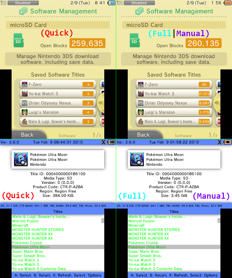

Option (A) - Quick
The fastest of the three where dummy CIAs are generated, and all installed titles (saves included) are relocated offside to a temporary title_<ID0> folder. Once the dummy CIAs are installed:

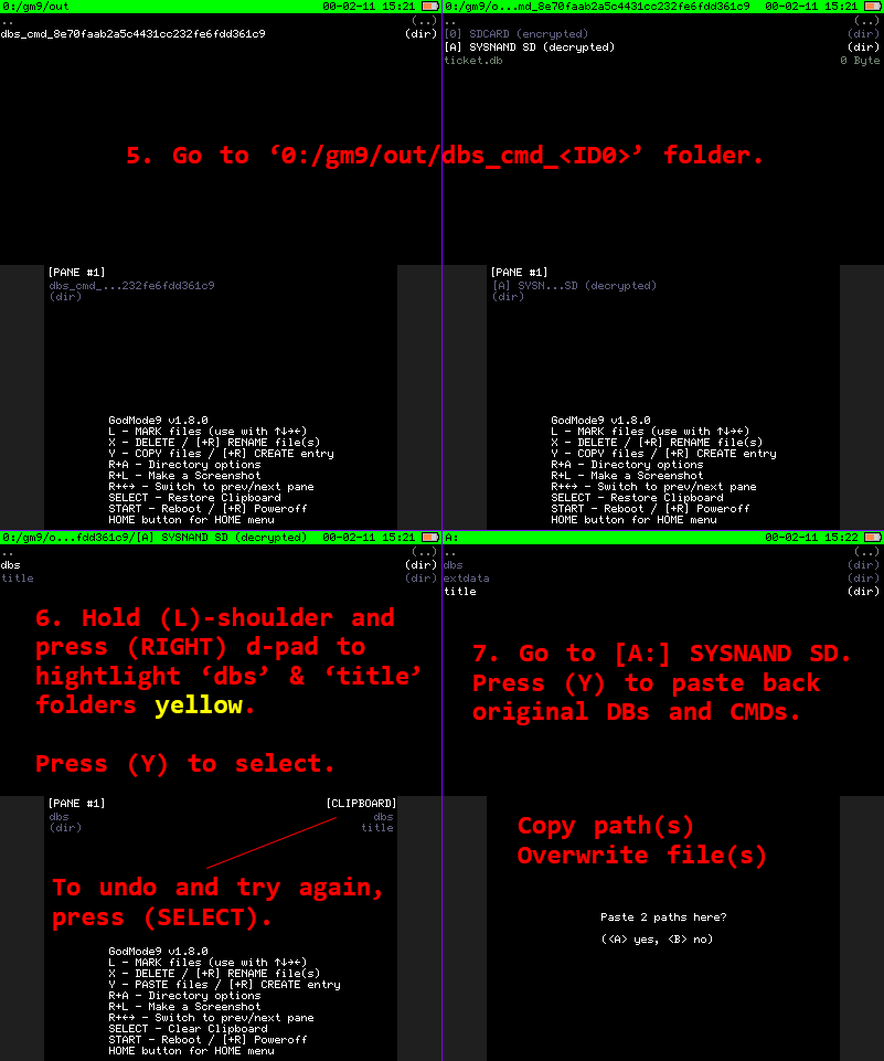

  1. The original ticket.db is restored to keep the user's real tickets in place.
  2. To prevent accidental reinstallations of the dummy CIAs, the cias (dummy)_<ID0> folder is deleted.
  3. The titles are moved back to the title folder.
  4. Their individual *.cmd header CMACs are corrected.
:!: A minimum 256 MB of free space is required when making the dummy CIAs.
:!: Installing dummy DLCs with lots of contents can make FBI appear to crash or become stuck frozen. However, the progress is rather really slow for these titles. Look at the top row's moving clock for proof; be patient and don't force shut off!
:!: The sizes and blocks will be reported wrong in FBI and System Settings. There's no away around this annoyance except to use or redo rebuilding the database with one of the other two options.
:teach: If curiosity got the better of you, where you completed both parts (1a) Generate Dummy CIAs and (2a) Restore Setup, and you want to restore your SD setup just like how it was before having started Option (A), this is entirely reversible with the backed up files found in dbs_cmd_<ID0> folder.

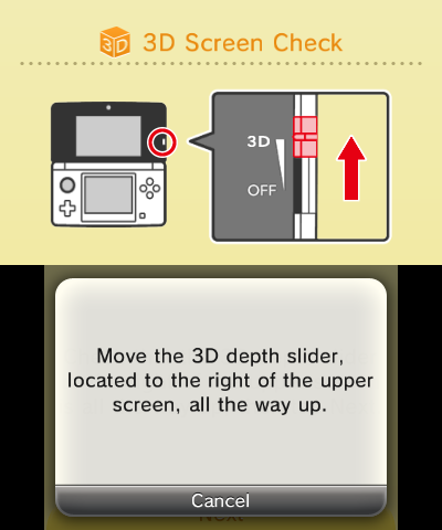

3DS systems that have broken 3D slider switch will get stuck at the 3D Screen Check after performing a system reformat.
  • System SettingsOther SettingsFormat System Memory
Those who have hacked their o2DS by following outdated 2.1.0 CTRTransfer downgrade guides may also get theirs stuck at that screen, albeit with a distorted appearance.
This pitfall scenario can be skipped with this script. Once HOME Menu is reached, filling out personal information and user agreements is still mandatory for access to online services and system updates.

  3. Strange '?' files that are stubbornly stuck in CTRNAND or cannot be deleted/replaced by conventional means.
    • Despite H2testw checking the SD card for issues, updating the custom firmware & 3DS firmware, and troubleshooting for any and all hardware issues, your system has unexplainable boot issues, poor GUI functionality, or random crashes. You (surprise, surprise!) don't have the benefit of a clean, backed up SysNAND *.bin image to recovery from. Attempts at using standard CTRTransfer are not providing favorable results. You may very well have a broken file allocation table at hand. If those damaged files are limited to replaceable or non-unique items, this script will try maintaining anything that's salvageable.

  19. Restores the user's setup back to the CTRNAND drive, except for certain *.db files.
  20. Image mounts the backup essential.exefs and restores any of these five if missing.
    • LocalFriendCodeSeed_B, HWCAL0.DAt, HWCAL1.DAt, movable.sed, SecureInfo_A

  24. Asks to Rosalina menu inject Homebrew Launcher to Nintendo 3DS Camera.

  1. Copy everything off your SD card onto a computer.
  2. Test the empty card for hardware problems with H2testw (Windows), F3 (Linux), or F3X (Mac).
    • :!: A fake or faulty SD card will cause a secondary brick where the user's setup is permanently corrupted when backed up.
  3. Delete the *.h2w test files if the card checks out fine. If the card was found to have issues, replace it and go back to step 1.
  4. Either move back your main setup or create a temporary test setup on the card.
    • (1) (Optional) Here's a starter kit for reference and convenience.
    • (2) Your setup must have GodMode9 (v1.7.1 or newer) and the 3DSX versions of FBI, faketik, and Cthuhlu.
    • (3) The script requires a minimum 1 GB of free space.
  5. Put the CTRTransfer files of choice at:
    • sdmc:/gm9/in/11.5.0-38X_ctrtransfer_x3ds.bin
    • sdmc:/gm9/in/11.5.0-38X_ctrtransfer_x3ds.bin.sha
  6. Put the script at:
    • sdmc:/gm9/scripts/CTRTransfer (Type D9).gm9
  7. Unless it's really bad, backup the SysNAND for extra safety even if it is currently bricked.
  8. GodMode9 → (HOME) button → Scripts...CTRTransfer (Type D9).
    • The rest of the script will be self-explanatory.
  9. During script run, :!: do not press and hold the (B) button when the DSiWare games are being dumped and especially for the system tickets.
    • These are the two sections I could not idiot proof. If you try to cancel building a DSiWare CIA, it'll ask you to try again with the choice to cancel. For the system tickets, the script will fail to completely mount ticket.db.
  10. If region changing the 3DS firmware and there are no system titles shown in HOME Menu, launch the camera applet → Nintendo 3DS Camera → Homebrew Launcher.
  11. Install the system tickets and DSiWare CIAs with FBI. Restore tickets for nonlegit titles with faketik. If you have a lot of games, unwrap them all with Cthuhlu.
  12. Update to the latest firmware version in Recovery Mode or System Settings.
  13. Go back to the script to restore the DSiWare saves.
  14. See if the DSiWare games launch with their saves. Check if DS(i) mode is broken. You may need to follow up with:

FBI errors 0xD8E08066 and 0xD8E0806C
  • 0xD8E0806C - The backed up DSiWare titles may fail to install. This is likely to occur if the CTRTransfer was used to region change the firmware. To fix this, install a different DSiWare *.cia file that's not from that backed up set. I have no clue why this hiccup occurs...

    • CTRTransfer makes TWLN titles forgotten due to changing out the title.db.

    • For firmware 11.9.0-42, the TWL_FIRM should be:
      • 0004013800000102
        • Old_3DS TWL_FIRM
        • Version: 10864 (10.39.0)
        • Product Code: CTR-P-CTAP
      • 0004013820000102
        • New_3DS TWL_FIRM
        • Version: 10962 (10.45.2)
