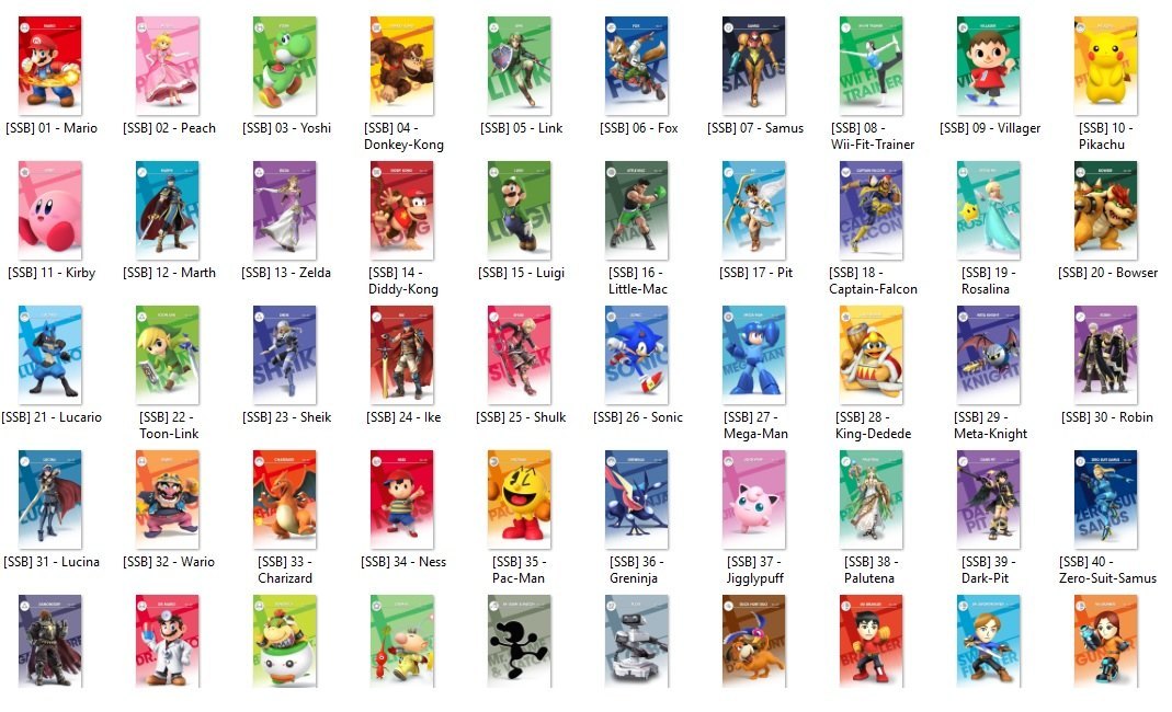

Super Smash Bros. cards in PVC size.
I modified the Super Smash Bros. cards to PVC size.

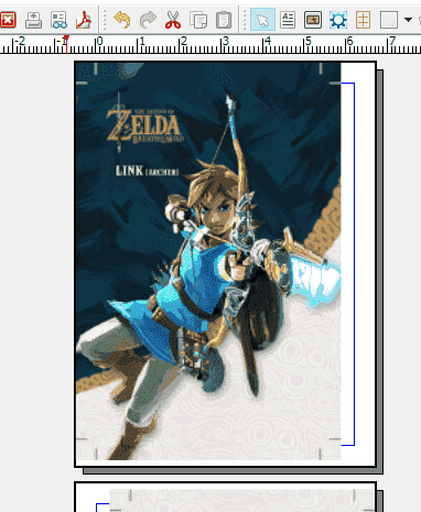

i'm trying to set a ready-to-print PDF with some of your cards, using your guide and your template.
I could install Scribus, open your template, but when i drag'n drop your card image onto the frame, the picture is aligned in a corner, and not centered as your exemple in the guide. Sometimes it's rotated as expected, sometime not (still in the expected frame). trying mutliple times, now they rotate like they should. I think it was a misuse of Scribus.
What am i doing wrong ?
Thank you !
EDIT : reading the chapters of you rguide, it seems normal that the picture is aligned in the top left corner, but it must not have the good size, or parameters.
And i don't know why the rotated frames don't rotate the picture.
Should i just download the picture from the main thread ?
EDIT2 : this is how it looks like :
EDIT 3 : shame on me, i wanted to print credit card size in the playing card template.
Sorry ^^
Now looking to set a PDF of credit card images...

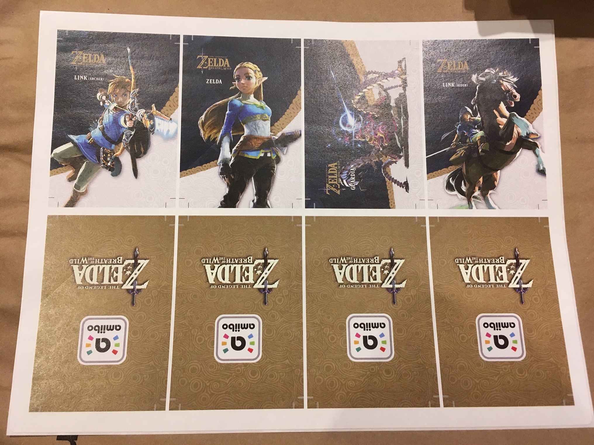

As for cutting out the cards....
Use this template:
https://gbatemp.net/attachments/random11-6-scribus-credit-card-template-zip.84725/
Follow this guide which explains how to use the template to create a PDF with all your images on it for printing:
https://gbatemp.net/attachments/how-to-use-scribus-for-printing-cards-pdf.83321/
Use this guide for cutting out and gluing the images together to make the cards: https://gbatemp.net/attachments/how-to-cut-out-amiibo-cards-pdf.83152/
This is an amendment of that guide:
I have found that Elmer's Rubber Cement works way better then the double sided tape. You just apply an even coat to both sides of the backing... wait about 30 seconds and squeeze the fold together. The plus side is any excess mess you make easily just rubs off.
As for the corner cutter. I used a "Sunstar Kadom Pro, Corner Cutter (S4765036)" which has a 3mm (radius) blade.

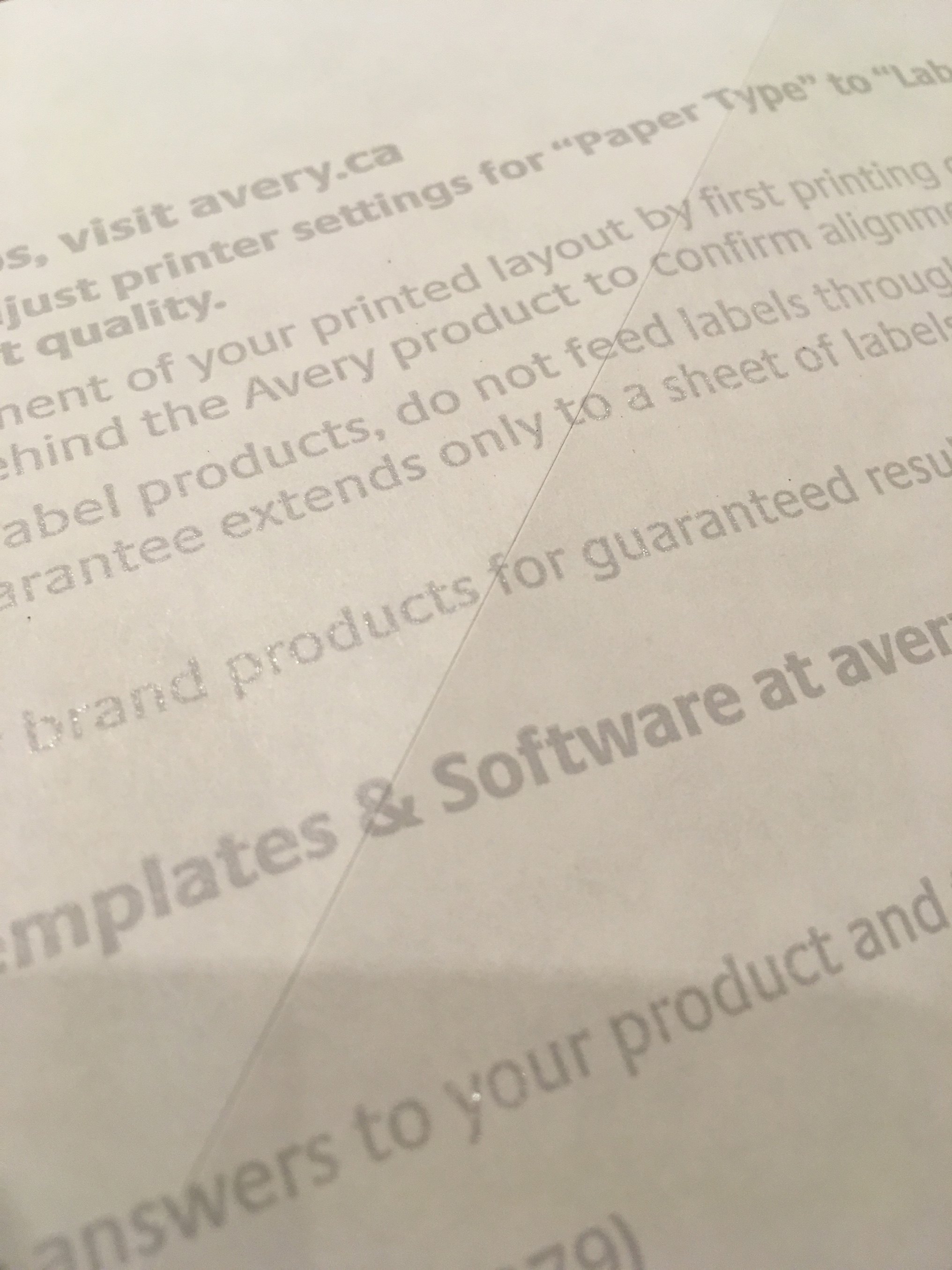

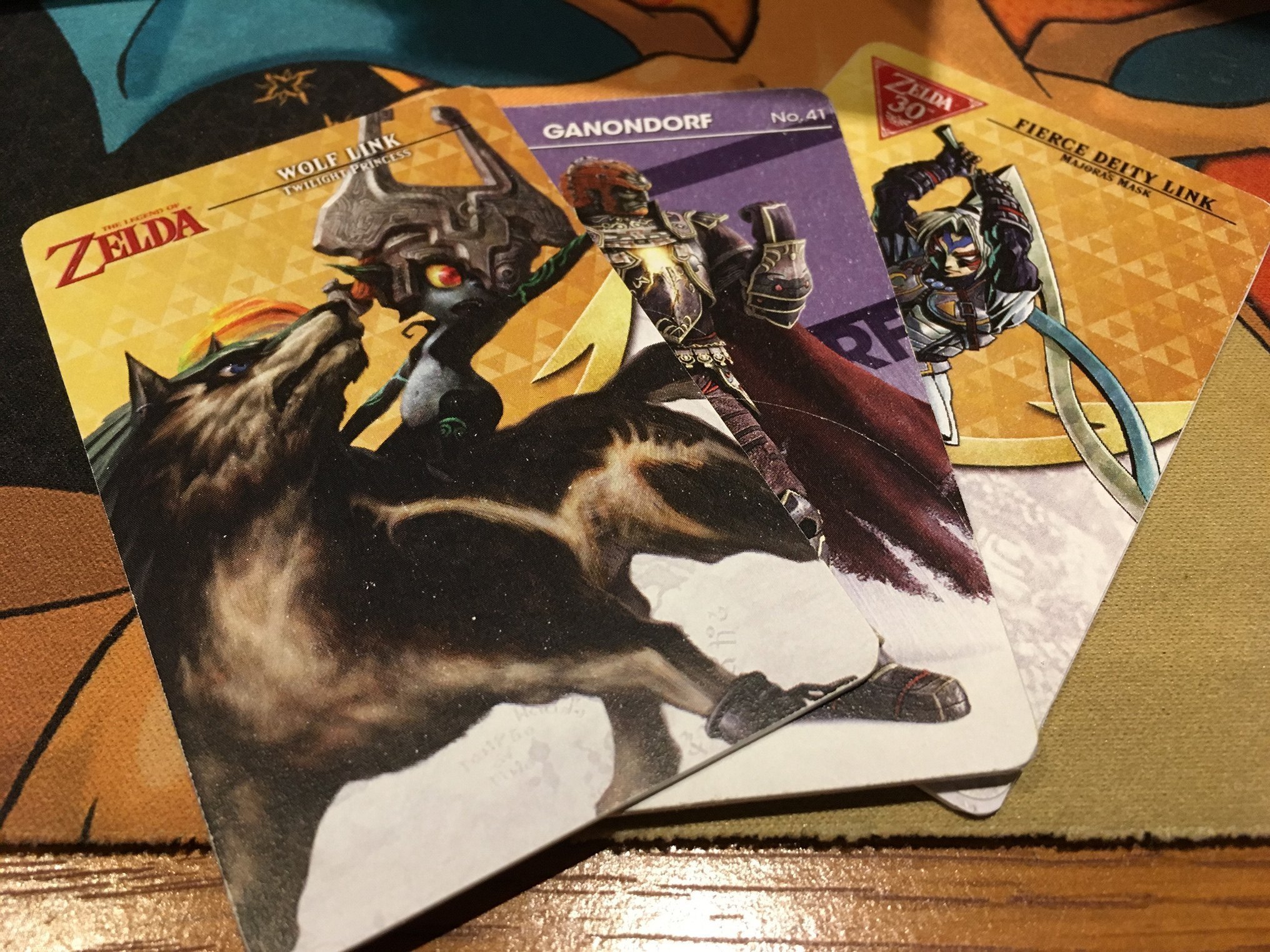

hi... see this post:
So here is what I've tried....
As per AnalogMan's suggestion I went and got Avery 5265 shipping labels. I printed them off on my works Sharp MX-3070N laser printer... it didnt do the best job :(
White speckles on some cards:
black spots on other cards:
Here is the results after applying the labels to the pvc cards
View attachment 84848 View attachment 84849
The Avery labels also had diagonal lines cut into the backing in order to make it easier to peel off. However the scoring is deep enough that it affects the label. You can sometimes see hints of the line through the image and if you happen to accidentally crease the card on that line it could put a mark on the print, so you have to be careful.
View attachment 84859 View attachment 84862
