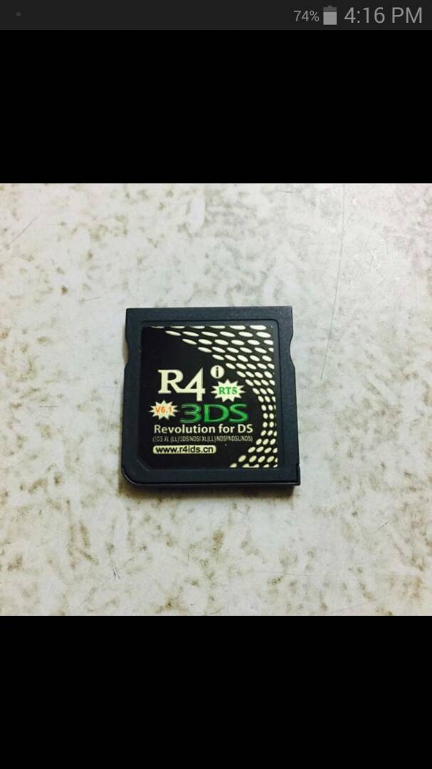

Hey guys I tried looked around for people who are selling these r4 cards since my one was a fake and found someone claiming that he has one r4i gold 3ds rts, is it legit ? I've noticed that there is a label that states the version of the card, but everything else seems pretty much the same.

no, if the magnet is in the correct spot the 3ds won't turn on unless you press the button combo, just practice on the normal home screen getting the magnet to trigger sleep mode consistently
