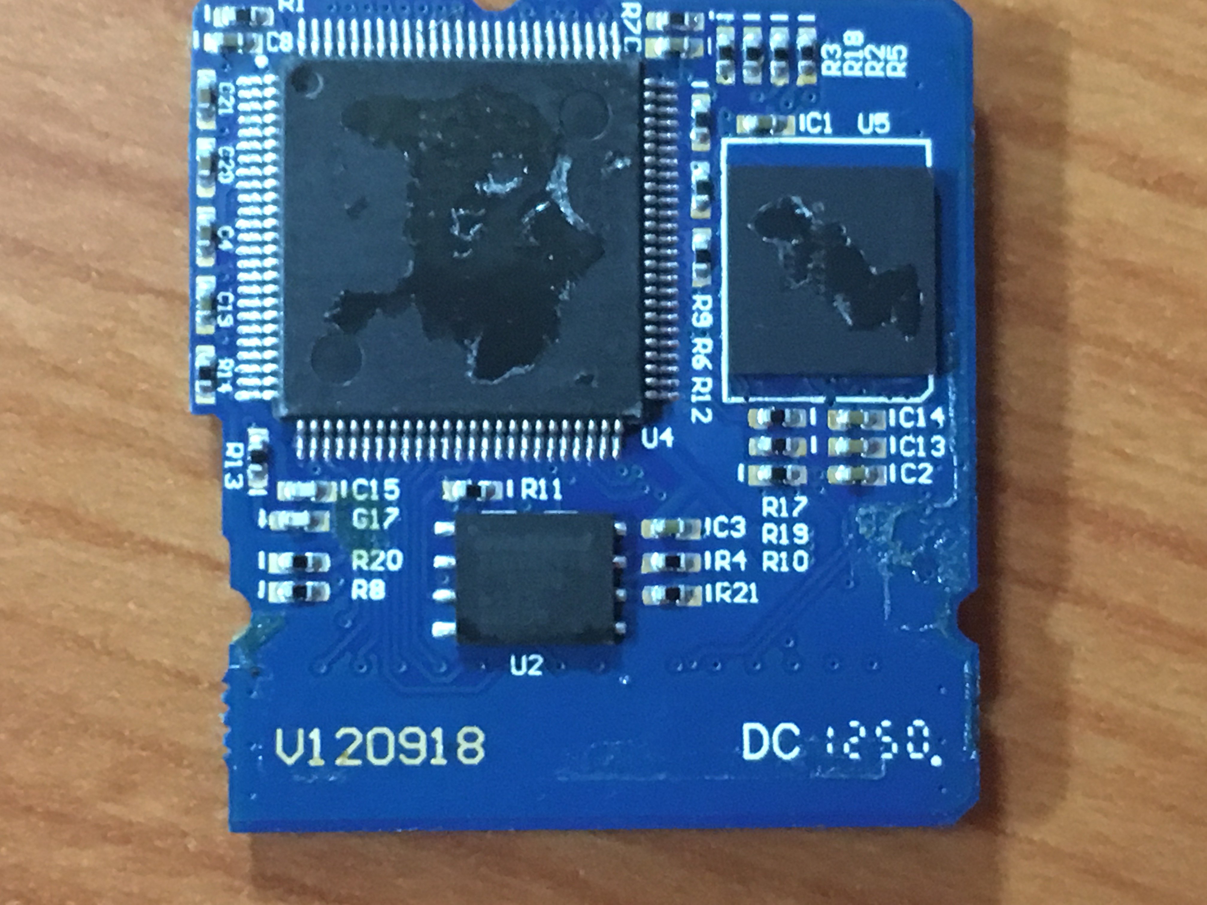

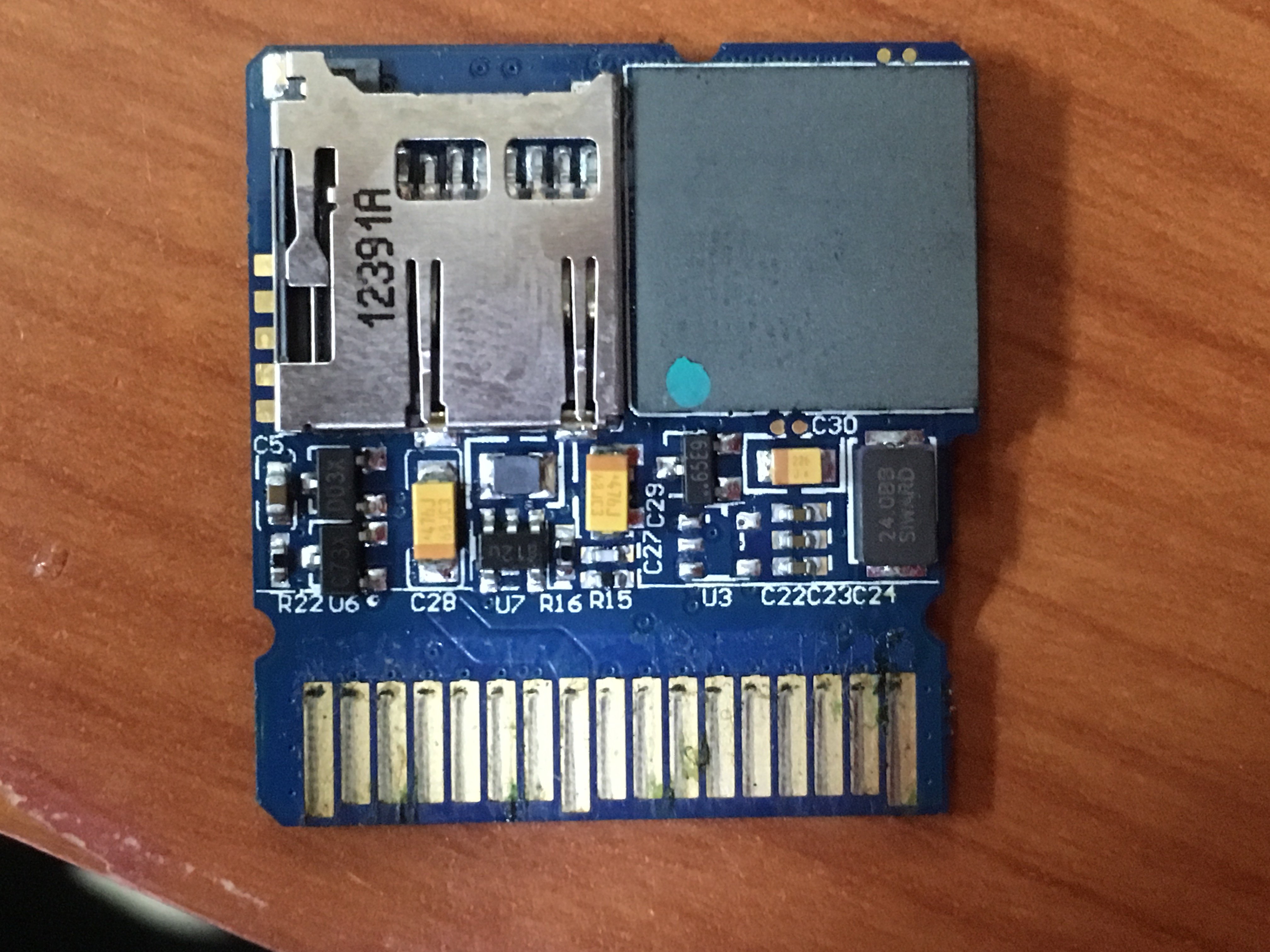

Check the back of the card above the far right pin for a number. I've got a rev 5 which can work (with some help).
Rev 6 isn't working yet. 7,4 unknown, 8+ should work with existing flasher.
by any chance do you still have the precompiled file ?
or will it implemented into newer version of ntrboot_flasher ?
I still have no idea what flashcard revision you have.
That's very important to know so I can help you.
I don't have it yet (I only own DSTWO), but I found someone selling V5 very cheap.
He did try flashing it normal ntrboothax and it didn't work.
