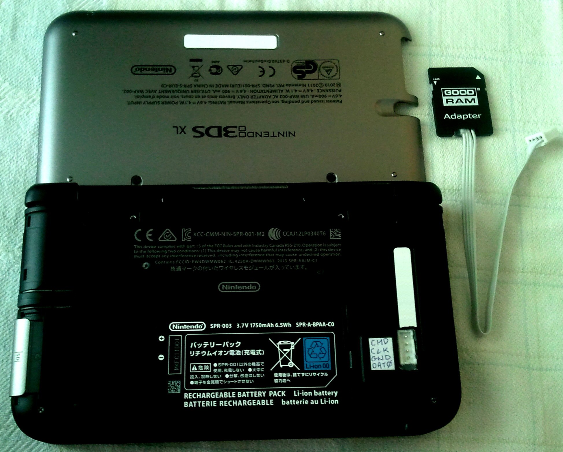

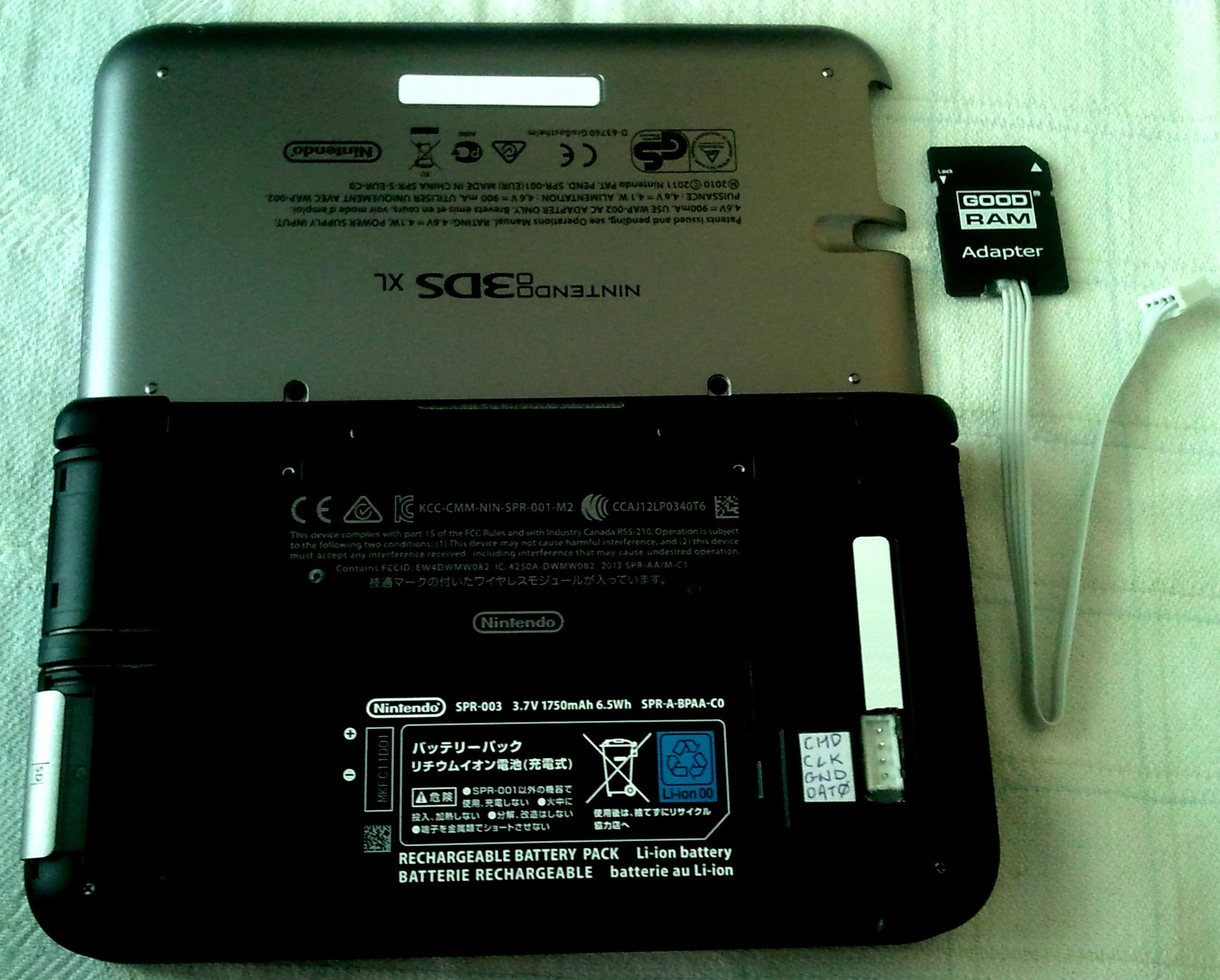

Just another nand dump mod.
I used the same connector as jinnpan :) but I cut it a bit for better fit and put some hot glue an the bottom to cover soldering.

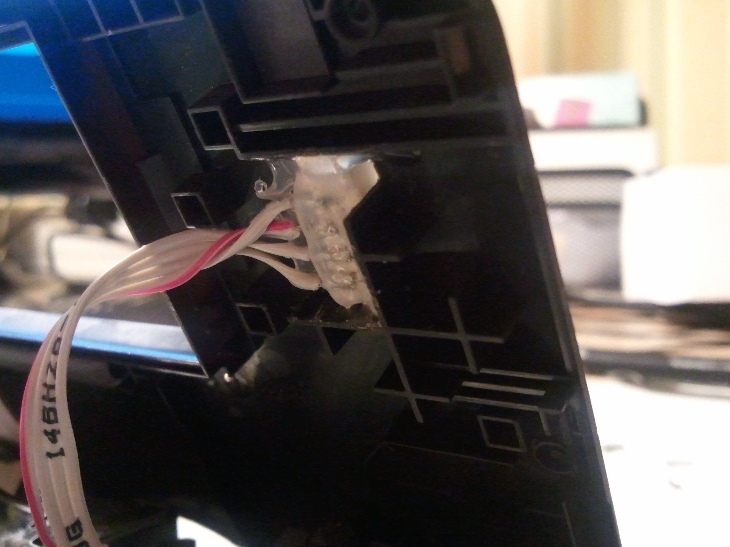

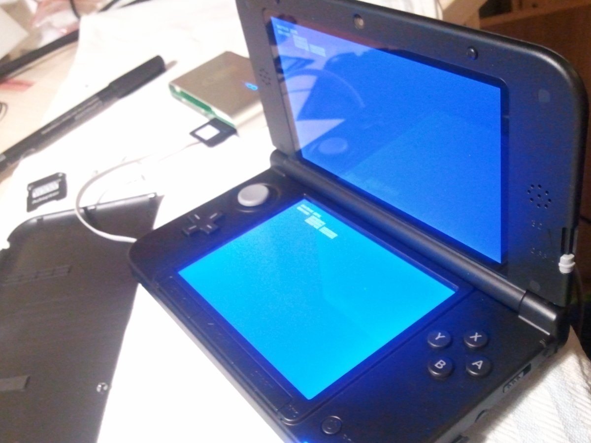

View attachment 6293 View attachment 6294 View attachment 6295 View attachment 6296 View attachment 6297
Q: Is it normal that MD5 are different on Admin and User account (Win7 x64) and with turned on/off Free COMODO Antivirus 6?
nice one.
but checksums should be the same no matter running tools or account
just keep in mind that the 3DS writes to the NAND on each boot, therefore the dumps differ after each boot.

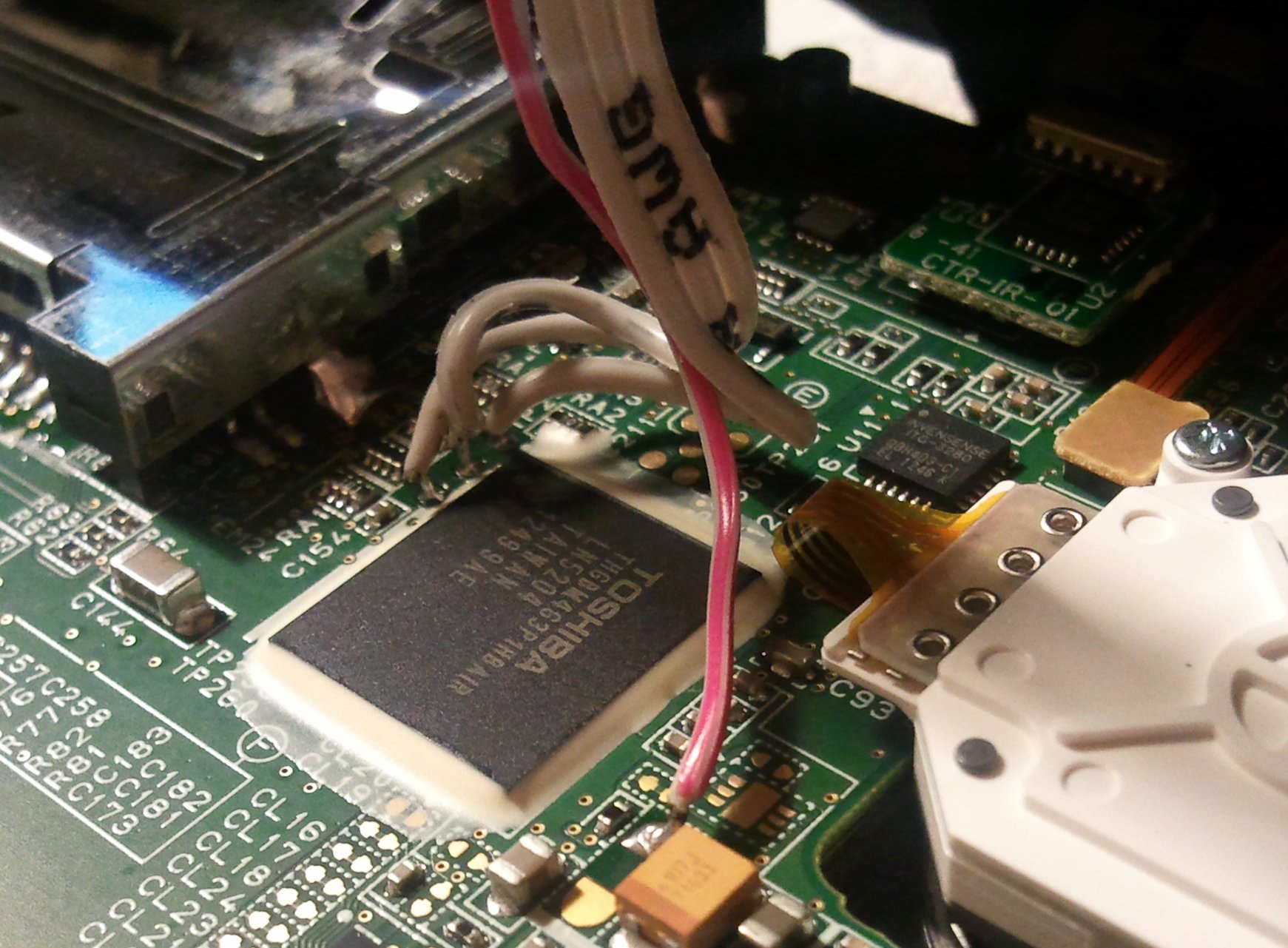

Could you explain waht kind of issues
(because i have some too : hw mod detected by sdcard reader, but conenction drops
hw mod isn't detected by rasp pi)
I PM'd you as well, but I will post here in hopes it might help others....
For me, it simply didn't allow my PC to recognize the 3DS. The only thing I can assume is that it wasn't grounding properly. When I switched to the on board GRND point it worked like a charm (I did have some other issues with card readers too, but that isn't necessarily relevant here).

I made today another mod and I used ground poing placed at the bottom of 3DS card slot. Connection drops on every SD card reader.
Previous mods uses soldering point on the right to the Toshiba chip so I returned to this method.
Did SB try USB 3.0 SD reader with this mod?

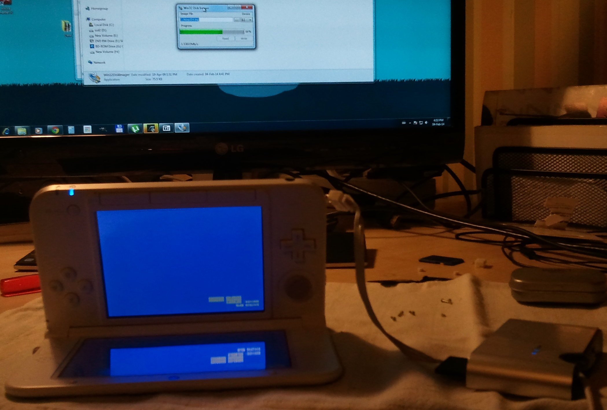

Well, it's good news for me today, just managed to unbrick my 3ds (major thanks to user bkifft for all the help! :) )
can post some screenies as well :)
