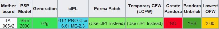

Ok I just ran the program and it comes back as t085 v2
https://playstationdev.wiki/pspdevwiki/index.php?title=Motherboards#TA-085_Series
