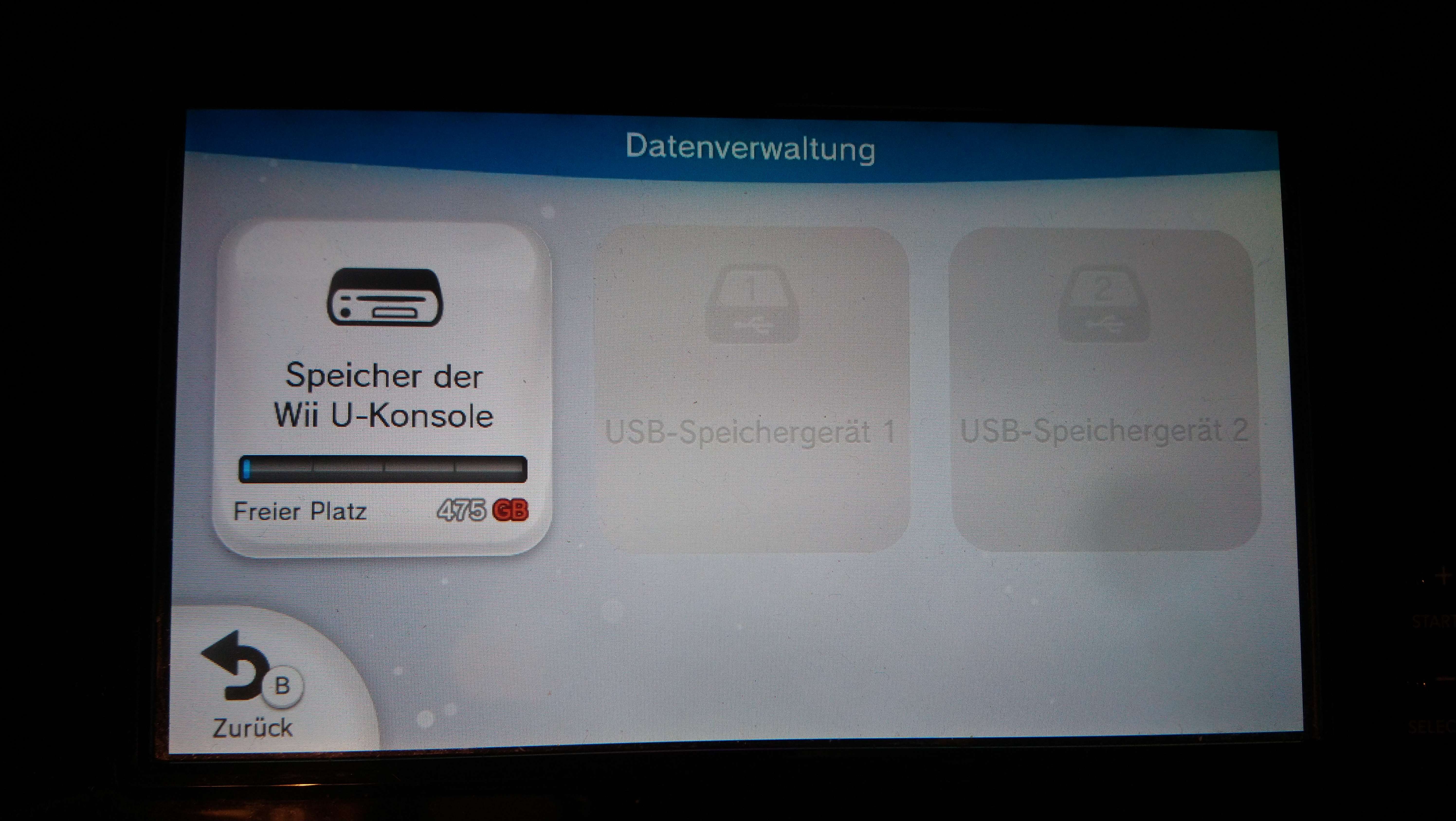

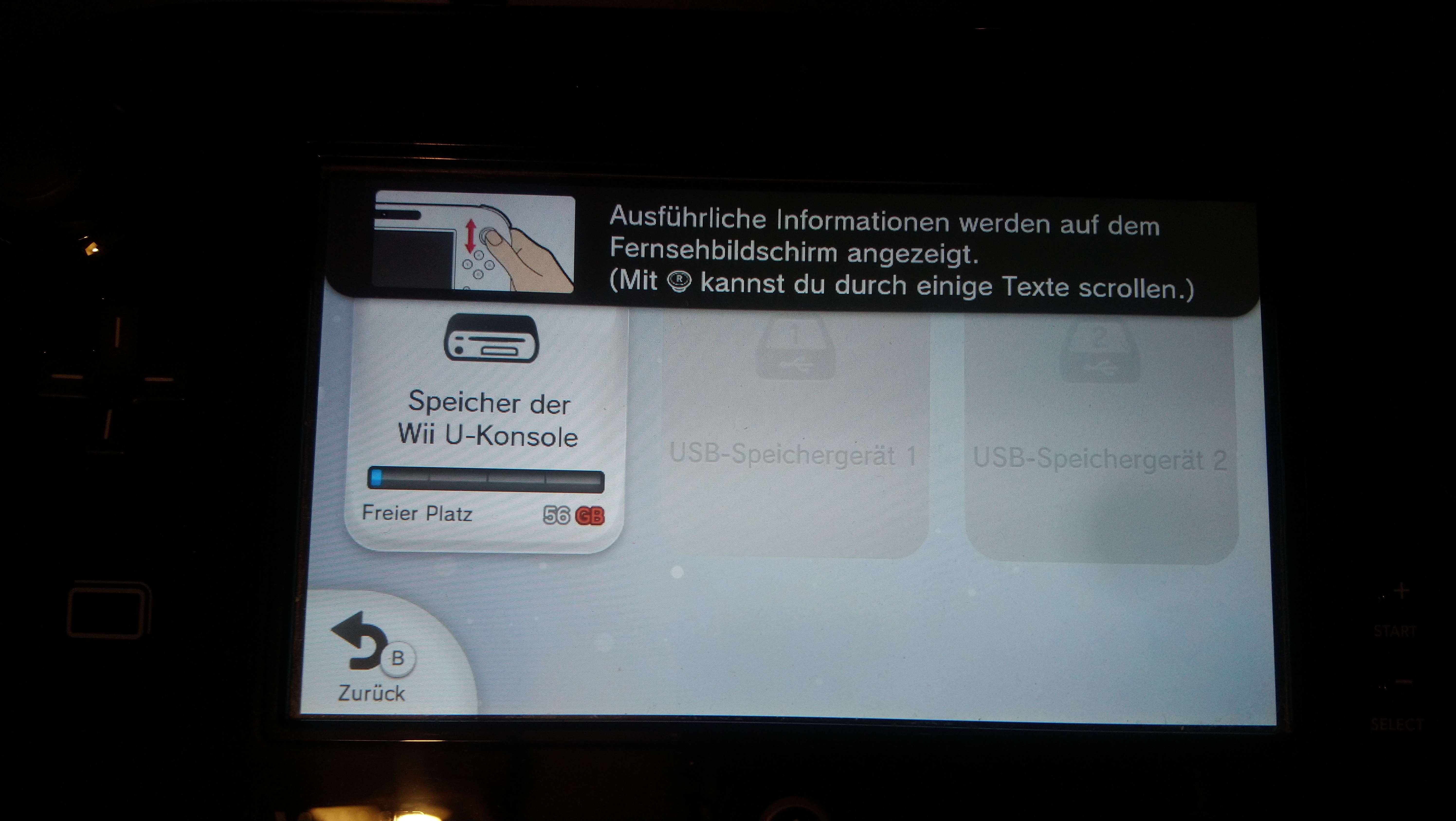

I think a ultimate Wii U would have at least the maximum internal storage supported by stock IOSU...
with defuse and the right patch it should even go higher :)
Ultimate would be 2TB, but I can't find a 2TB micro SD. Also the system is snappier without scfm, at least from my feeling

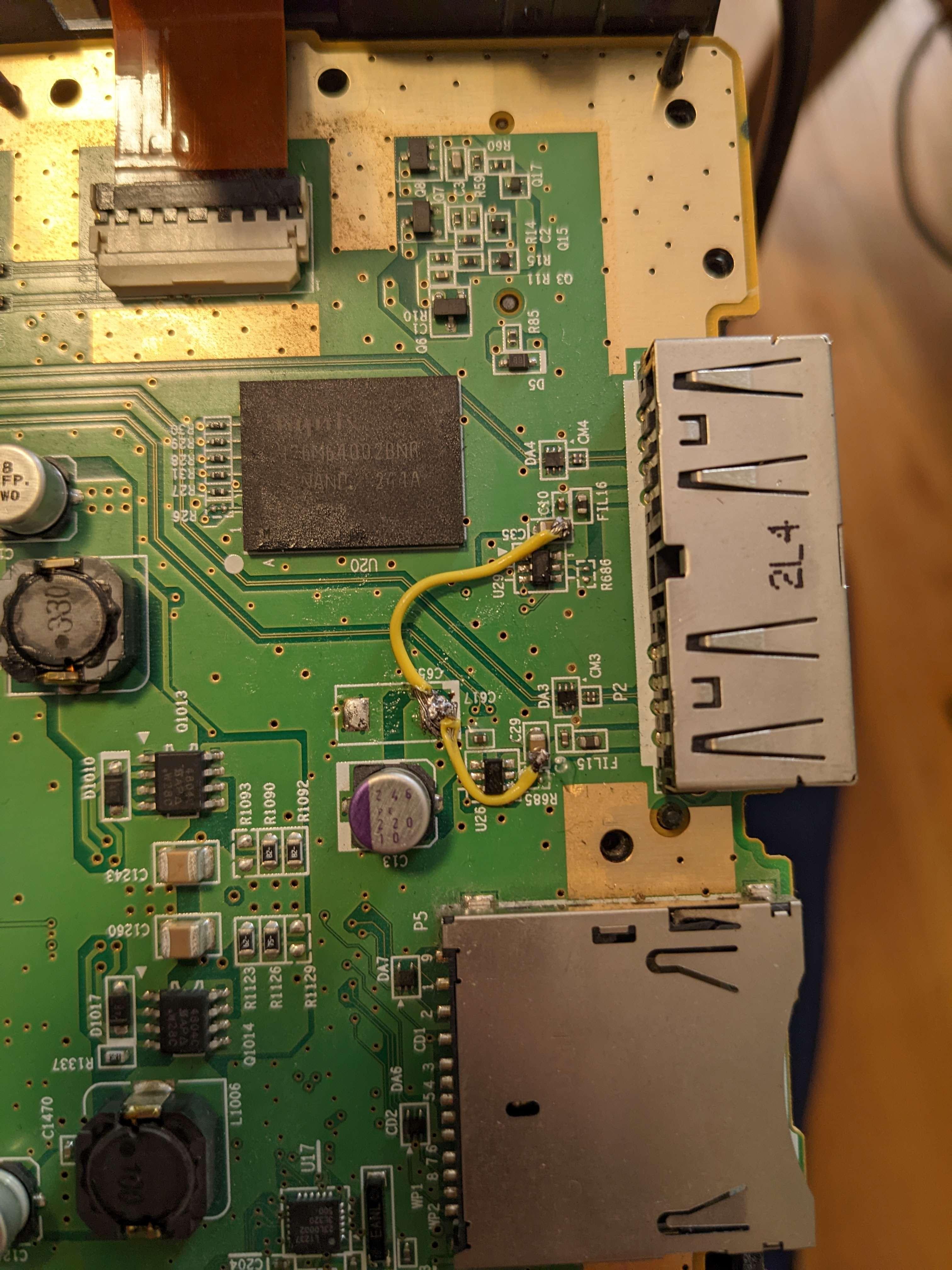

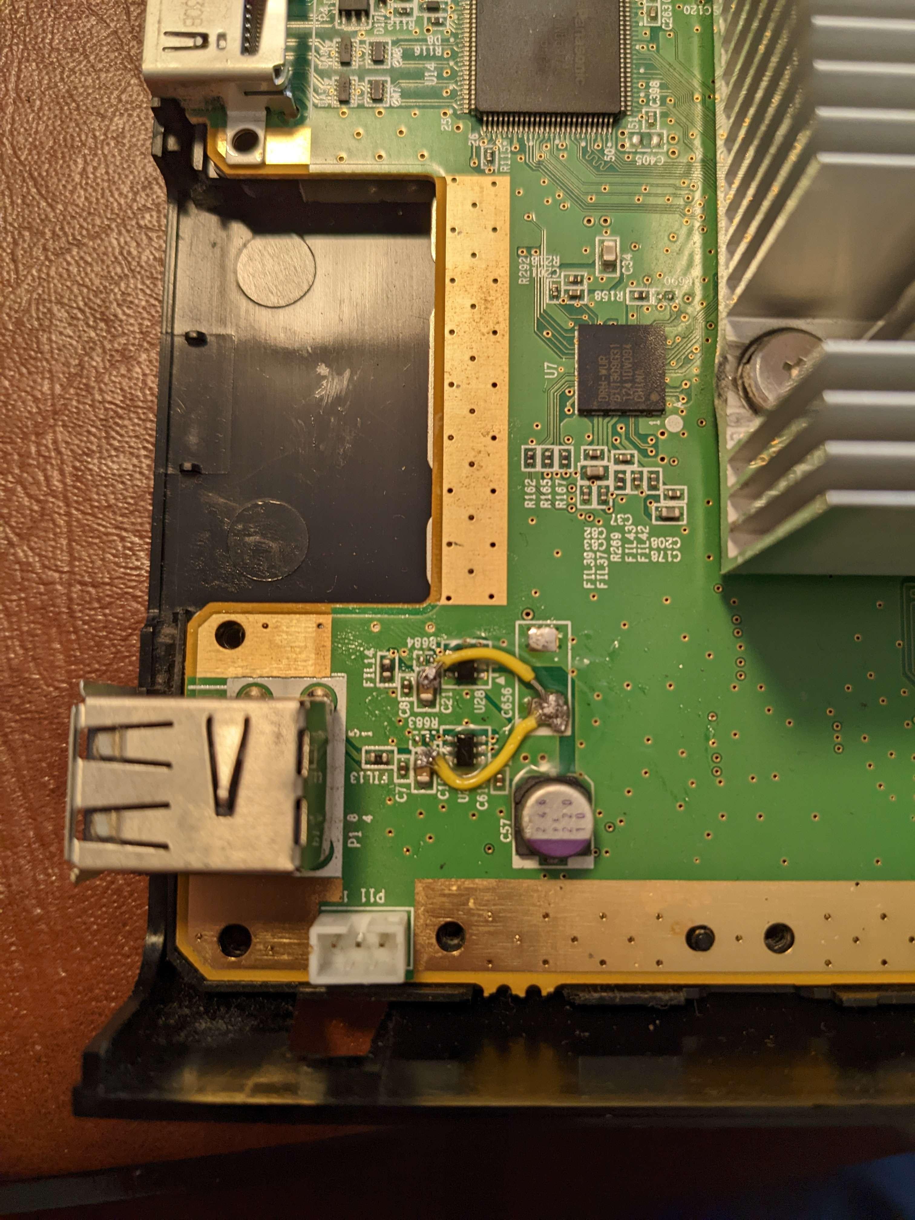

I would rather just bridge the Power of the two Ports together. So you still have the OCP, but have 1A on one port availible, which is more than the USB3.0 Standard wants, so it should be enough to run a HDD off of that.

Just connect the two ceramic caps together instead of connecting them to the big pad nearh the polymer cap
