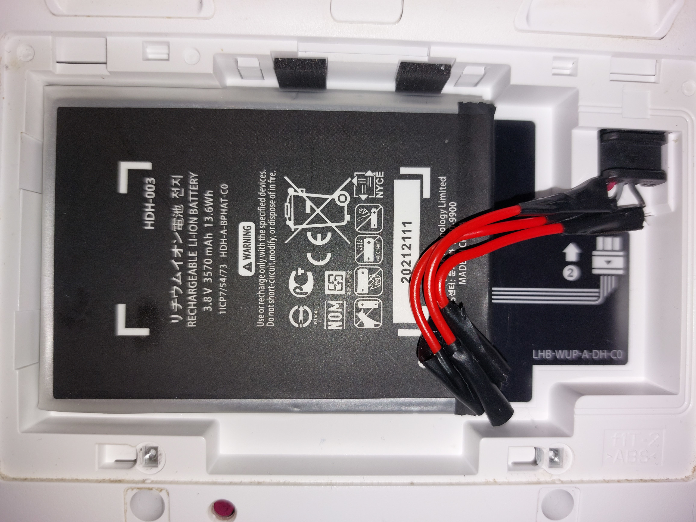

What is the best replacement battery?
If you got the money to spare you could get the official high-capacity battery (2500 mA) Nintendo sold back then.
Or you could be daring and do what I did...
Runtime at brightness level 3/5: About 6 hours
Runtime at brightness level 1/5: About 9 hours
Other levels: Didn't test

@EnterpriseFreak that's awesome. I just may wind up taking that route. There's some crazy 6500mah batteries out there. I'm not sure how well they work. Anyone try those?
Well, I tried a 2500 mA LiPo battery before I settled for the Switch Lite one. Let me tell you right away: Whatever battery you're putting into the GamePad needs to have a third wire (its connected to a thermistor (resistor that changes its resistance with rising / falling temperature)) or the GamePad will refuse to charge the battery as it thinks the battery is overheating. Be careful with "small" batteries that advertise a large capacity, they're most likely total crap.
Any other cool mods? I saw articles on better screens and better speakers. I don't think those worked out though. I would really love a better screen. Looking for a transparent housing too.
Can't say I ever heard of a speaker or screen mod for the Gamepad. Speakers are probably doable without much trouble as long as they fit in the original holes. As for the screen: Maybe, maybe, maybe there's an OLED or IPS screen that works available somewhere. If you want to upgrade the thing in terms of resolution I'd tell you to forget about it. The console sends a 480p h264 video stream to the pad and afaik there's nothing you could do to increase the res. or bitrate of it. Even if you could somehow the decoding hardware in the GamePad probably couldn't handle much more than what's being sent to it already anyway.
As for other mods you could do: You could add USB-C charging. I did that a while ago and it works just fine.
