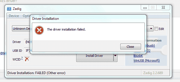

I cannot get past the driver installation step when trying to dump the Kernel (...?) so the program cannot detect the Mini NES. I follow the steps correctly, ensuring I hold down the RESET button when turning the Mini NES on.
I've attempted to install the driver via device manager but get a message indicating Windows found the driver but there was an error when trying to install...?
Has anyone else encountered this problem and found a way to install the Mini NES driver?

Tried using Zadig, but it failed to install the driver as well...? - However, thanks for the suggestion.
Any other ideas on how I can install the driver or what may be preventing me from doing so...?
a. Turn off all firewalls, anti-virus, etc
b. Try running the haxchi2 as administrator.
c. If above don't work run Zadig as administrator.
