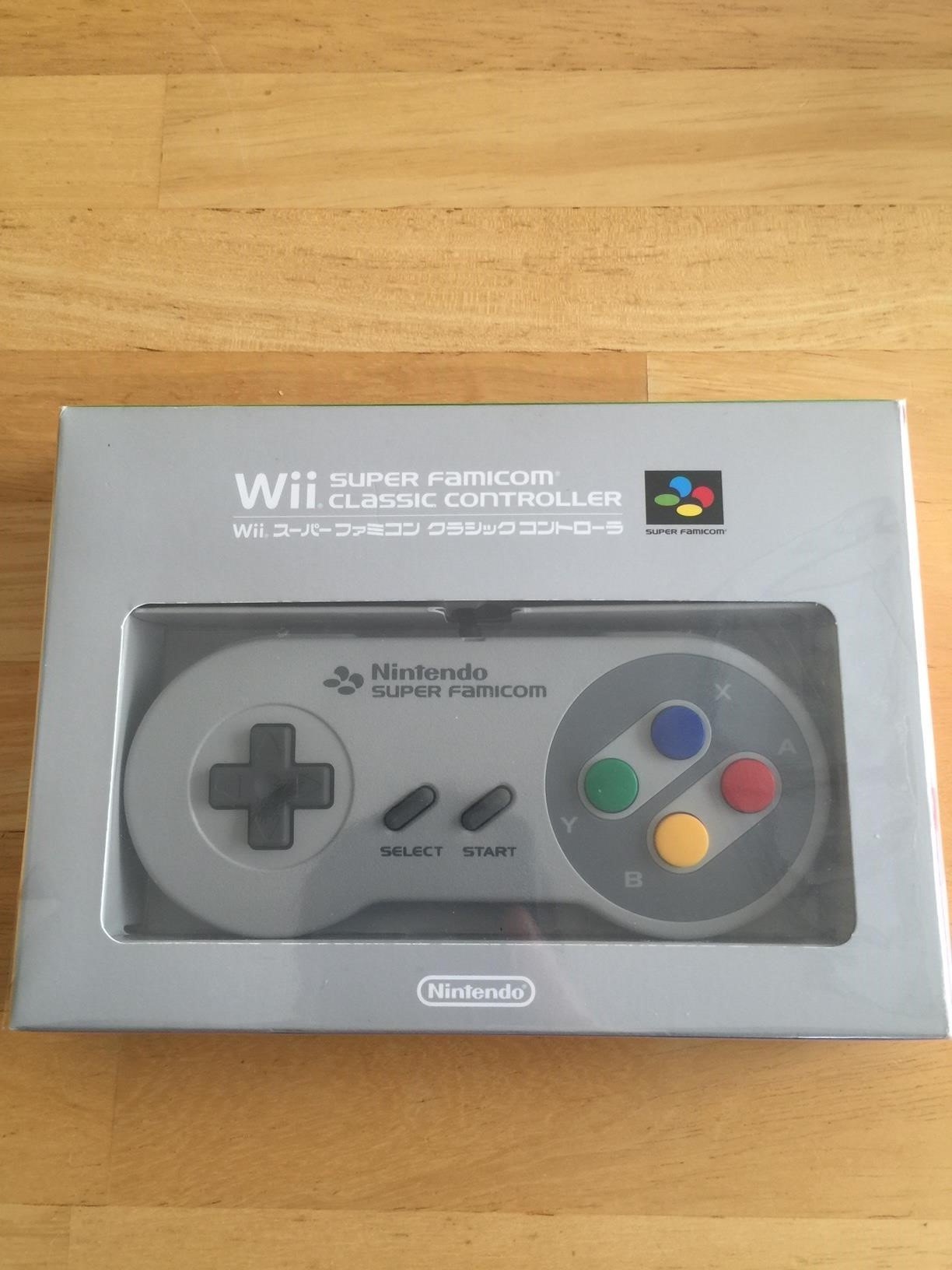

Ready for the weekend, this just came in.
Geez, it would cost too much to get that so I went with 2 8bitdo ones instead.
