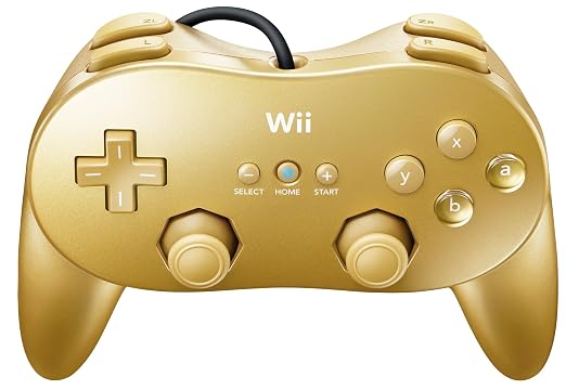

This controller works with SNES games with RetroArch?
I have the same controller and it works great in retroarch.
This has already been answered by @Pikkon but I just wanted to add something to that answer for anybody who is unsure about these controllers, even though I've not tried RetroArch yet.
The SNES Classic controller is no different to any other first party Nintendo Wii Classic controller so it will do exactly the same things. Whether it's the Official NES Classic, the Official SNES Classic, the Official Wii Classic or the Official Wii Classic Pro, they're all using the same controller inputs even though some of them have additional controls on top of the Official NES Classic which has the least buttons.
The A button is the same as on the other controllers, B is identical, START and SELECT are the same across all models. Just think of them all as Official Wii Classic Controllers but in a different case.
(Generation 3) Bear with me with the "Generation" thing here as I'm talking only about Classic Controllers. I also have a Gold Wii Classic Pro controller, it's the first party Classic controller that has the most "stuff" so we'll start with this one.
(Generation 3) You move things about a bit and you have the Wii Classic Controller, it's exactly the same controller but in a different shape. All the controls are exactly the same.
(Generation 2) You change the shape, remove the sticks and a couple of buttons and you have the Wii SNES Classic Controller. All the controls on this are identical to the controller above it and they do exactly the same things.
(Generation 1) Then you have the wonderful NES Classic Controller. which I assume we all have now? The shape changes again and you've lost another couple of buttons but the four buttons on this and the d-pad are doing exactly the same thing that they were in the controller at the top of this list.
It may be different with third party controllers but all of these are first party official Nintendo Classic Controllers.
They only compatibility issues there may be with these is if you're using a higher generation controller with a lower generation system. By that I mean that the sticks and additional buttons of a Generation 3 Classic Controller may not work with a Generation 1 (NES) system by default.
Obviously, with hakchi2 these things could be changed anyway.
I've gone on a bit there but I'm just trying to show people that that an Official Nintendo Classic Controller is an Official Nintendo Classic Controller and no more, irrelevant of the shape and an A button on one does exactly the same thing as an A button on all of the other controllers.
Does that make sense?
....it's OK, I'll be quiet now! :P
EDIT:
Should I be worried that I actually own all one the controllers I've posted above? :ohnoes:
