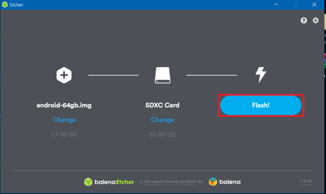

Download balenaEtcher from from the link given in the link above.
Click on the installable and follow the on-screen instructions and let the app finish installing. Once Etcher is done installing, launch it, click on the big blue 'Select Image" button and browse to where you have put your downloaded image file. Like the official XDA thread suggests, you might use an image file smaller than your card's size (ie using a 32GB image on a 64GB SD card) resulting in a larger free storage space capacity thereof. Likewise, extracting the image out of the archive is not a necessity as Etcher handles compressed .imgs just fine (so the XDA thread implies).
Once you've chosen your desired image file, Select the drive you wish to flash the image to (if it's not chosen by default) and then click Flash
Now, wait and be patient. It might take approximately from 30 minutes up to an hour and a half depending on your SD card's write spped, though it's not always subject to that, as many other factors may come into play that would result in a slowdown such as: overall state of the PC, if it's an old potato PC etc.
Regardless wait, and let Etcher do it's thing on the flashing/verifying part. Note that you should have backed up everything like i aforementioned because this process overwrites data, deleting anything in the process.

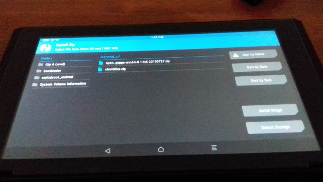

Just as i mentioned above, now there will be two partitions on your SD card. The FAT one and the RAW drive.
For a full android experience you shoud get the OpenGApps files that we will be flashing to our system. Select the ARM64 uner Platorm, the Android 8.1 version (as that's on what this android rom is based on) and under the variant select it to your liking, whether you want the full GApps package or just some of the apps.
While the switch can run without these, would you want a barebones minimal android experience?
On a side note, YouTube and Google Play store won't function without those.
Additionally download the shield-ifier.zip file. That makes it possible for your switch to be detected as a NVIDIA Shield, how awesome right?
Once everything downloads, copy them over to your SD's FAT partiton. Everything should be put like this:

Upon booting up the TWRP recovery menu, you'll be prompted to allow writing to the system partition or keeping it as a read-only.
Tick the Never show this again box and swipe to the right to unlock system write premission.
Once that gets taken care of, click on "Mount" then tick the following "System" and "SD Card". By doing so it ensures that our GApps and shield-fier zip packages get installed as they should. While still there also select the external storage as the install location.
Next click on the "Install" button. Browse to where you have placed your files and install the GApps first.
Once it's done installing, wipe cache/dalvik and then head back to the main menu and then install the additional shieldifier.zip file,then do the wipe cache/dalvik as per usual.
On a last note. If TWRP prompts you to install their app do so by swiping right. With that said though, sometimes that app causes the switch to hang on a blackscreen endlessly so better avoid it altogether

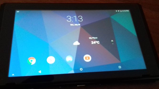

During the initial first time boot, it should take about 10 minutes or more as the android is being configured. Subsequental boots shouldn't take that long, so don't worry.
And well guys, that concludes everything. If you followed the steps above you should have android running on your switch by now.
After Etcher finishes with the flashing, youll see two new partitions on your SD card. If Windows prompts you to format any of them DO NOT do that.
