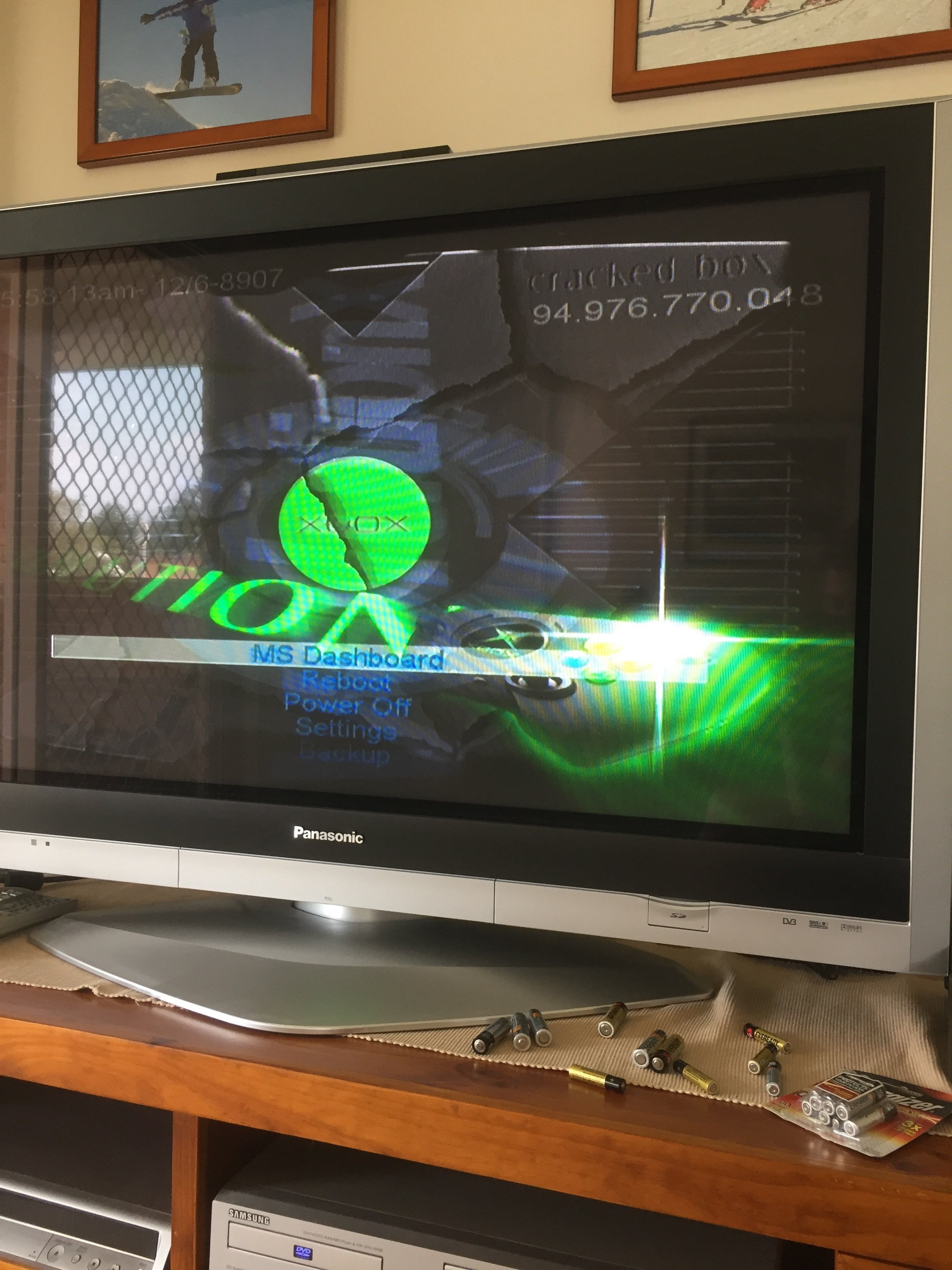

Hey guys, idk if you can help me at all but I recently booted up my old Xbox with xecuter2 and it doesn't come up with the regular menu, I'm not a tech person normally but was wondering if you could help me out, I'll upload a photo of the menu
It's EvoX and what do you want to do?
Basically I changed the background skin and then the console rebooted and changed the menu to this one, now I can't access my games or anything else, do you know what to do
Hey guys, just wanted to update you.. So I downloaded it onto a DVD and put it in the Xbox. Nothing happened. Now when I switch (with the switch on my Xbox) it to the modded format (Xbox Xecuter) it struggles to turn on and when it does the power button begins to flash red and green. Nothing on the screen either. When I switch it to regular Xbox format it seems to load up normally. I hope this didn't make it worse. All I wanted to do is have son play these old games and I hope it didn't make it worse or ruin the console... Thanks in advance for the replies.
Download Hexen again and burn it with IMGBURN. Burn it to DVD. Put in to console. Power off. Turn your Xecuter 2 on. Then power console on. The disk will then load and as said before, install a dashboard
