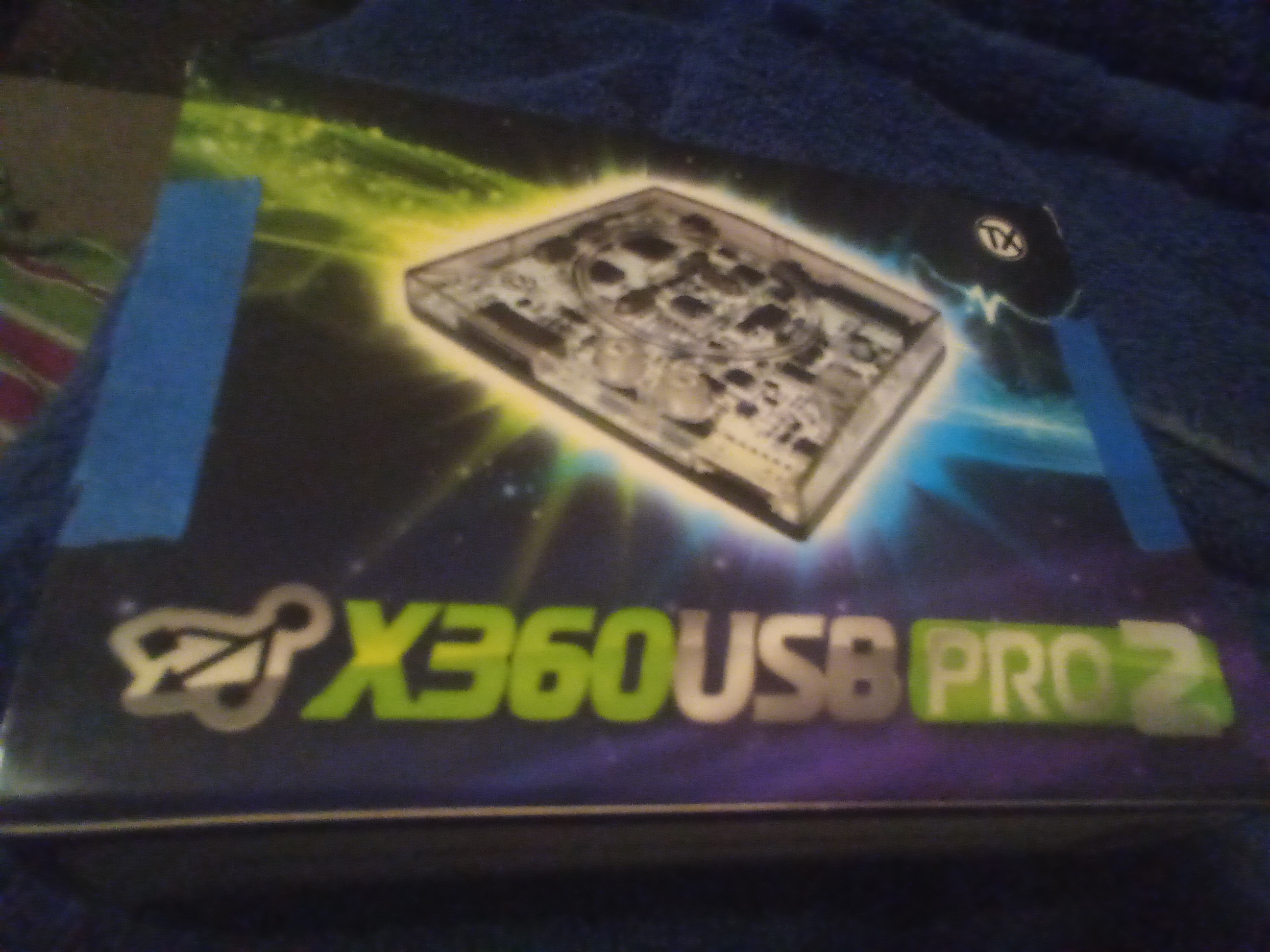

You can also just find/ buy a X360USB Pro, like this below. It will work through USB on any pc/ laptop.
If you go this route, flash the disk drive, you will also need a DVD burner and blank Dual-layer DVDs. (Recommend Verbatim)
I did buy that sata card but console mods wiki said it was incompatible with slim drives, but I haven't tested it yet.
